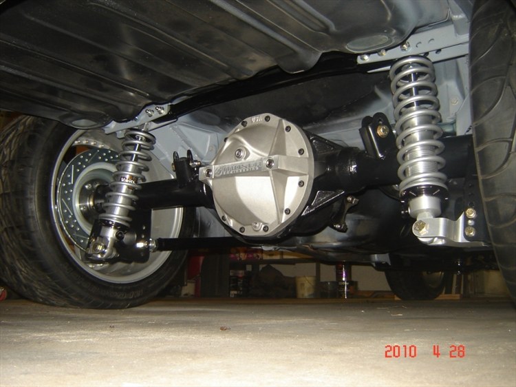

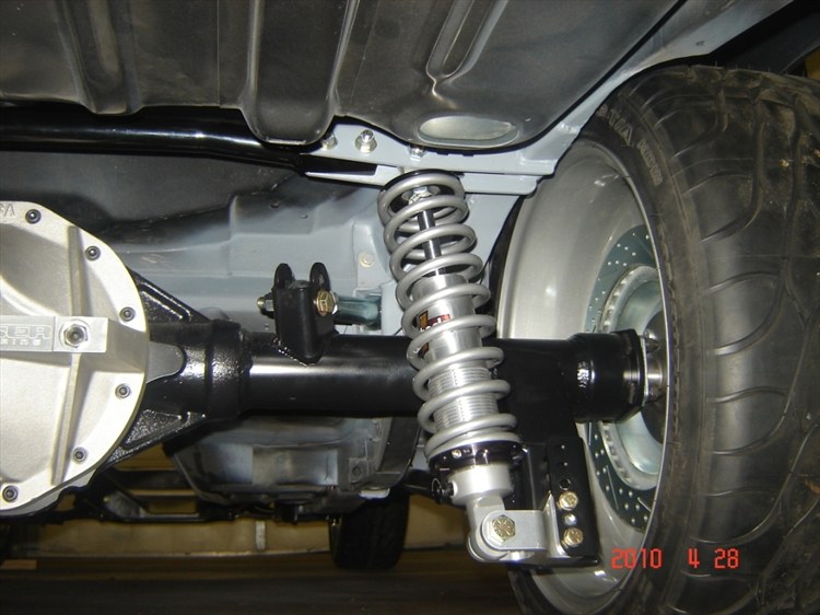

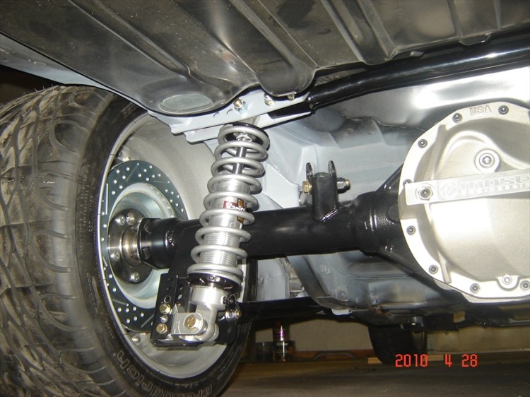

Two ways.
1. The lower control arm bracket has 6 holes in which you can move the lower shock mount to. I actually moved them to lowest setting this evening. Each hole is 5/8" apart. That made a HUGE difference.
2. I still have 1-1/2" of adjustment left in the springs. They're at full length right now. Plus, there's no weight in it right now. It's just a shell. Chassisworks recommends a shock length of 13"-14" in their installation instructions. I'm at 14-1/2" overall length right now.

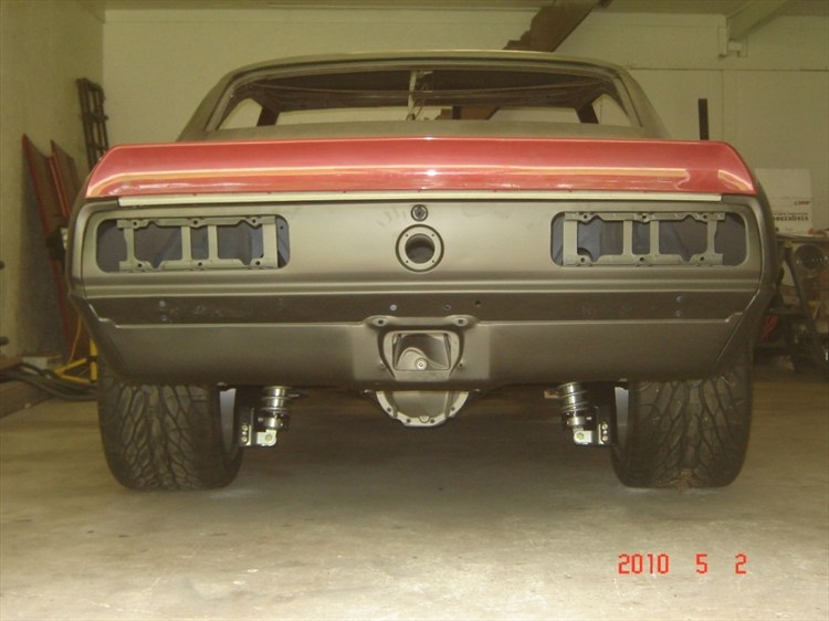

More pictures.

That looks sweet, are you planning to run tailpipes?
