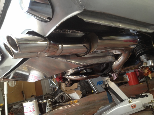

A little news. I think I have planned out my exhaust system modifications, in a preliminary way.
I am going to do a custom set of tubes off my headers, under the transmission brace, to a 3" xpipe.
I think with the power upgrade, I've got to go at least to a 3" from 2.5" on the muffler side.
The custom tubes under the brace are going to be a very oval(ed) set of pipes, because the car is so darn low
I am taking a metal art course starting next week, at night school. So after brushing up on my welding skills, I think I can make the pipes look like a work of art LOL
After the x pipe, I am going to probably install some smaller 3" resonators, before the main mufflers, maybe like a low restriction round race muffler.
From there it is all a question mark. If I go to a full 3 link track rear suspension, I am definitely going to need to be custom over the axle. The good part of that, is I can then incorporate a second switchable resonator, in the space left over from removing the leaf springs.
The other good thing about going to 3 link, is I can fit even larger rear tires, quite easily (I think) Probably a 335/35/17 or thereabouts with good clearance.

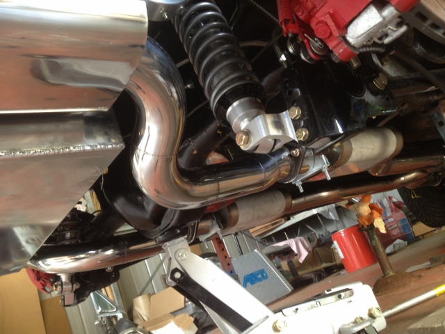

Okay so in conjunction with the exhaust changes, and the fact that I finished my welding night school class,
I am looking at rear suspension, now.
With the upgraded front suspension, lighter front end, the front of the car, badly out corners the rear, despite the big rear tires.
So the plan is to go with the 3 link that Shaun designed to go with his front suspension.
It will be a little tricky getting the exhaust over the suspension and out the back. I think I should be able to make it work.
Some pics of what the set up looks like, and I can get Shaun to match the shocks and springs on the front.
