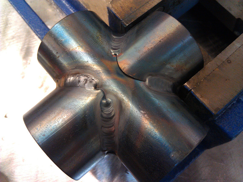

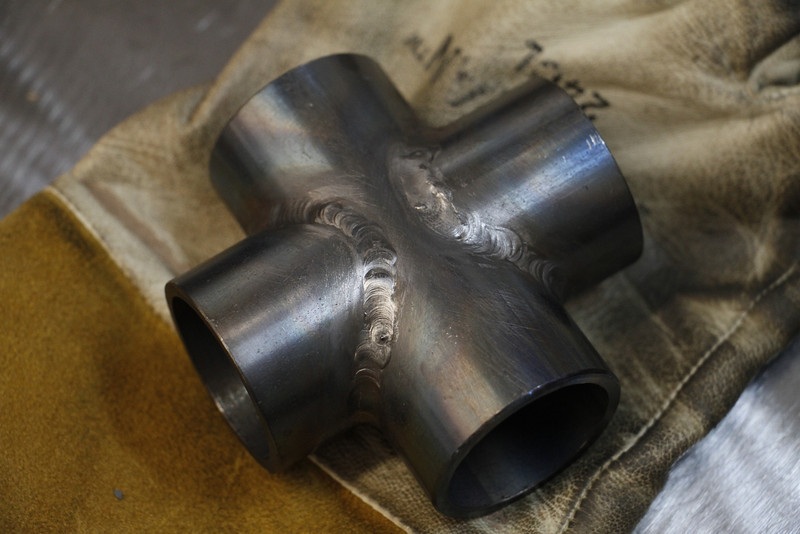

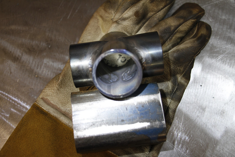

OK, yesterday and today's practice was 1.5" .120" wall round tubing.....real world stuff for a change.
Fitment and tack
Final weld sections
Completed piece
Interiors
I'm guessing the welds got hotter than ideal so embrittlement could be an issue. Please let me know what flaws you see in my techniques.

Ya got to pick up the pace and move the puddle more... It looks to me like you're really barely moving -- and that's what is adding heat like crazy.

Regarding speed.........I think I'm overly fixated on weld penetration. Tomorrow I'll repeat the process and try to double the pace/space between puddles. Appears I have opposite heat issues with TIG and MIG.

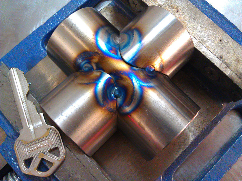

Getting mo bedder?
100 amps @ 13 cfh (Miller charts says 110-140 add 10% for mild steel)
