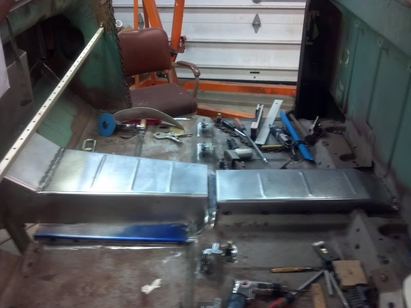

My Dad and I were just saying the other night, We are getting really good at cut pieces off or out of this truck. Now we get to finally put some back in. Since the truck now sits so low, the driveshaft will now interfere with the bottom of the cab. We started fabbing a new trans and drive shaft tunnel. We have some other plans for this are, so we will see where it takes us. I just have a few more puzzle pieces to make to finish closing off the tunnel and floor to the new firewall. It will then be time to mount the Vintage Air unit. I love progress. Anyway, I know pictures are better than words so enjoy!
Back to it tonight, wish me luck! Thanks for looking.
