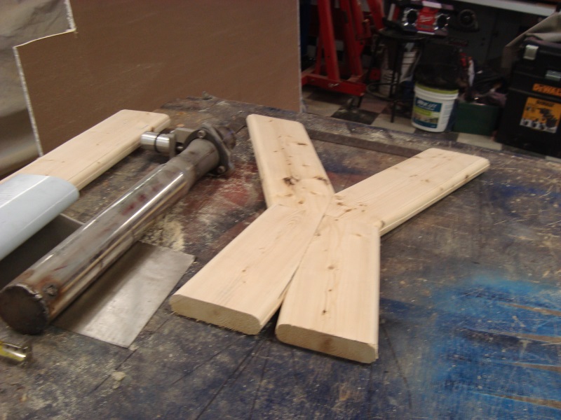

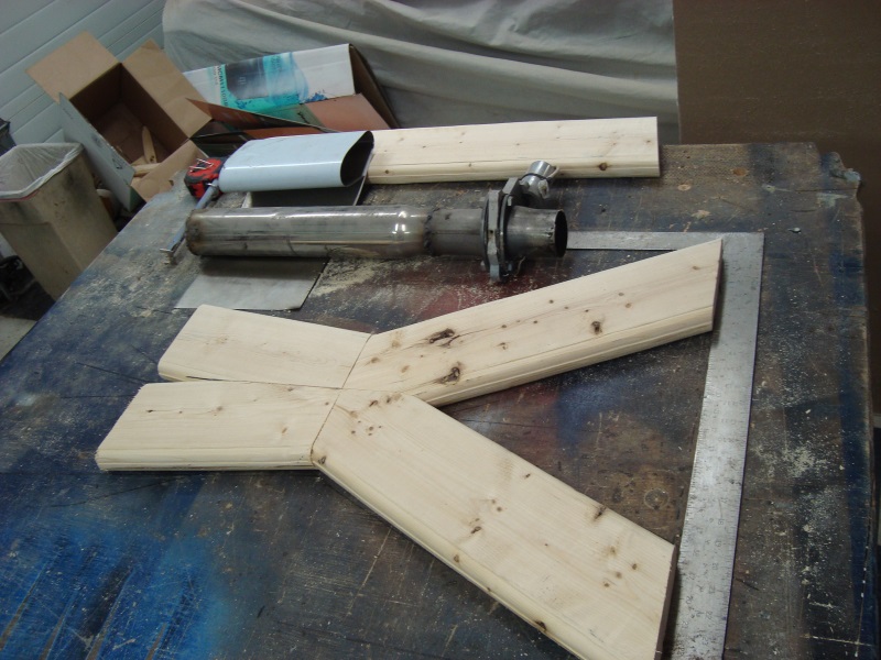

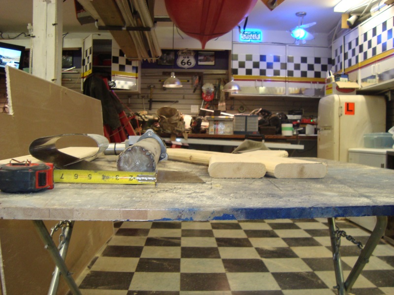

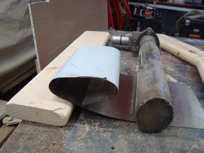

I've been hunting around for an exhaust system that will work for the super low chassis I have.
I need 3" pipes to start, with the larger cubic inch engine.
No luck finding anything off the shelf, that will work, so I decided to make one.
The critical area is the X pipe. It hits a lot on speed bumps etc, so the extra clearance is needed. I am going to make up my own custom oval pipe.
Not too sure how I am going to radius the corners yet.
I don't have a TIG either, so I will possibly have someone else TIG it for me, or get my own TIG
This is the start of the mock up. After that is complete I am going to get some more stainless, and bend away
Looks like this will gain me a bunch of ground clearance.
