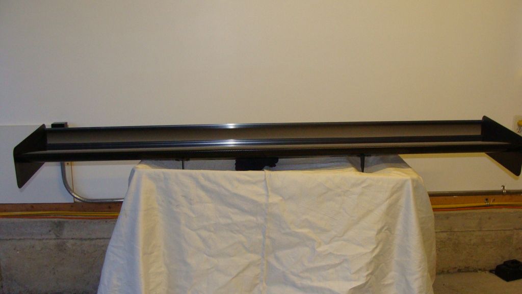

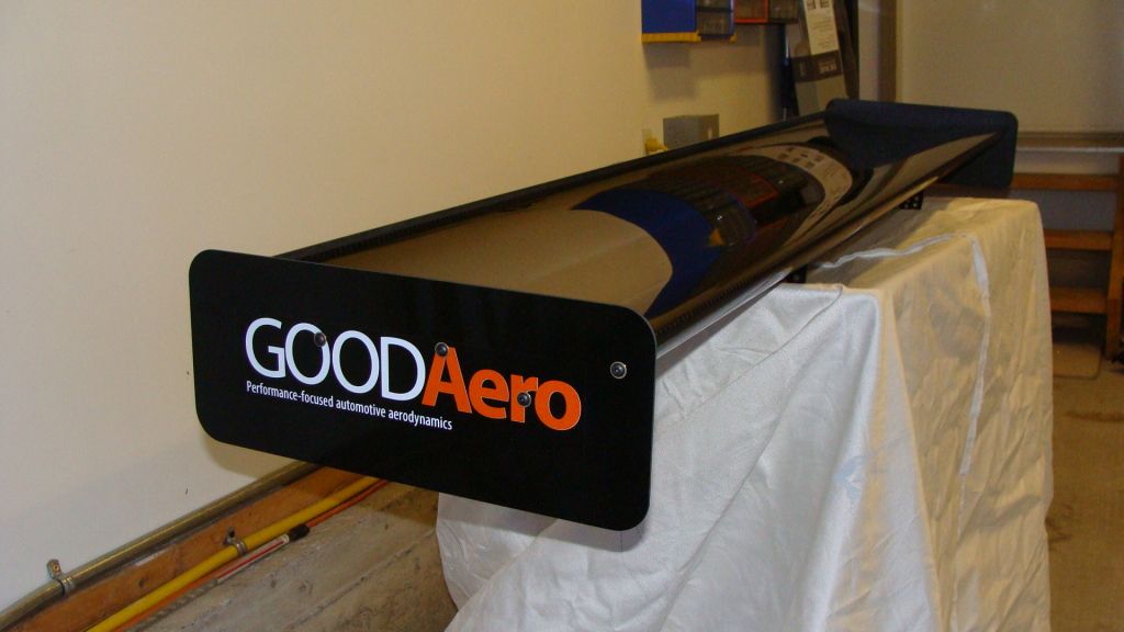

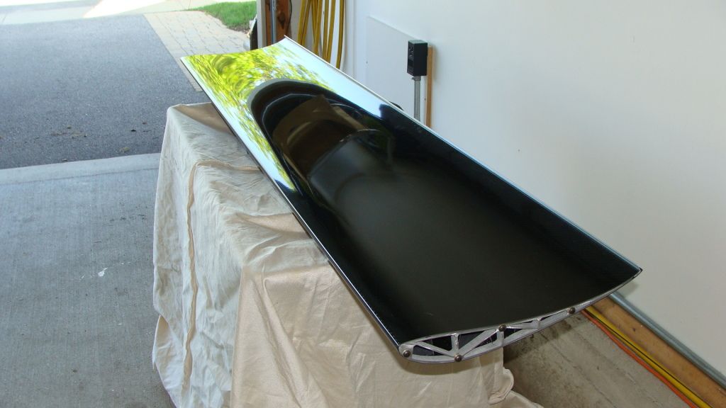

My latest big part to arrive and keep me bottoms down. Scott Good at GoodAero has been one of the best people to deal with answering all my crazy questions and getting back to me right away even when I told him I wasn't purchasing for a while. I think I've been in touch with him since last year.
This is my first real carbon fibre part. Its almost ubelievable that the whole thing only weighs a little over 5lbs and can handle all that pressure. Keeping the wing level (front and back highest points) it will generate about 6-700lbs down on the back end, and less than 50lbs of drag. More obviously if it gets angled down at the front.
