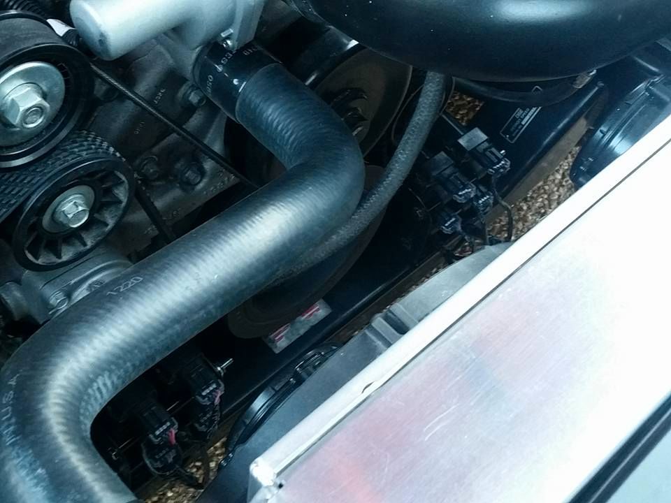

ride height almost perfect for my liking. Front end bounce alittle so eventually ill upgrade the front coil overs as well
After goodguys i decided to change this up.
Started by making coil pack boxes and placing the coil packs on the subframe. They are stacked two high. Wires are ran behind the headers and between the engine mounts and subframe.
Which lead to this look
After searching my ass off for some 19156430 valve covers that are discontinued i found a set at a dealership in houston. SO now I'm here. Trying to decide to leave it alone or paint the letters to color match my car. Thoughts?

Either way will look good. I love that picture in front of the garage. Do you remeber what that top radiator hose was from or a part number?
