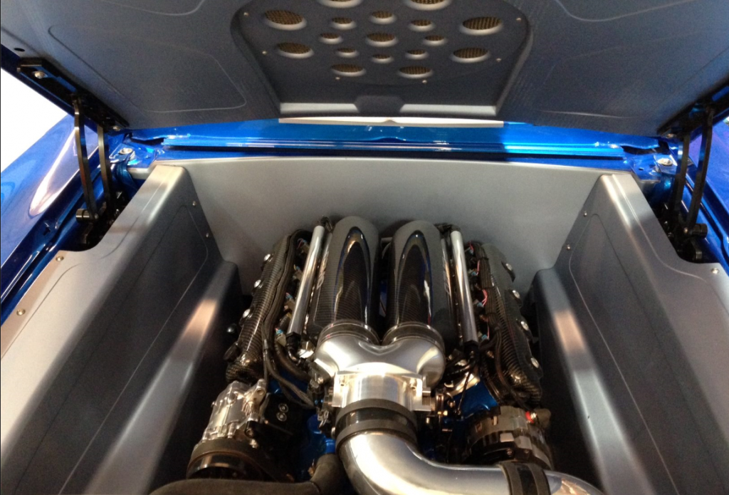

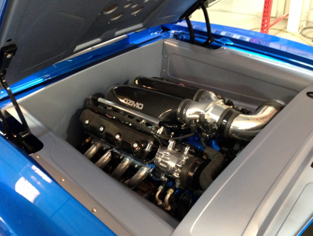

Robbie thanks for the props, we haven't dyno it yet but are hoping for 600 range on HP.

Al asked if I could respond to this question regarding the intake manifold: We designed this intake primarily for street guys who want good midrange torque, whilst still maintaining high flow for high HP.
Anytime you make a change to the heads or intake, a custom cam should be specified for maximum performance. That said, the runner length on this intake is only about 1" shorter than a stock GM LS7 manifold and will work well on a stock cam.

Where are the valve covers from please and how much ?

Thanks guys, i personally prefer oem looks on many LS parts but this manifold tops it all. After i have my car dialed up, this is next mod.

Here you go. http://store.katechengines.com/carbo...vers-p173.aspx

Very sweet! Hope mine looks half as nice!!! Share pics of the car as well.
