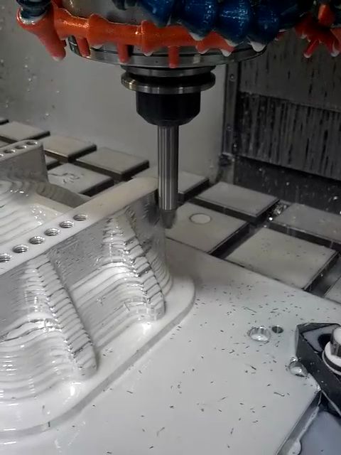

Since it seems a lot of guys think billet parts are pretty cool, I shot a short video of the beginning of the finish pass. You can get a sense of why it takes so long to surface parts like this. The rapid speed is turned down, so the non-cutting time is a bit faster when turned up. Note, this is a 1mm (0.039") 3D step-over finish. Should be around 4 hours to get it surfaced.
Hope to have some more pictures of the finish pass on the outside later today.

Boy am I learning alot..this has been a challenge, but oh so satifying
So the outside is profiled now and the bolt holes have been spot faced. I took it out, cleaned it, rubbed it, carried it around for a while...now have to open the bolt holes up to a clearance hole and add a fill plug port hole.
Here are some more pictures for anyone that cares, lol. Thanks for all the comments guys.
