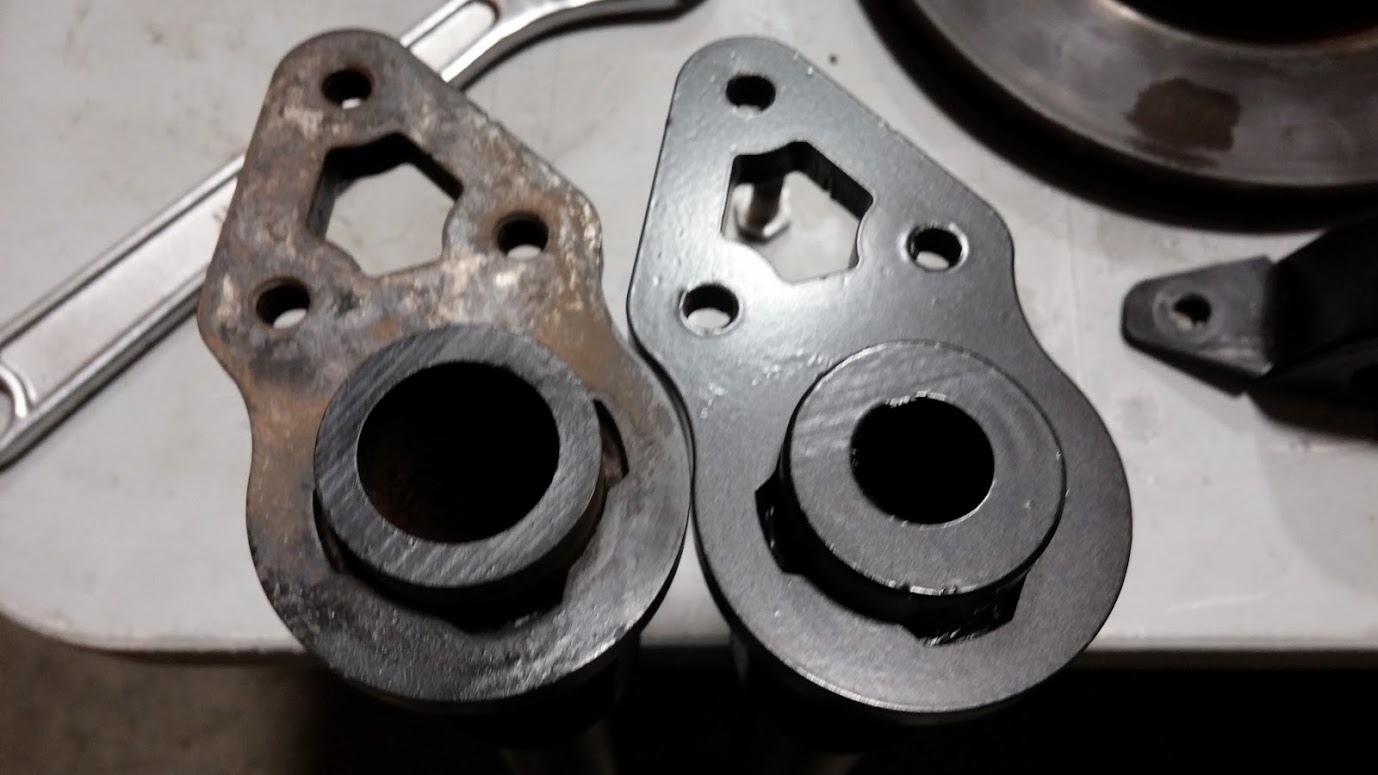

Pretty good day in the garage today. I started in the front and swapped out my 0.250" wall front sway bar for my 0.375" wall MonsterBar...
Install was pretty painless, the only fight I had was getting the 3 cap head bolts out of the swing arms. Ended up using a combination of heat, penetrant and patience. When I first put this bar in, these kept coming loose...so I put a dab of blue loctite on them to help keep them snug. Problem is the back side of the hole they go in is open and rust built up in there and made removal somewhat difficult. I put a liberal coat of antiseize on them before reinstall but I assume they'll start coming loose again after use. I'll just keep an eye on them for now while trying to come up with a better solution. No issues with the frame holes at all thankfully.

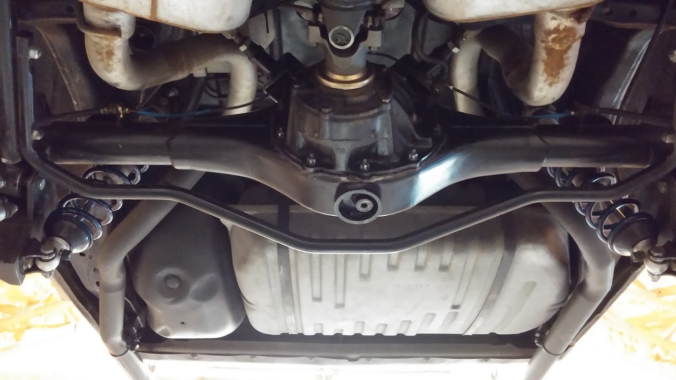

I had a rebuilt TracLoc installed into my third member and this fixed the backlash issue. Just a quick reinstall of the third member, then the axles..and lastly swap 250# springs in the rear for the 200# springs to match the rear roll resistance with the new stiffer front sway bar and the rear is just about tidied up as well.

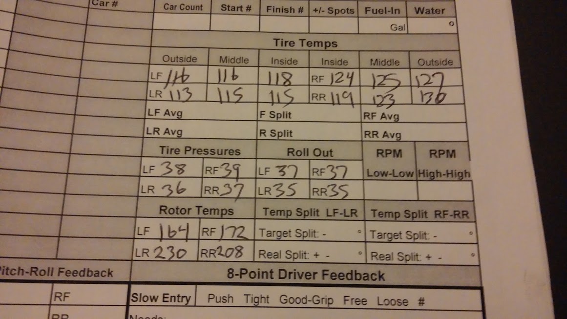

I started out with 37 psi in fronts, 35 psi in the rears. For a long time, I've been starting at 33 in the front, 32 in the rear. Not sure if it's in combination with the new front sway bar or not, but 37 in the fronts works a LOT better. 35 in the rear was too much, I started my 4th run at 37F, 32R and it worked great. This was my tire sheet after my 3rd run, I didn't check them after my 4th when I ran with 32 PSI in the rear.
