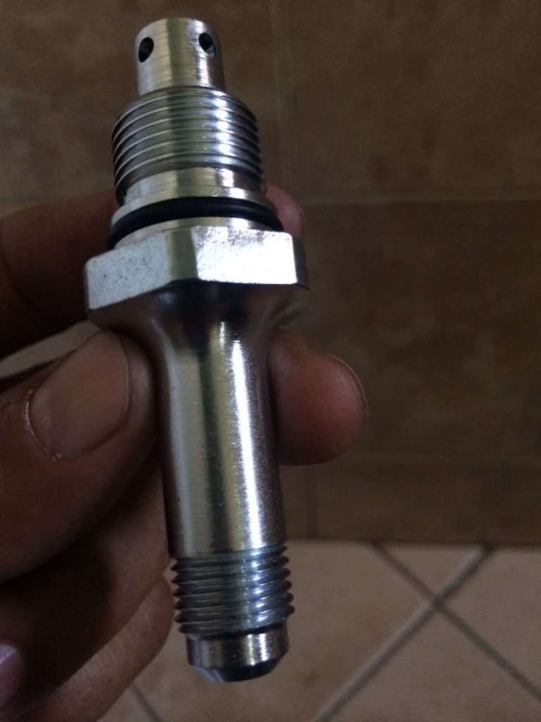

Originally Posted by Ron in SoCal View Post
Thanks for the suggestions gentlemen. Here's my plan - first I'll verify that Wegner sent me the correct flow rate pump for my DSE rack. I have a GM pump on the shelf (go figure) that is supposed to be matched to the rack so I can swap it out to test. I'll also remount my cooler lower. I've heard others with the same problems with this rack and I'd rather not put a three foot hose in the engine compartment (great suggestion though Rodger). If there's any lingering issues or notchy-ness I'm replacing the rack and getting a matching pump. I've also got a valve for the pump that'll match the AGR so one way or another this will get fixed.
Appreciate the input for sure
remove and replace until you fix it. I'm wondering if you need more volume moving through there, maybe you need a restrictor valve with bigger opening

Thanked 23 Times in 18 Posts
Too much flow will mess up the spool valve and/or make the steering too light. Bypassing too much fluid with the restirctor will cause the fluid to over heat as well as aerate. Making the power assist sporatic at best.
I had my pump rebuilt by ARG to match the flow of my rack. They also fluted the vanes so they would not foam up the fluid.
They changed the torsion bar size in the pinion valve to improve the feel.
Here is a link, go the the middle of the page
http://www.agrperformance.com/Hot-Ro...erformance.htm
All of this may have been done to your stuff, but this is what I had to do the the yellow car when it was first completed many moons ago.
