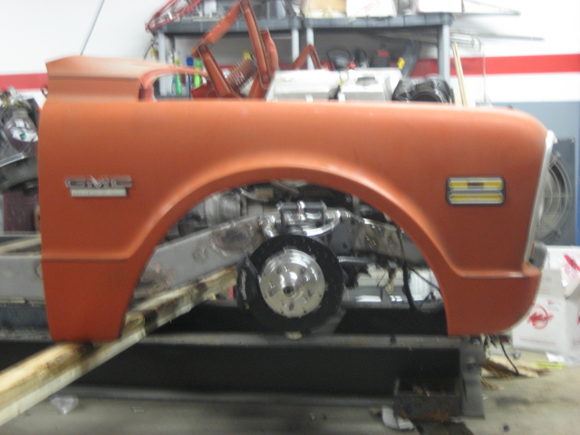

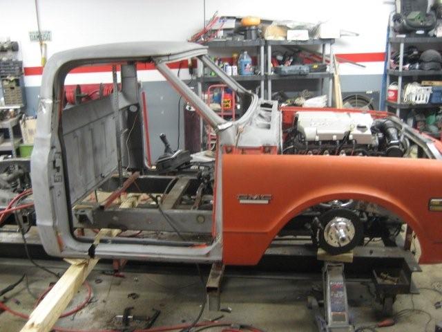

Smile rs/c10 metal work starting
finally getting some time to do some of the fun stuff, the windsheild is laid back 3in,the over all height came down 2in and the door opening is 1 3/4 in longer. the body is dropped 1 3/4 inch. its starting to look pretty cool. bill
