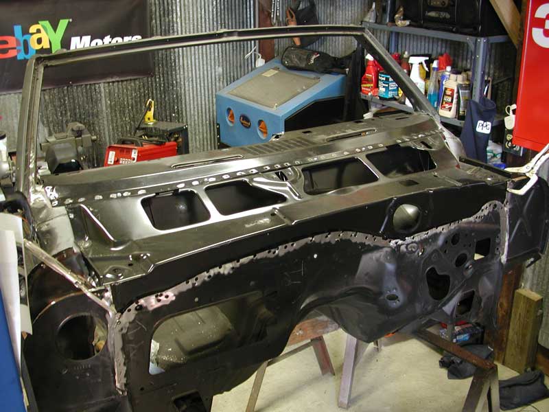

Up front, we’ve removed the dash panel, the upper cowl, the lower cowl, and the sides of the cowl panel and replaced them with new steel. We’re close to welding the new pieces together. Notice that the whole upper structure is detached from the firewall. Once the dash and cowl pieces are solidified, we’ll transfer them to the new body structure on the frame fixture.

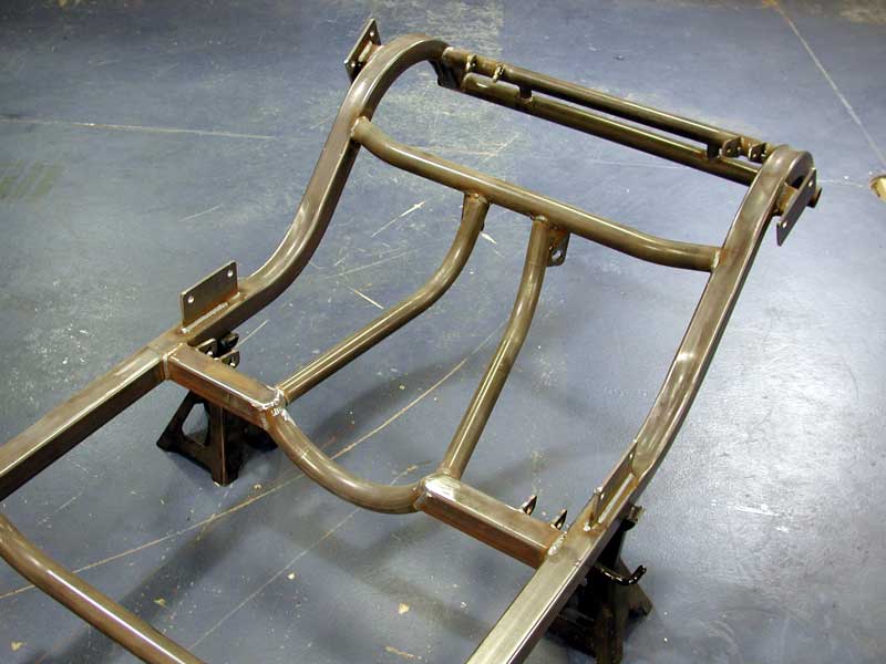

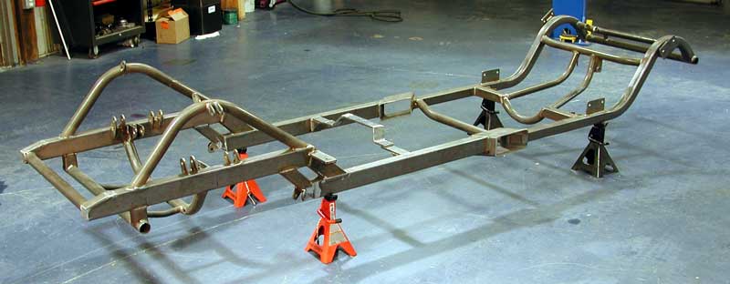

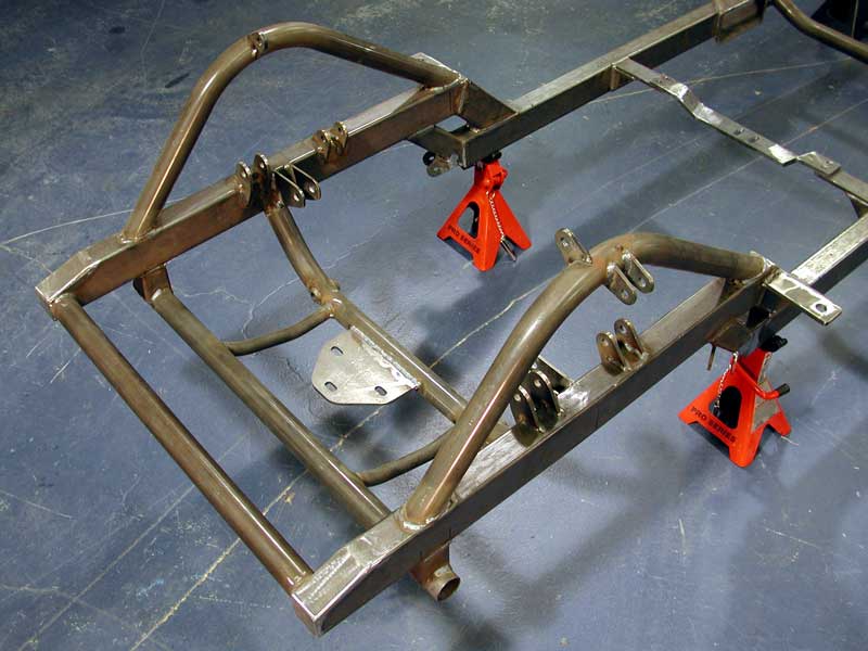

Meanwhile, the chassis for the Royal Sport comes together at Schwartz Extreme Performance. The Schwartz Precision Chassis is a true bolt-in road-race style chassis made specifically for a variety of vehicles, and this is first-gen F-body chassis #1. The whole chassis is designed to attach to the Camaro’s underbody in place of the subframe in front, and between the factory rear rails in the back. The two arches are the front. It utilizes off-the-shelf road race suspension parts, and we’ll be assembling the whole shebang soon. Parts include tubular arms from Coleman Engineering, a NASCAR spec Ford 9” from Speedway Engineering, BAER brakes, Bilstein coil-overs, and rack and pinion steering. We’re setting it up for a GEN-III small block and a 5-speed manual tranny.
You can follow the build on the Royal Sport Camaro on our show V8TV airing on The Men’s Channel. We’ve got a long way to go, but at least we’re finally putting things back together!

By the way, the tranny crossmember is upside down in the chassis pics above... it just got set on there that way.
