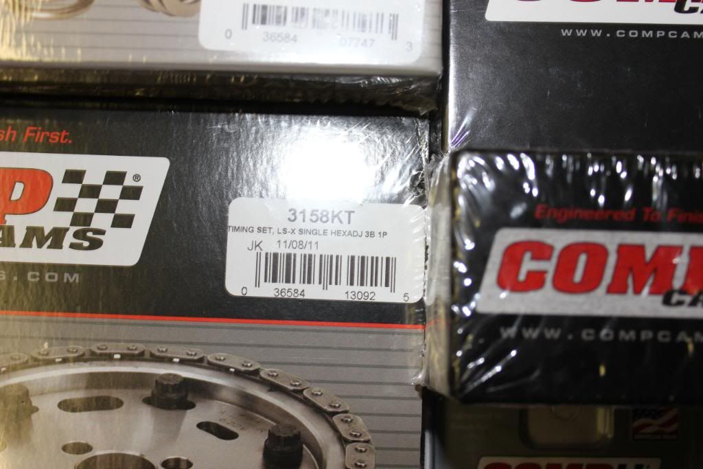

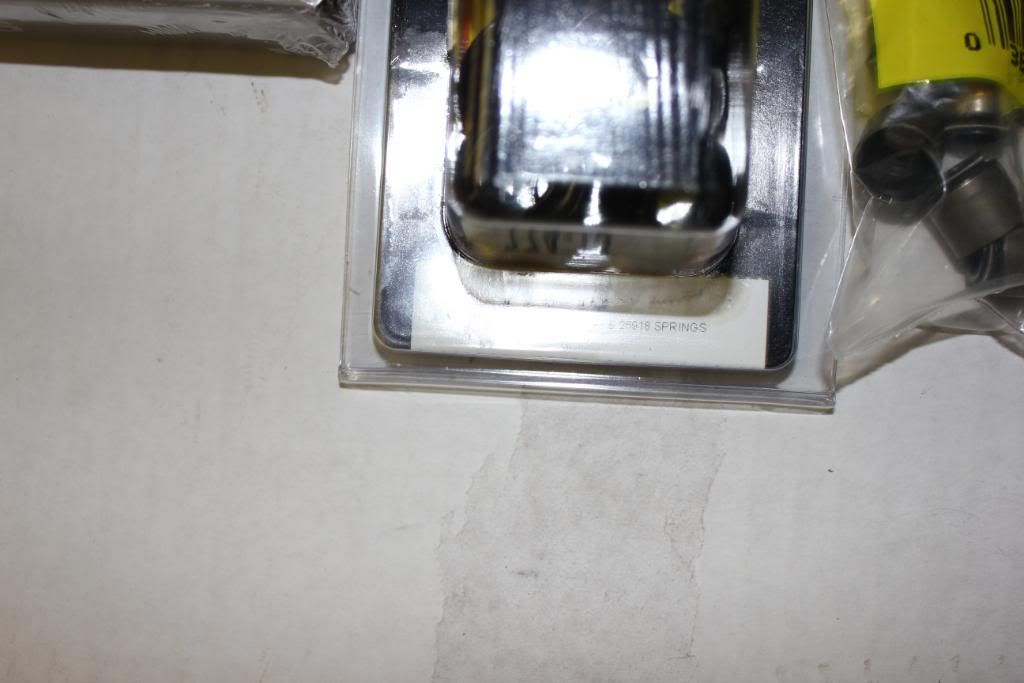

Sparky came by a little while ago with more goodies...from Comp Cams! This should really wake up the 6.0.

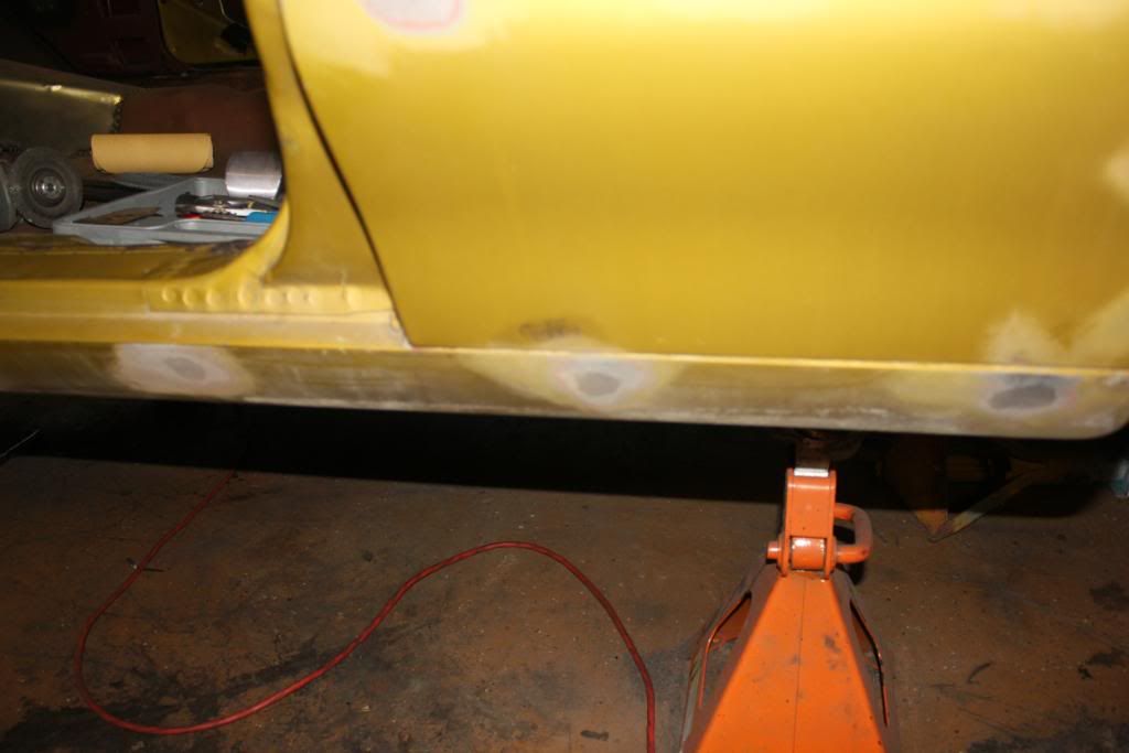

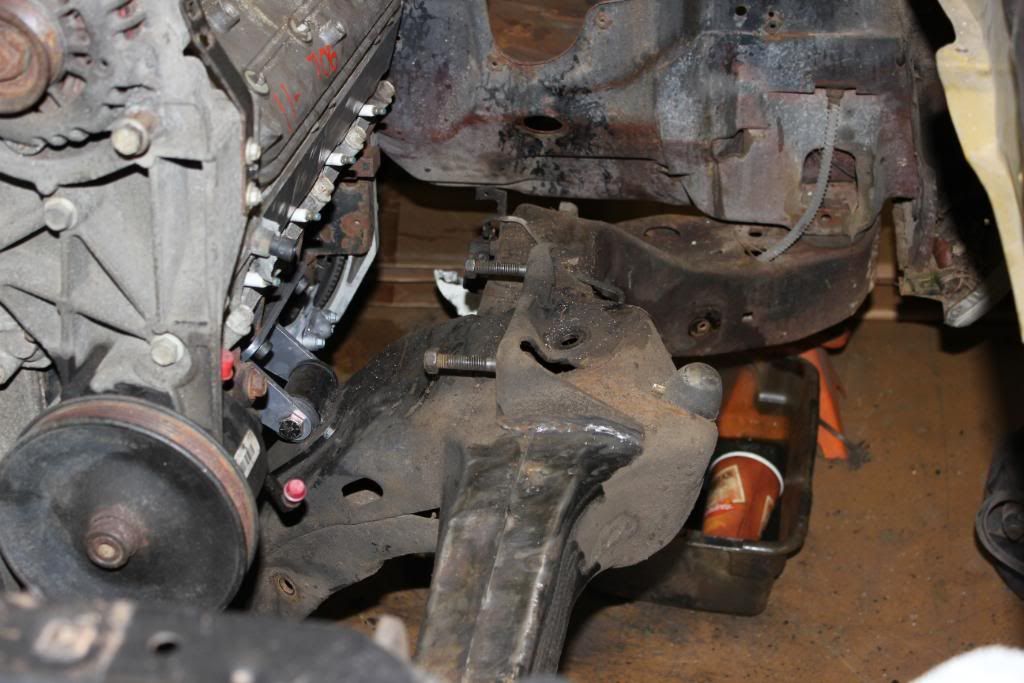

Here are a few updates from one of our other, more current build threads:
The front suspension is now gone:

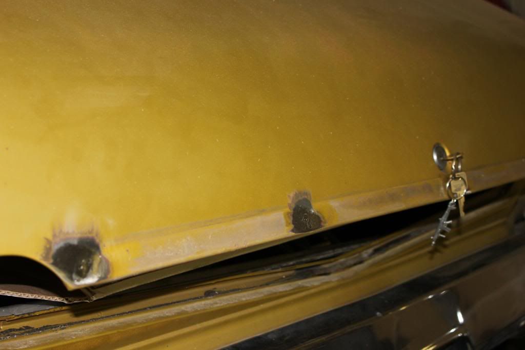

Welding up trim holes

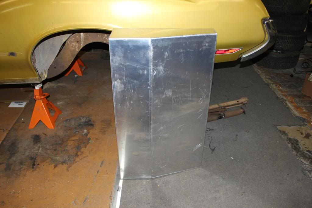

RnD Fabrication's prototype fuel cell:
Once we check fitment, this one will get DA sanded down to remove any scratches, and then probably a brushed finish.

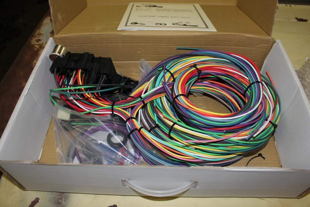

Here is the new wiring harness from EZ-Wire:

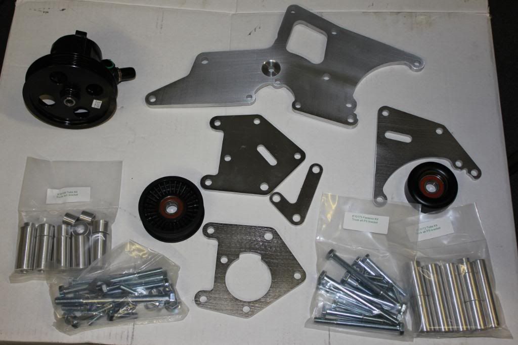

Update time! First, a few pics of the Kwik Performance accessory brackets. I have used these on other projects, and they work great, are relatively inexpensive compared to other "new" alternatives, and look good. Plus, in our case, they allow the use of the truck style water pump and hub, but with a Corvette-style layout.

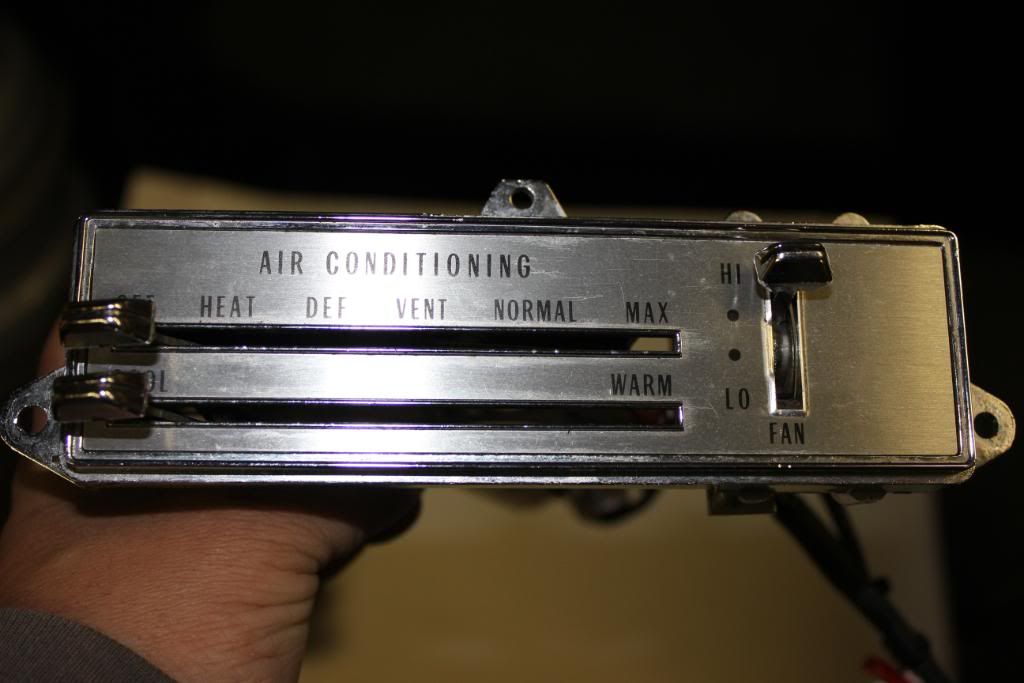

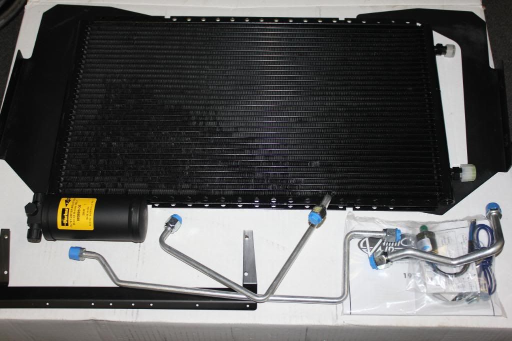

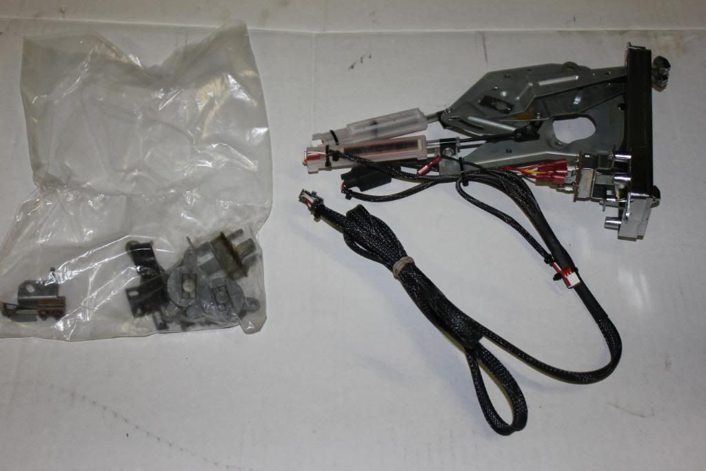

Next up is the Vintage Air Gen IV kit, made specifically for the '70-'72 Cutlass. This is a new item...so new, in fact, that the new control panel wasn't available yet, so the great people at Vintage Air converted our stock one! We have converted Chevelle-based kits for use on BOP cars in the past, but Vintage will make this one easy on us.
The stuff in the bag is from our original control panel, which Vintage Air sent back to us. Notice the nice braided covering on the wiring; this is straight out of the box! We must use the same supplier on wire loom, since I use the exact same stuff in my shop.

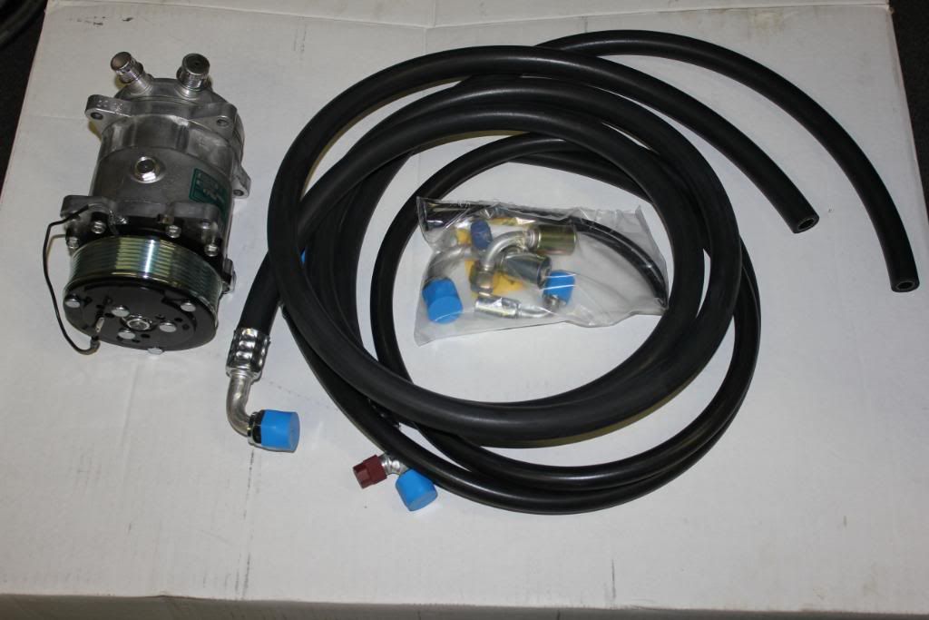

The Sanden compressor and hose kit
Condensor, drier, and lines. The condensor came with nice custom brackets for mounting in the stock location.

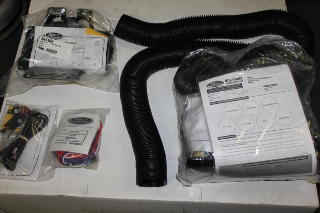

Vent hose and a few other misc kit items

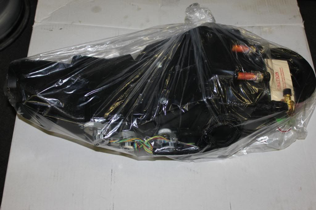

The evaporator unit itself...still wrapped up for protection, since it won't be permanently installed til the car is painted

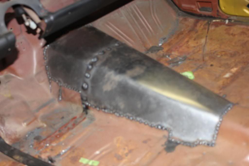

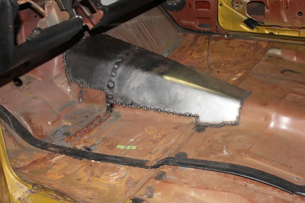

The transmission tunnel is almost done! According to BRP, the tunnel can just be stretched a bit, by cutting it down the middle and adding a piece, but we went a different route and are fabbing up a whole new tunnel.
The tunnel is in, but not fully welded at this point. Obviously, we still need to cut a hole for the shifter!

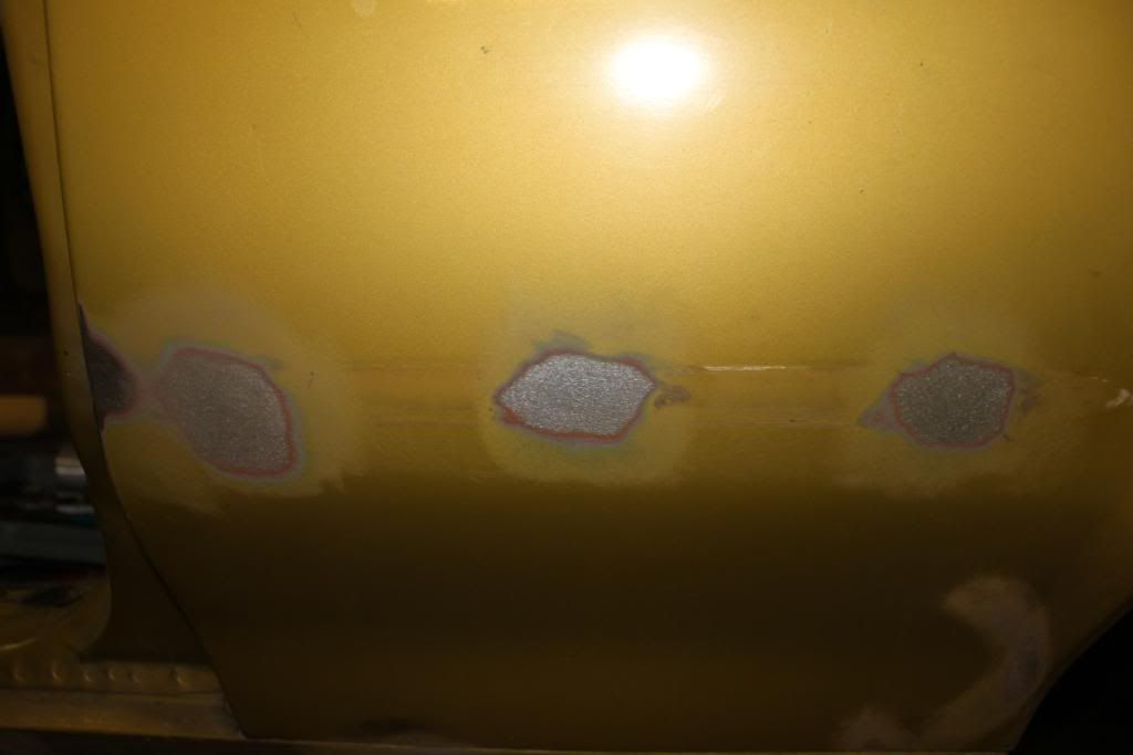

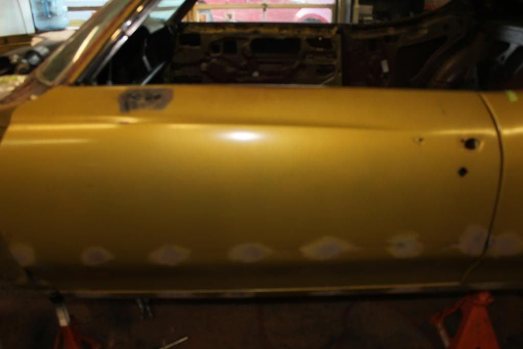

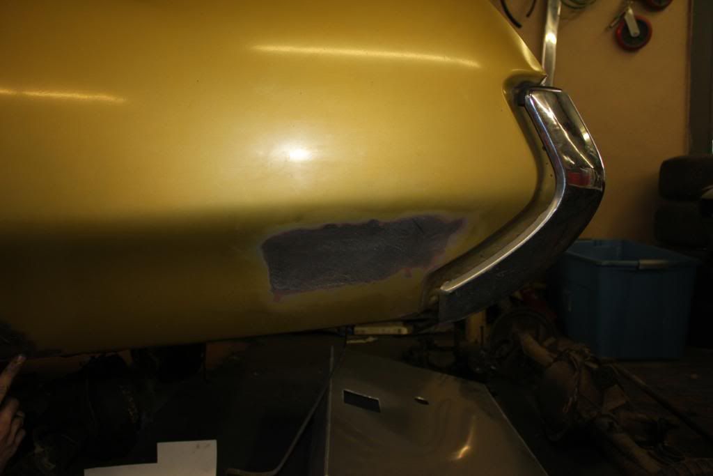

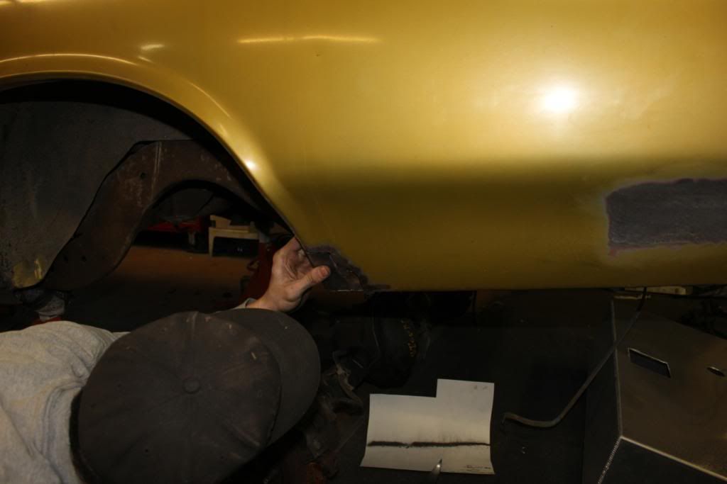

Where did the marker light go?
Jeremy fitting a patch panel for the quarter.

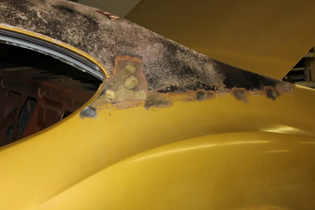

Vinyl top trim holes filled

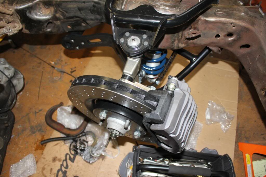

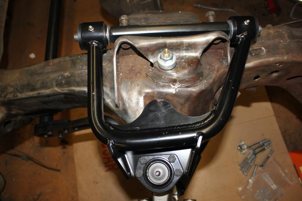

Originally Posted by BulldawgMusclecars View Post

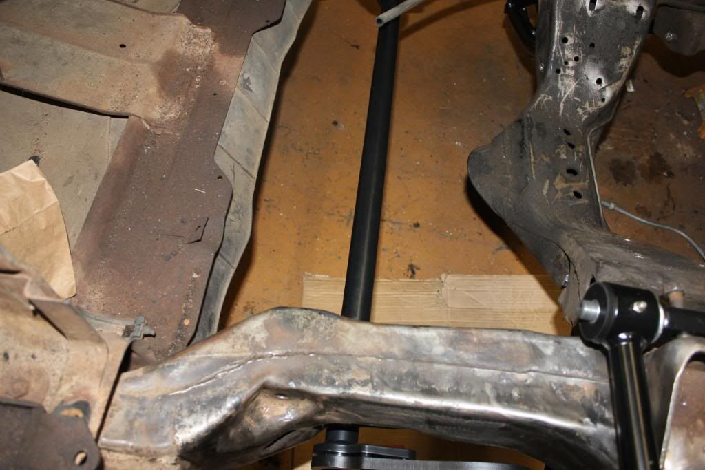

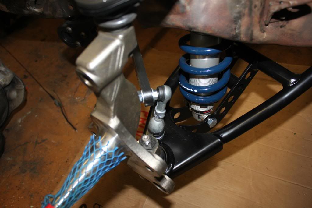

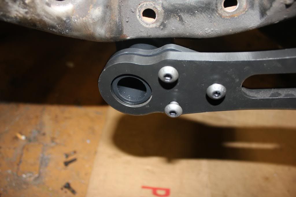

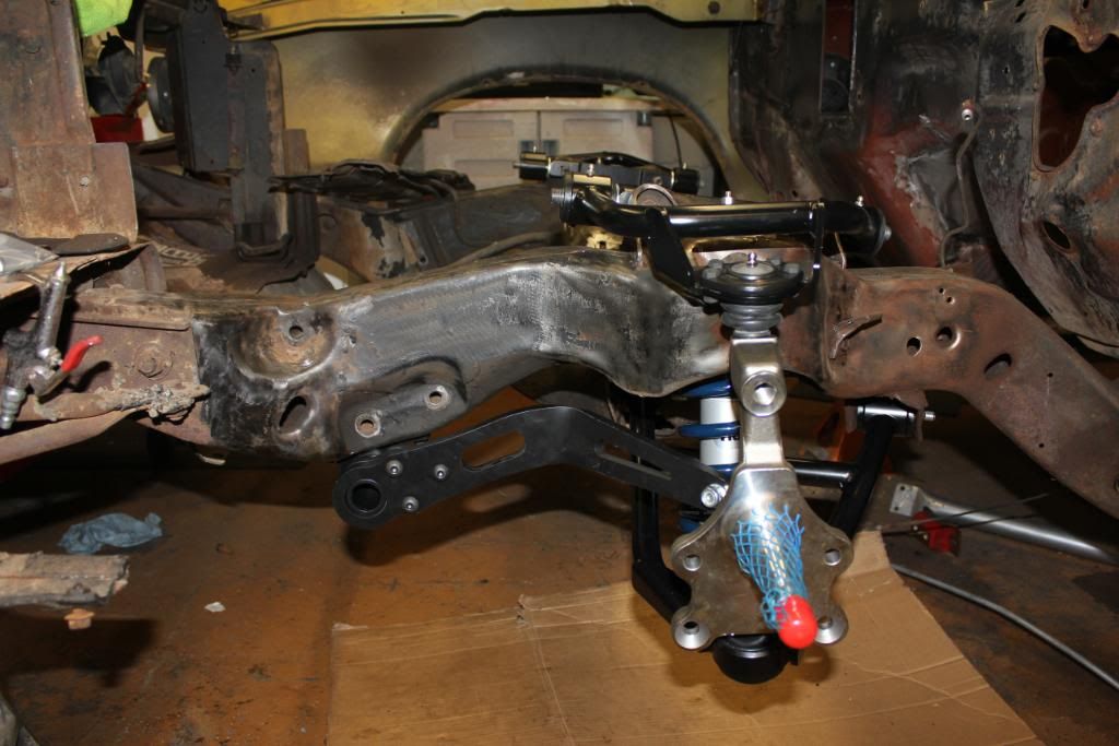

Curt got the RideTech StrongArms, coil overs, and sway bar mocked up today
Sparky@RnDFabrication
www.RnDFabrication.com
From mild to wild, we help your project stand out from the rest!
  #29
Old 02-01-2012, 08:55 PM
SparkyRnD's Avatar
SparkyRnD SparkyRnD is offline
Join Date: Aug 2011
Location: Georgia
Posts: 78

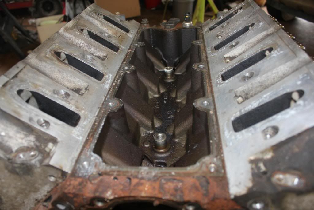

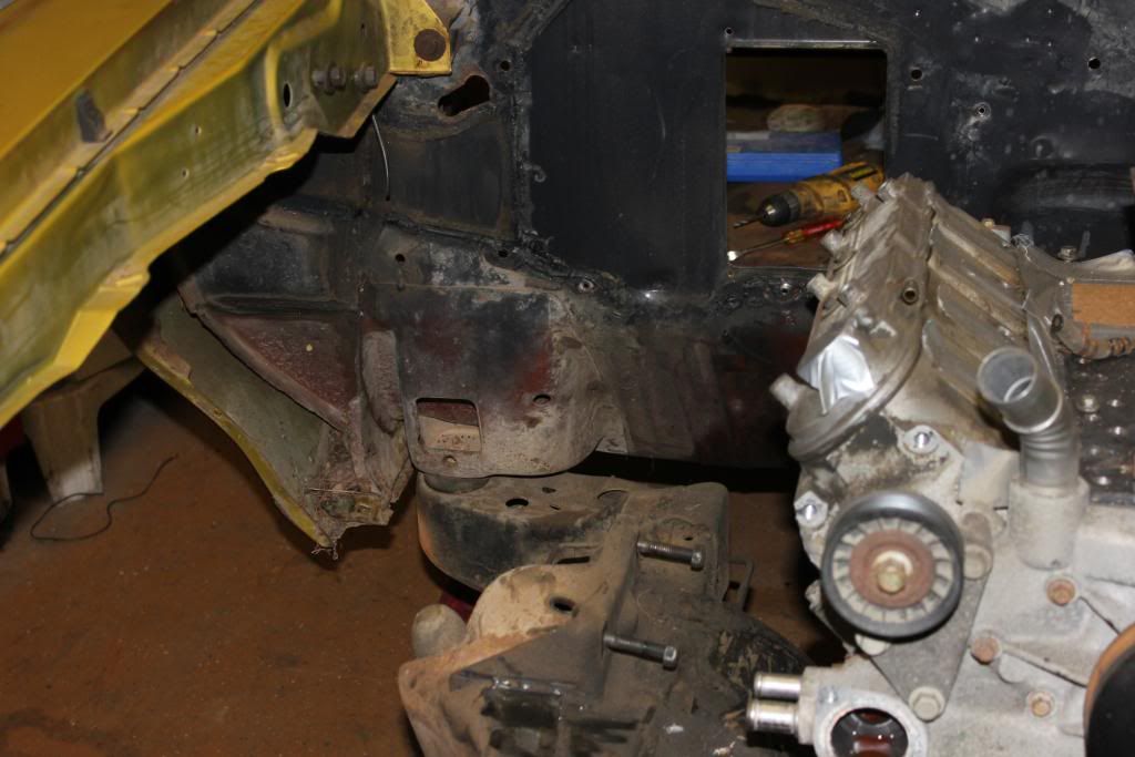

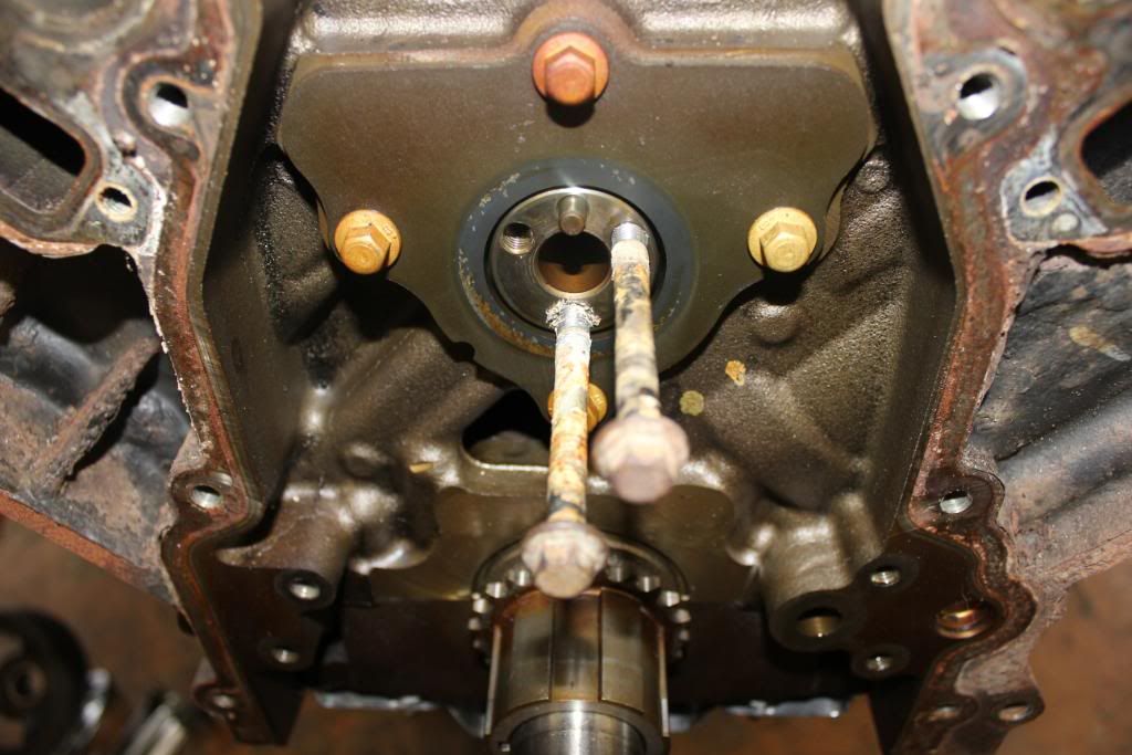

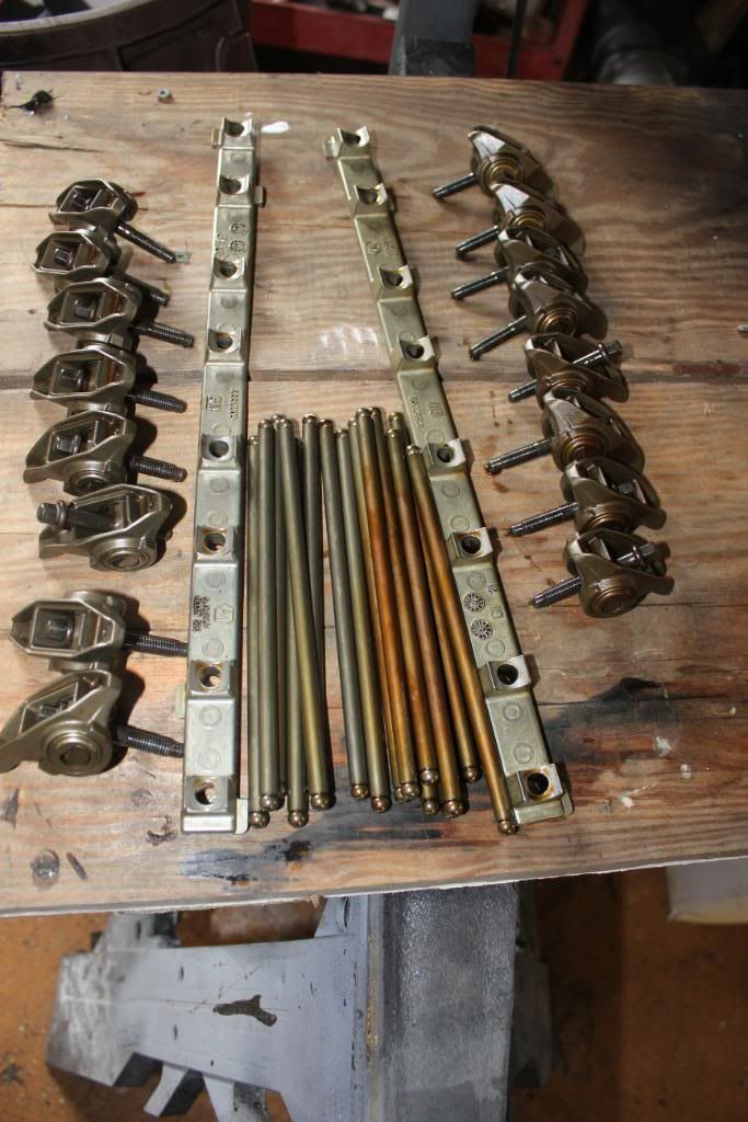

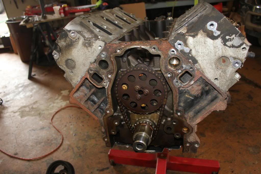

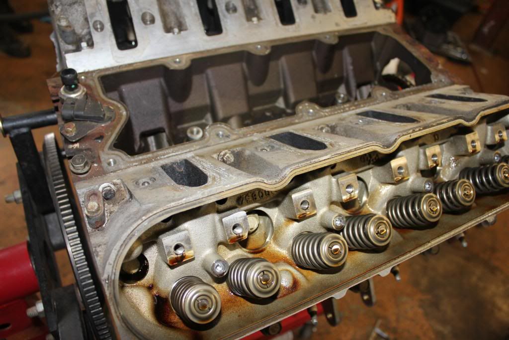

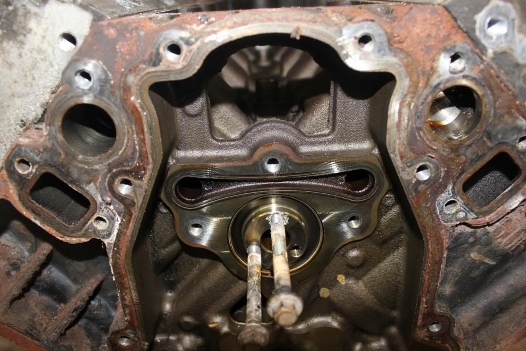

Making some progress today. I started tearing into the 6.0 for the cam swap. The oil pan, timing cover, and oil pump (mounts to the front around the crank hub) have been removed at this point.
The cam card.

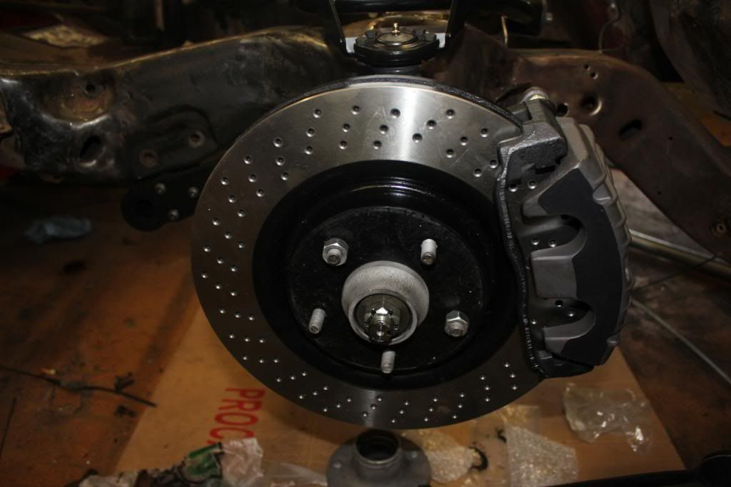

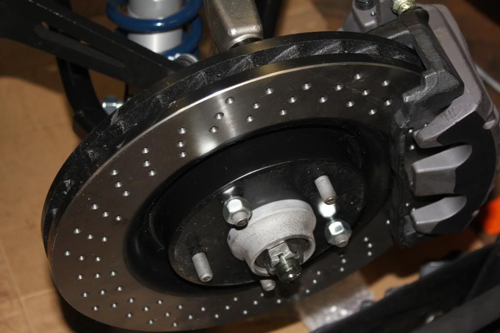

I had the hubs turned down today to fit the rotors (drum brake hubs left over from a '67 Camaro disc swap), and Curt got the brakes bolted up with the new KORE3 brackets, GM abutments, and a new C6 J52 (Z51) brake rotor and remanufactured C5 Corvette caliper, both from our local O'Reilly Auto Parts. This is just a mockup, so note the pads aren't installed.

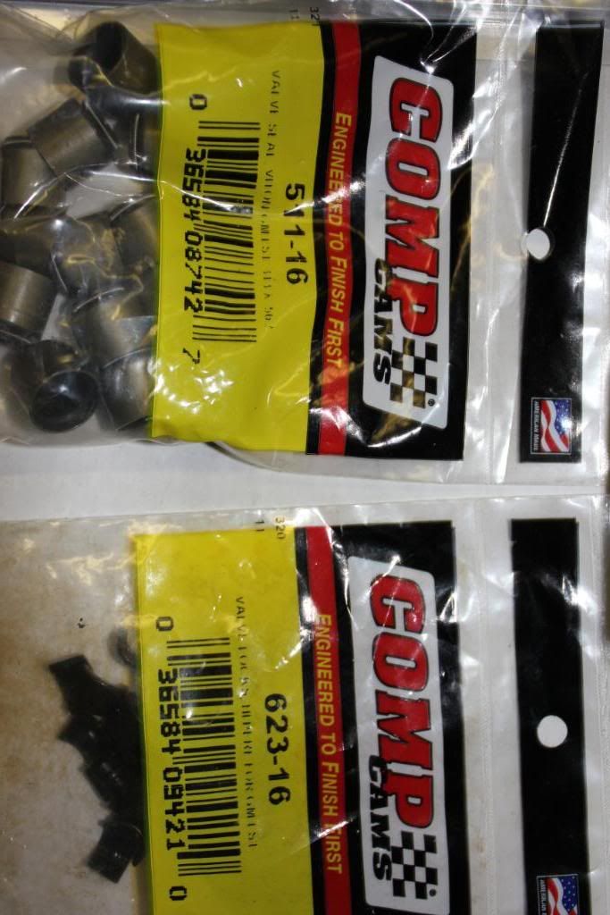

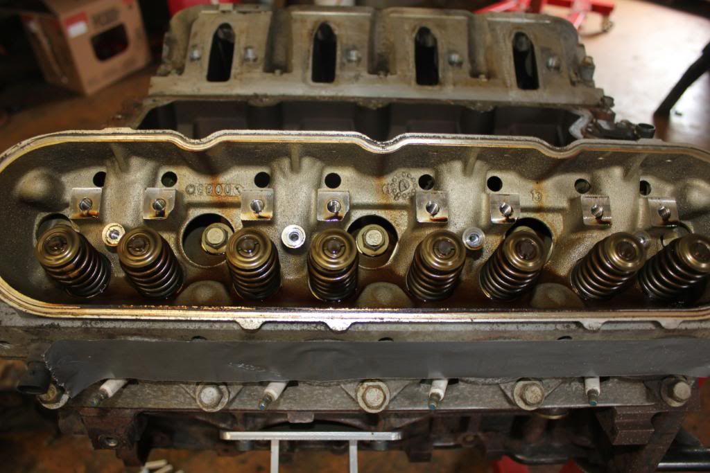

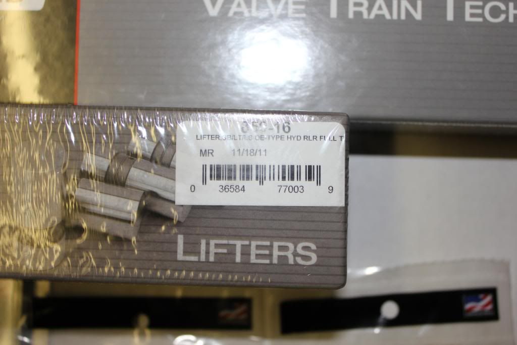

They also got about half the valve springs, retainers, locks and seals changed out, and will get the rest knocked out in the morning, and install the new lifters and re-seal the heads. While they're off, the guys at BullDawg will get the heads cleaned up and looking good, and get the block cleaned up and primed. After color selections are finalized, the block will get painted to match and start reassembly.
