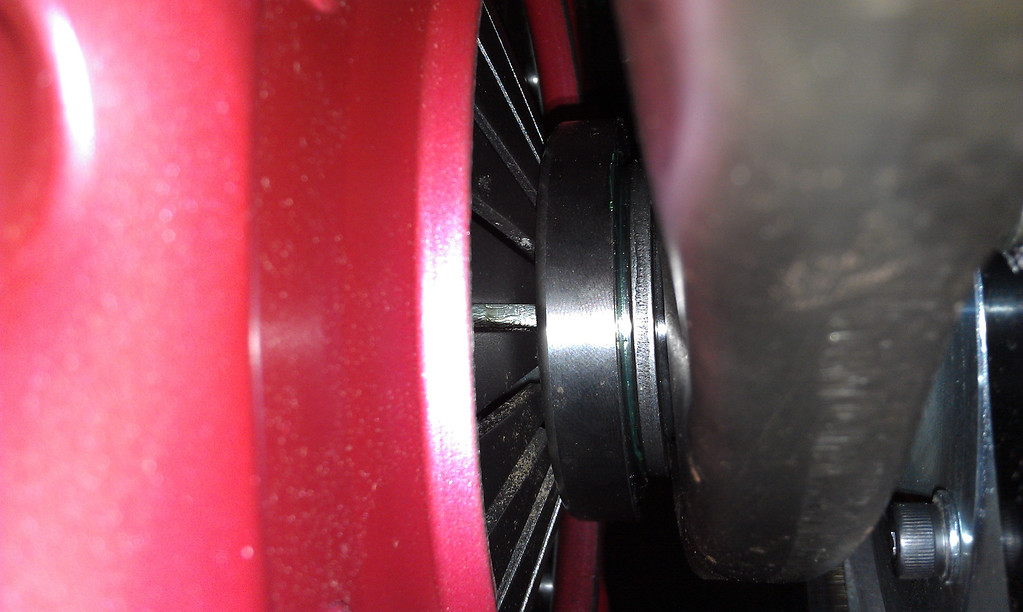

Besides the anticipated tunnel clearance mods the only real issue we had with the install was the throw-out bearing shipped with the kit from Hurst Drivelines......too long
Hurst responded promptly and shipped me a Mcleod adjustable at no charge.

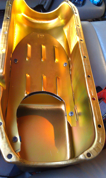

So moving right along, I've fought a leaking front timing cover to oil pan seal since I've had the car. Decided while the tranny was out to replace the cover and pan with Milodon units and a Felpro one piece silcone gasket. We could squeeze the motor up just enough to get the pan out between the crank and cross member. One ficken problem, the windage tray would clear the oil pump pick-up.
Nothing a little cutting can't fix.......I saved the piece so in the future it can be tacked back in. I used black permagasket silicone on the front and rear seals when we reinstalled the pan and all went well.
So the first test drive I find out it's leaking worse than before.....WTF! I call Milodon and was informed their gasket has a little more material at the front an rear seals than Felpro's............. So at some point in the near future the motor will be coming out and the pan will be mounted with a Milodon gasket and The Right Stuff. Did I mention that I HATE OIL LEAKS!?

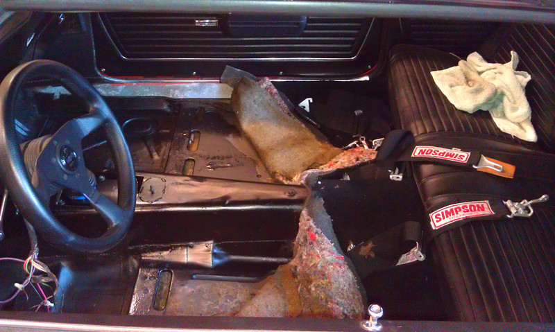

One thing leads to another..........
POR 15'd
Dynamat Extreme and new carpet
Back together again
I also went to the local crafts store and bought some vinyl and sewed up a shift boot. FWIW - I used an O-ring to secure the top.
One thing I did to add additional sound deadening was cut out panels of 1/2 felted wool commercial carpet pad and fit in the backside of the rear seat panels. I feel it was well worth it, as the tail pipe noise is reduced about 50% now. Even though at first I wasn't sure if I liked it so quiet, but now I can actually hear someone during a phone call.
