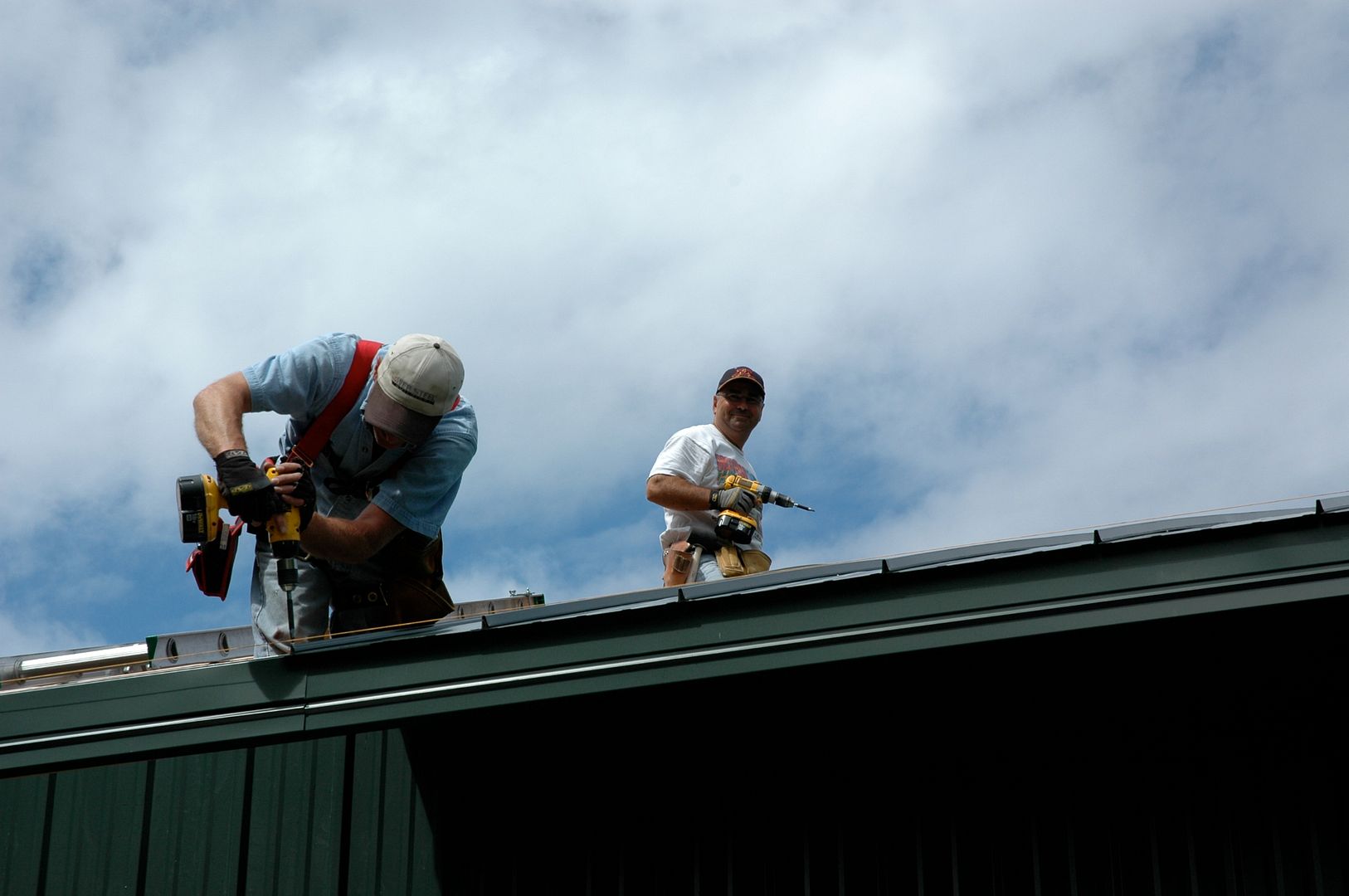

Build your own! I did!

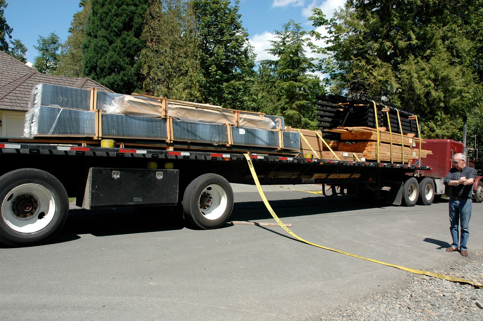

This will show up at your house!

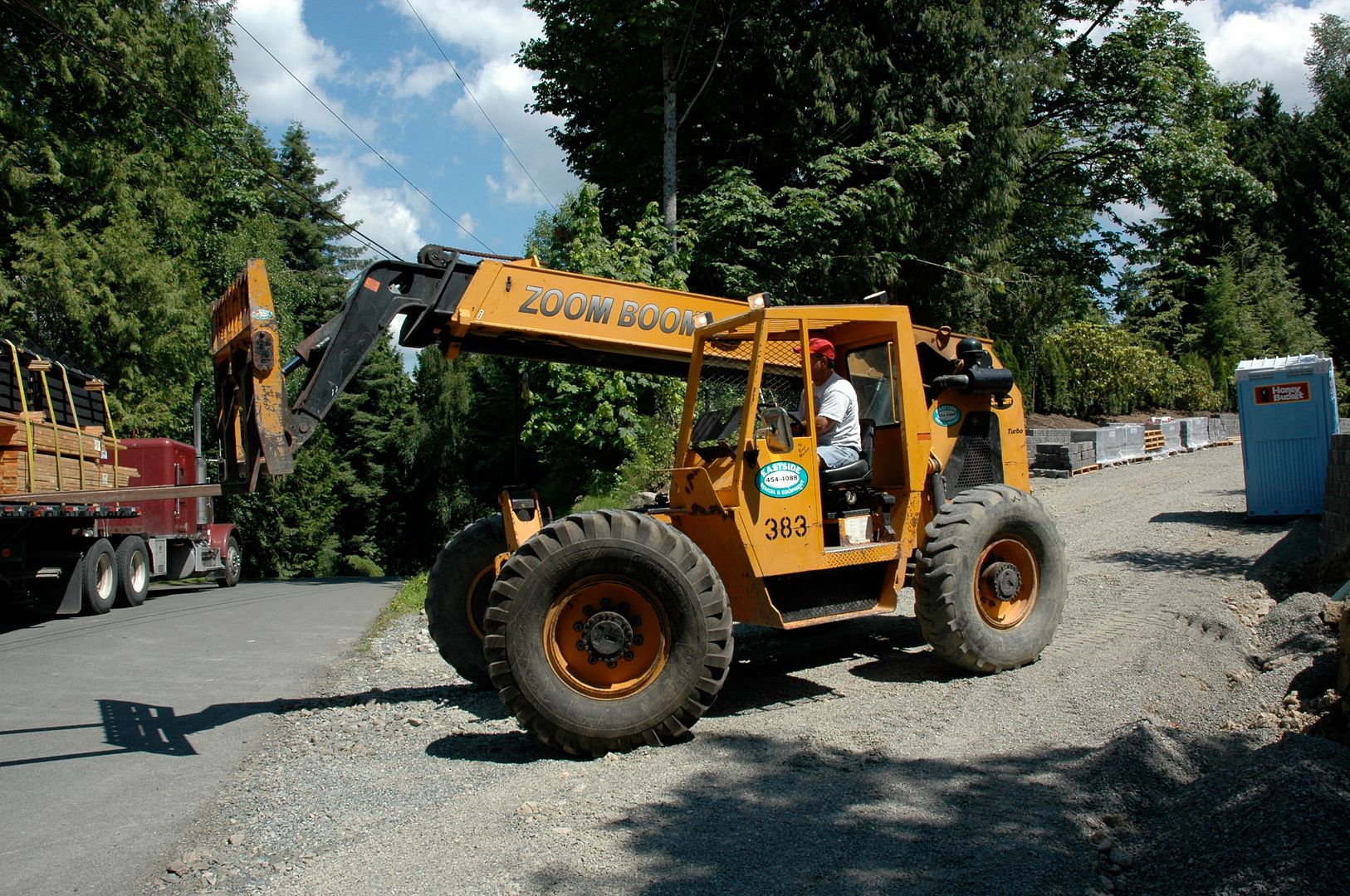

Make sure you rent one of these!

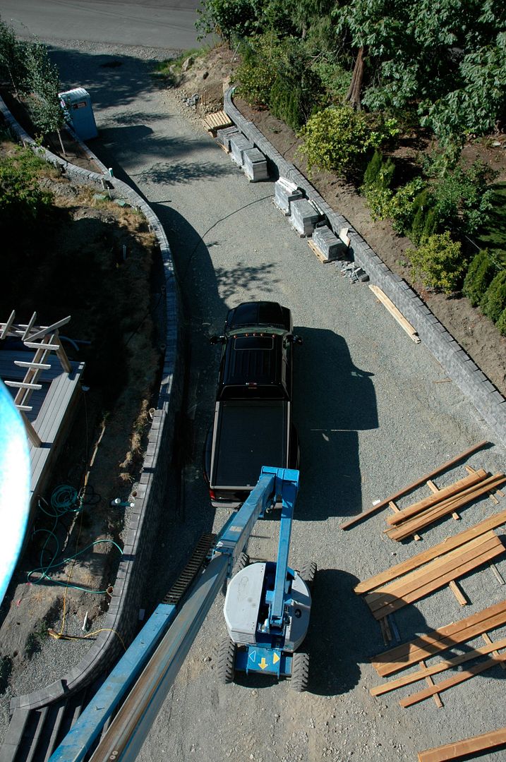

And one of these!

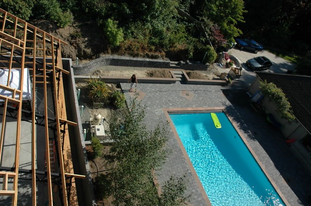

So you can take cool pics like this!
