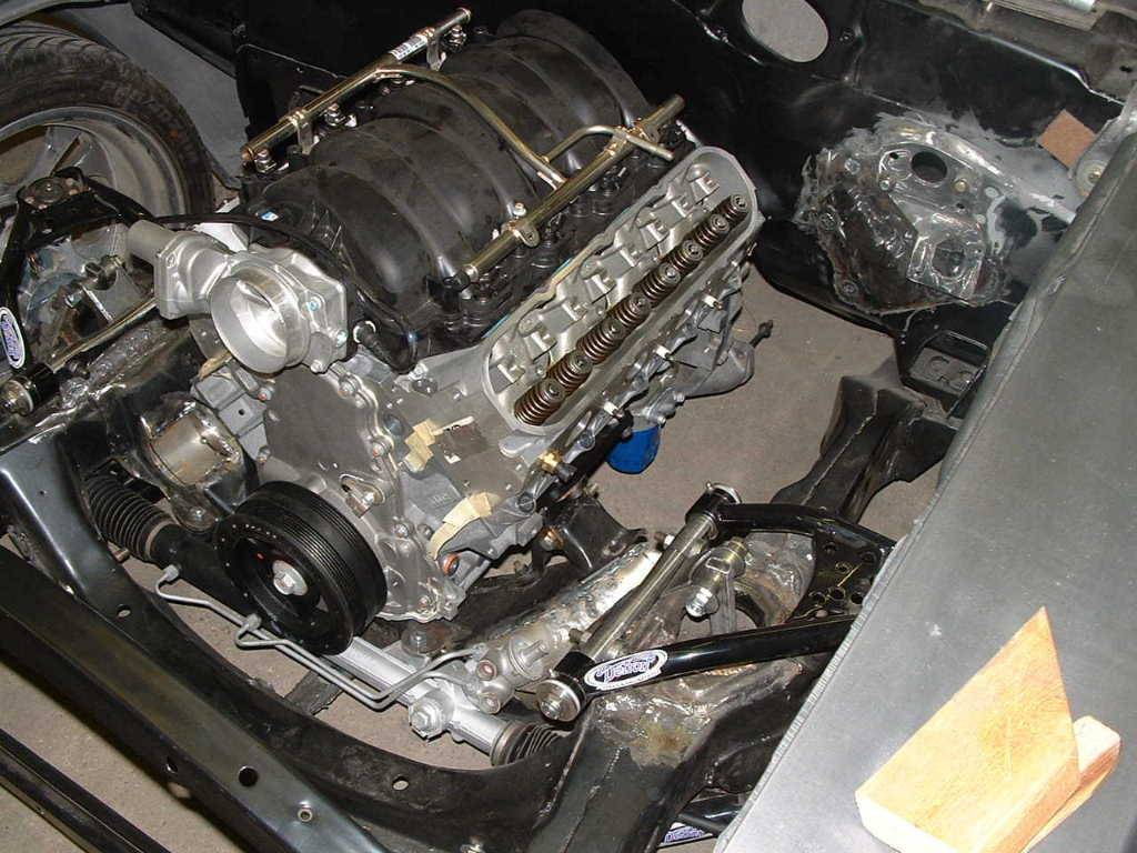

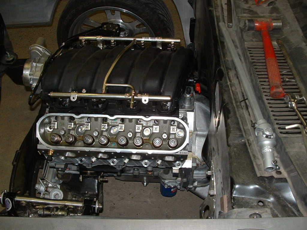

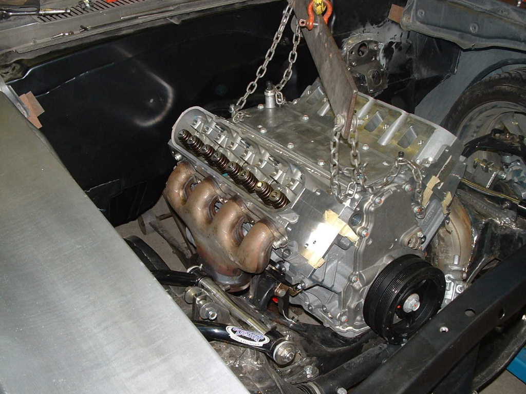

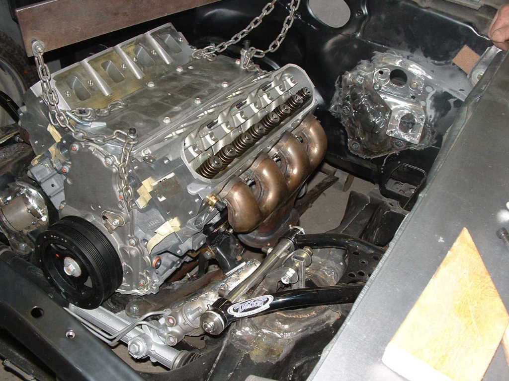

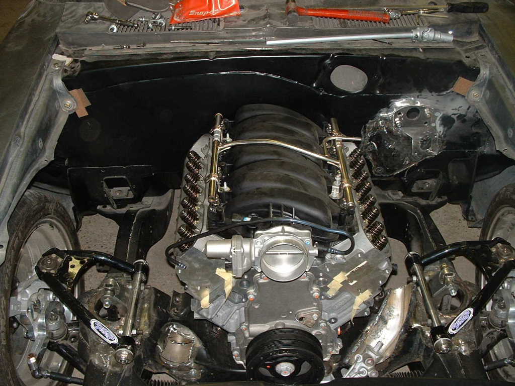

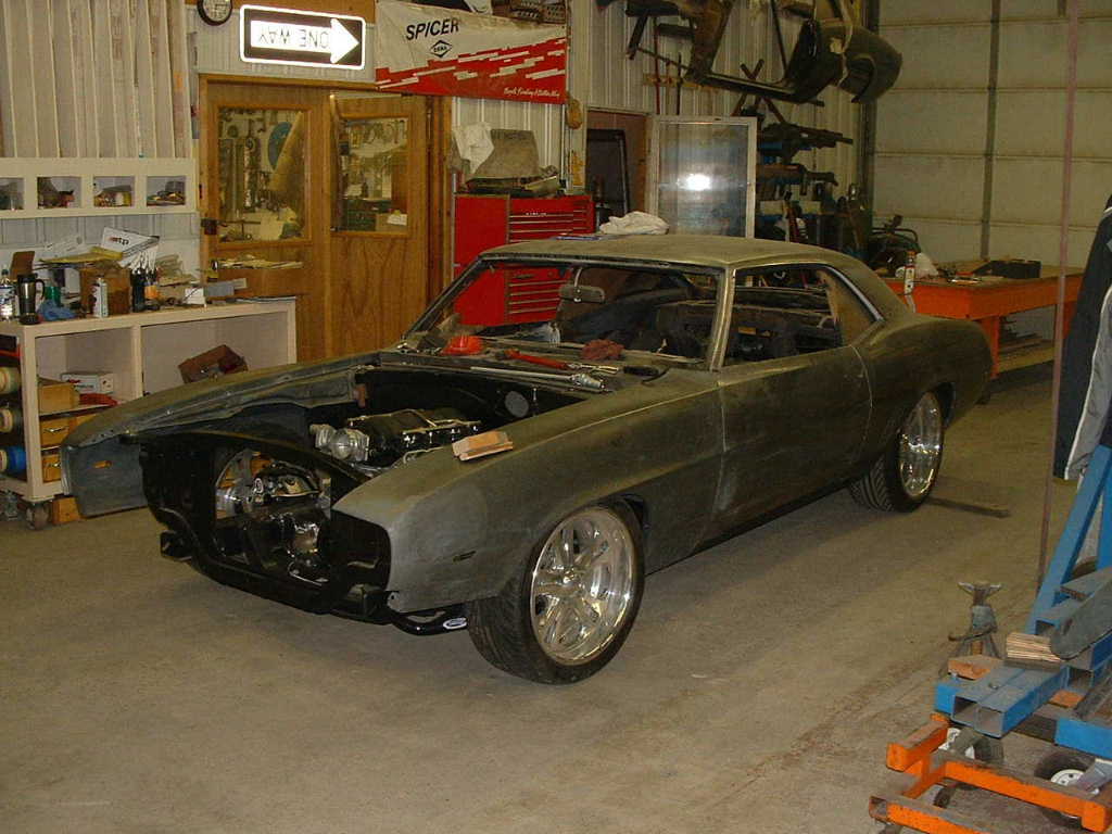

We got the engine in last night! I got some pretty good pics. I was going to use the factory exhaust manifolds, but I decided to get headers from street & performance instead. Hopefully will have them in a week or two. Also installed a front mount rack from BRP, now I just have to figure out a sway bar location. I'm thinking something like a speedway front mount. BRP sent the brackets to mount in back, but I think it will hang down to low. Anyway I'm looking for any feed back as I go forward with this thing, if anyone has any suggestions/ideas on anything feel free to voice your opinion.Thanks

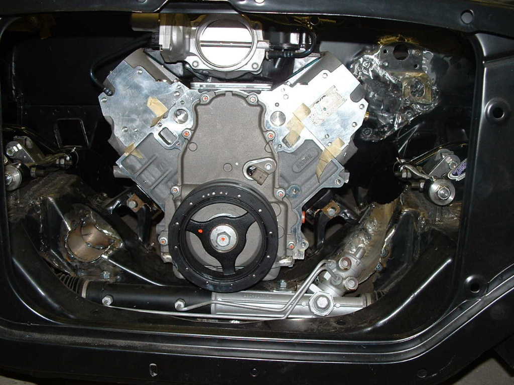

Default couple more pics
a few more

to the LS7 what a sweet motor!
I'd really like to know how the install goes, PCM mods and Throttle By Wire etc.
You should run the Hooker or SW longtubes or better the ATS ones if they fit your budget.
Killer car

The ATS ones definately don't fit the already blown budget. I didn't know Hooker made any. Do you have any info on them?

Here's the info: http://www.holley.com/2288-1HKR.asp
They also make thier own motor plates.
