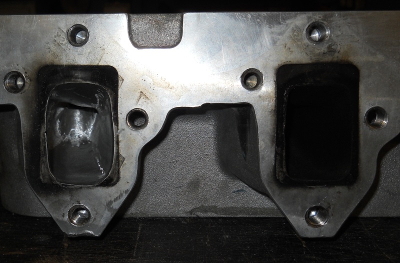

Port Matching, on the intake.
Despite reading and re reading, posts saying "there is little or no significant gain in power, by doing intake port matching"
I decided to ignore it, and check out my port alignment.
Check it out;
I think, there are one or two horsepower there.
I have very noticable marks on the intake manifold, from the gaskets, so it makes it pretty easy, to mark up the manifold.
Took me one hour to do one side, the other side tomorrow night.

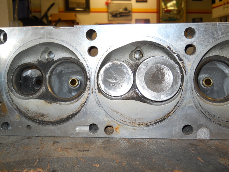

I have 7 of 8 of the intake manifold ports done. One more to go, and then I'll do a detail on the ports.
I took the heads by my engine shop, and got them disassembled, washed and brought them back home.
The intention is to do my own port and polish, along with a combustion chamber detail. I've done a lot of research on porting these heads, and what to be careful of.
I also picked up a couple of BBC (used) valves, to protect the seats, while I am doing the combustion chambers.
It should not be too bad, as it is just detailing. I'm not planning on removing a lot of material. Emphasis will be on the bowls. Smoothing the rough spots. Nice radiuses. Polishing the exhaust ports, and unshrouding the valves in the combustion chambers.

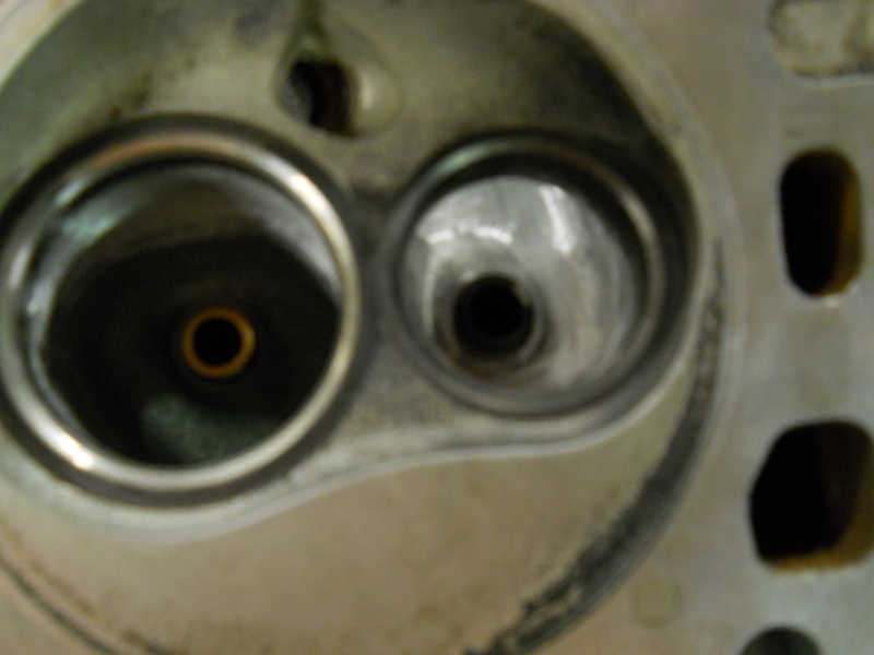

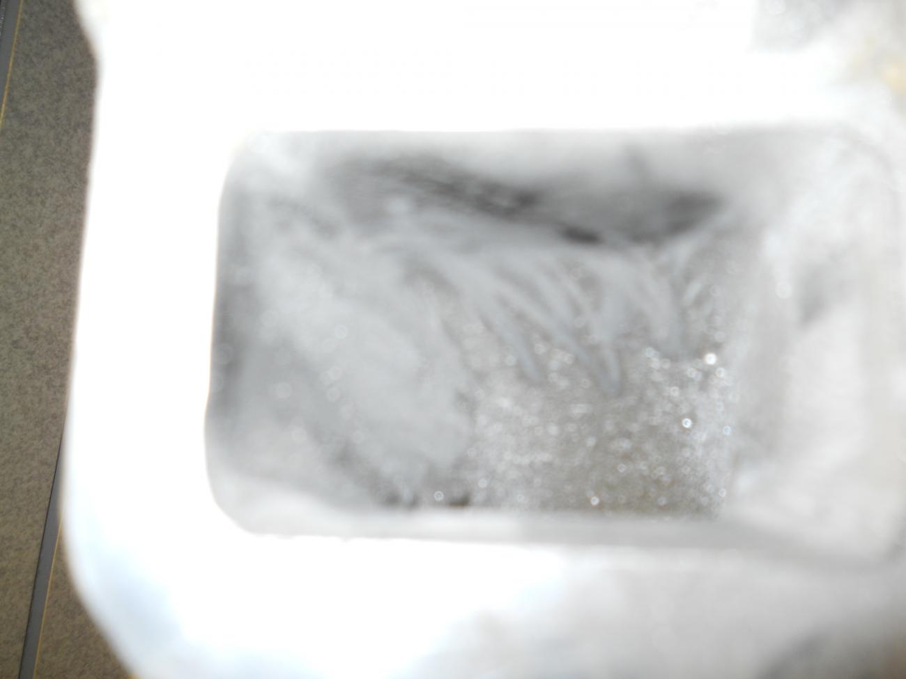

Ports on the intake are complete. I smoothed out (not polished) the roof of the ports (long radius) and I am using a coarse file to rough up the shorter (bottom radius), inside the intake manifold.
I started on the heads, beginning with an exhaust port.
A little smaller than the intake, but more forgiving.
I think it looks good so far. I got most of it roughed out in 30 minutes.

Porting work so far;
Intake is pretty much done, unless I change the shape of the ports on the head.
The last thing, I am going to do is hit the ports with a coarse file, to texture them a little.
Heads;
I started with an exhaust port, because it's smaller, and a little more forgiving, if I F-it up. I have a pretty good understanding of aerodynamics and hydrodynamics, so used that in shaping the exhaust port, and bowl.
I took into consideration, the shape of the header opening, and raised the port slightly. Next I ovaled the port slightly, again to match the header port, since they are a little taller than the heads.
The bowl is quite a bit deeper on the exit side of the port.
(Head is upside down, in pic below) I didn't do much with the short radius, other than a slight polish. I did turn down the port exit, into the header, as the header pipes all turn down
Once I'm done, the exhaust will get a nice polish, then I can replicate on the other 7 exhaust ports

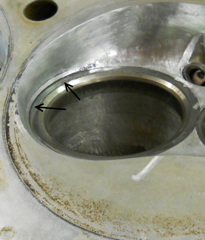

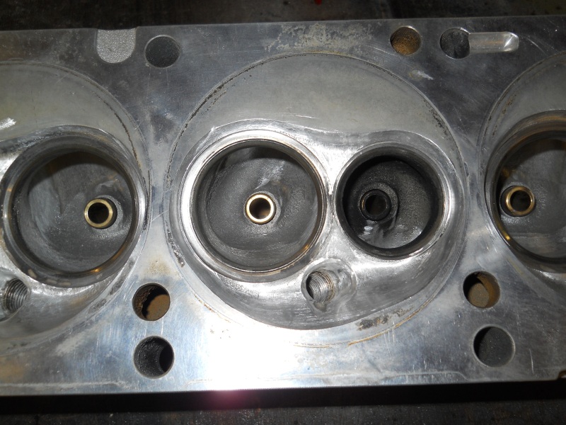

I have all the ports pretty well roughed out. I started unshrouding the valves, tonight. Once the valves are unshrouded, then the plugs, chambers, and bowls.
Lastly I polish the exhausts, and chambers.
