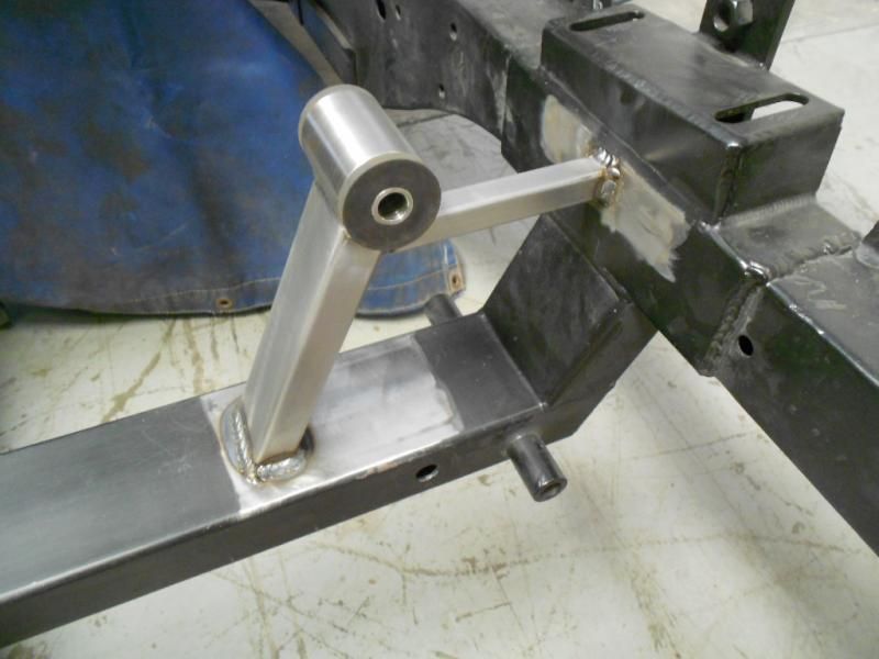

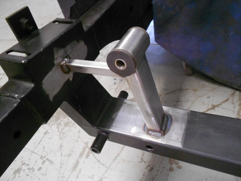

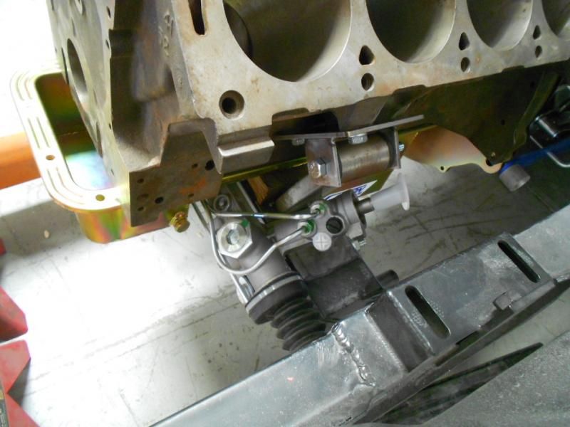

Brian cleaned the Rod & Custom crossmember getting ready to weld motor mounts.

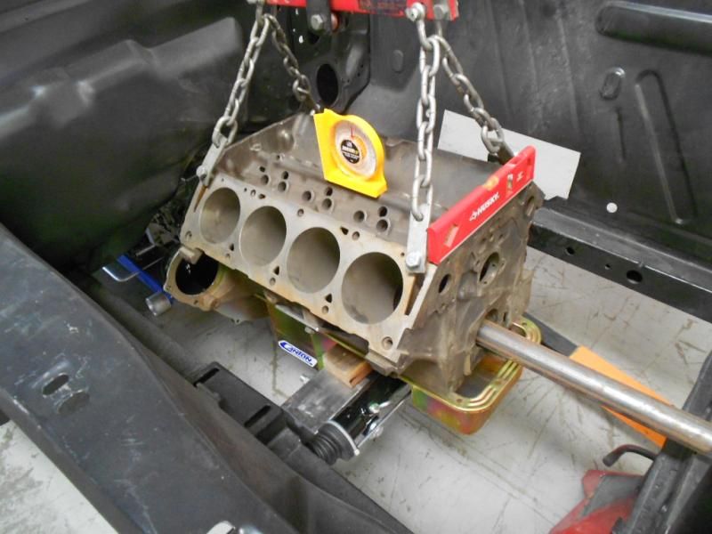

Getting ready to test fit the FE block with the Canton pan and TKO 600
Making sure the block is in the center, level and has a 4 degree angle so Brian can weld the motor mounts.

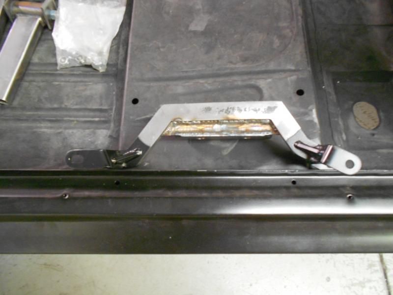

The transmission mount had to be modified to get the correct angle.

Brian welded the motor mounts in place. Now when you order a kit from Rod & Custom the motor mounts are already welded.

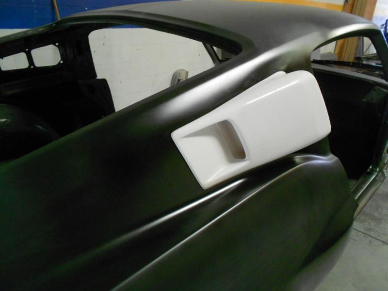

The new owner did not like the Eleanor non functional quarter scoops so we cut them off and installed Shelby scoops.
Awesome. That is going to look mean and functional.

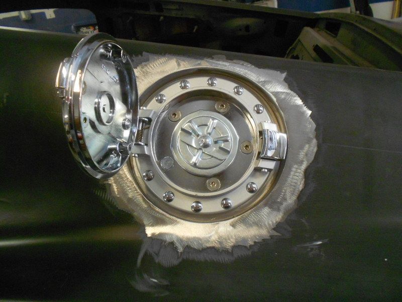

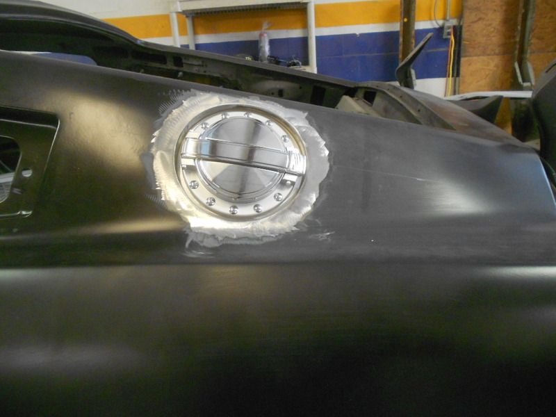

This project was on hold for a few years and the owner has decided on a few changes. I'm sorry to say he has decided not to go with the SOHC but is going with an aluminum FE just not sure how big it will be yet. We will also be doing a few modifications to the body.
It is out of storage and back in the fab shop.
The first thing Brian did was finish lining up the sheetmetal
Starting to install the Mustang to Fear gas filler kit.
Welded in place and the welds ground
