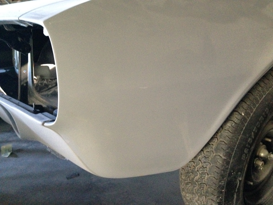

Great work guys! You have quite a few projects going on. Nice to see. One mod you did on the this was welding up the bumper brackets and lower fender extenetions. I don't undertsand why more people do not do that. Looks so much cleaner and flows well with the rounded wheels wells on the 67 & 68's. Nice work!
Here is an updated picture of the what is described above. I agree!

Body shop update. Made a trip out to see if it was ready for color. Still a few little things to do but they are close.
