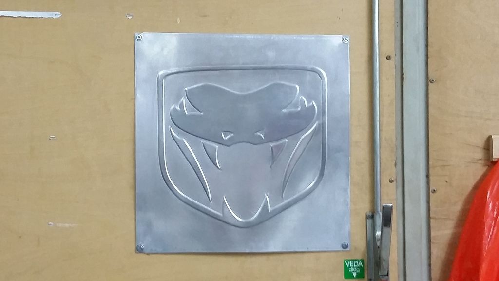

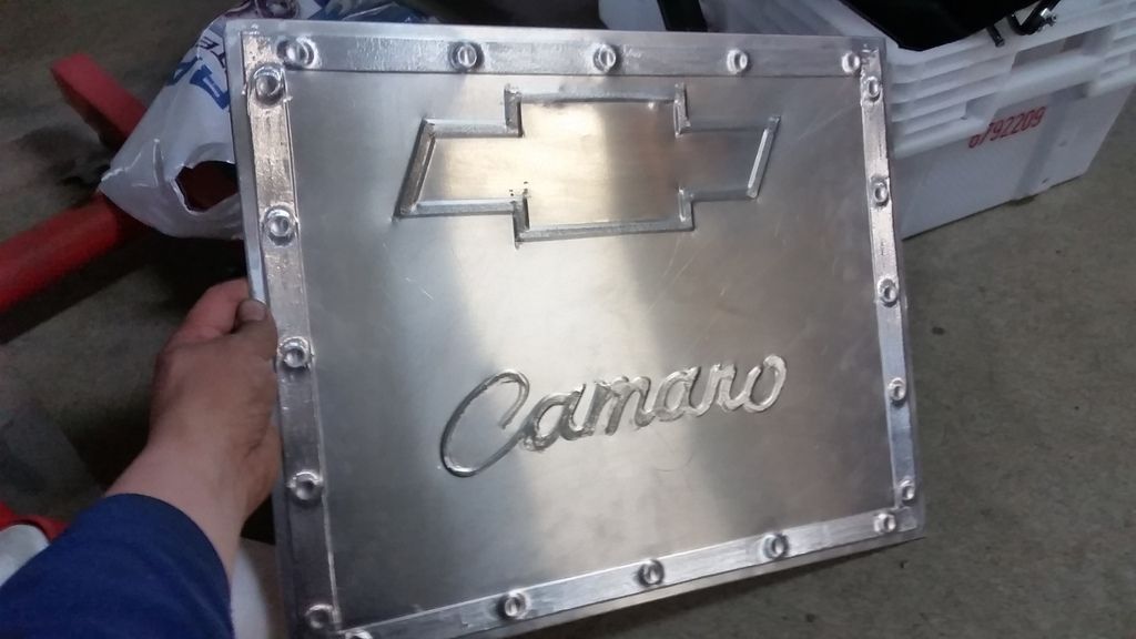

But bead rolling is fun and easy way to build nice things. Even with out buying expensive stuff. I know that Shane can and will hook everybody how wants. They do have nice tools...
and go straight to magnetic brake.
Here are some of my pieces. Made with home made machine and dies.
And there's something else on the forum that I'm jealous of...... Great job! You're a talented man.

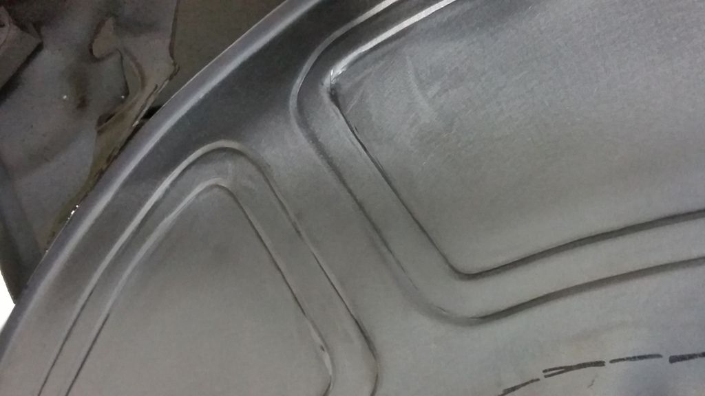

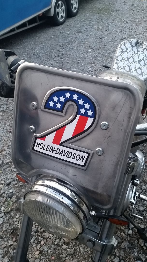

Now been doing more. Here is some of the latest.
Wheel tub wall to my "Project Plan Bee"
3 step and half of the round edge. Other half is in tub side. Seam in the middle of the radius.
Sing to my friends HD.
