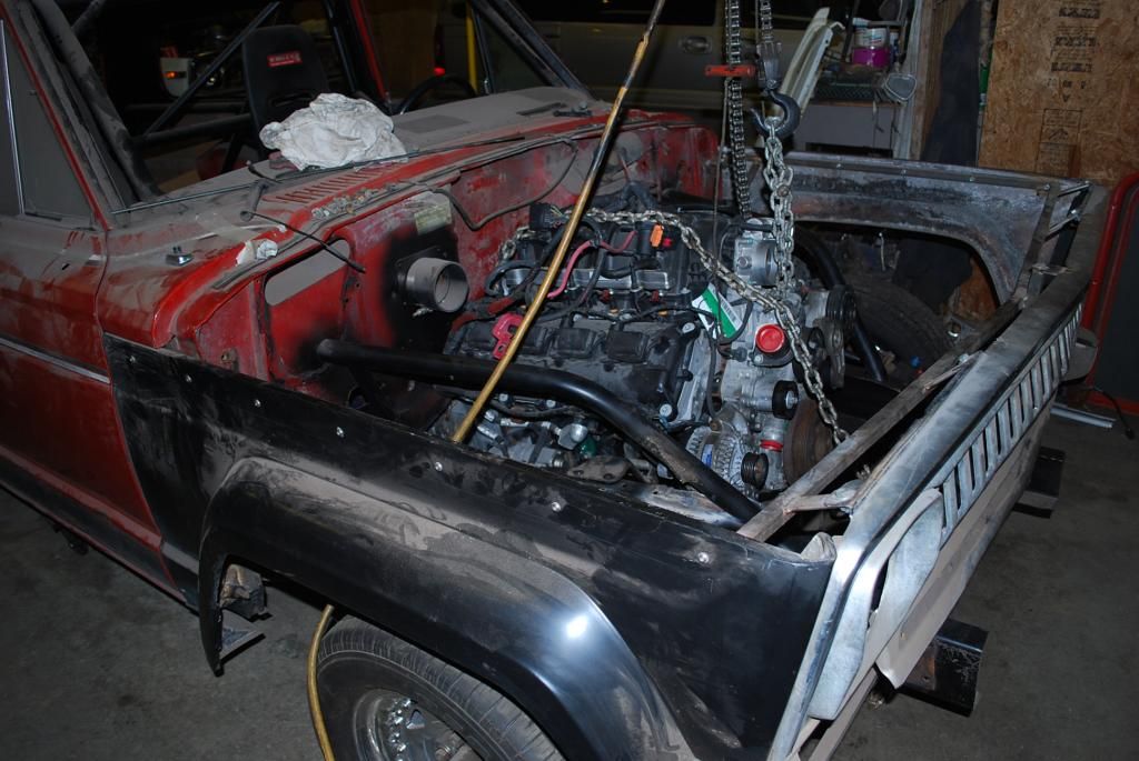

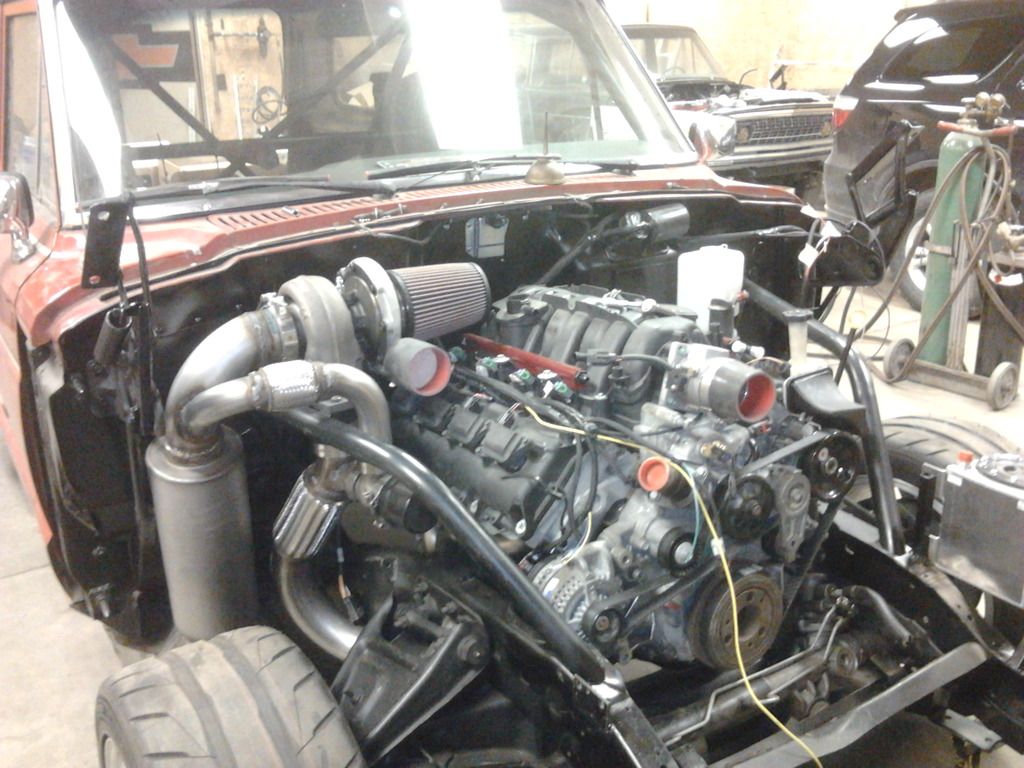

Trial fit of the engine. Everything fit pretty nicely, just had to clearance the frame in one spot for the alternator. Got started on engine mounts, hopefully finish them up tonight. They're almost the exact mounting locations for the AMC v8 so not much work needed.

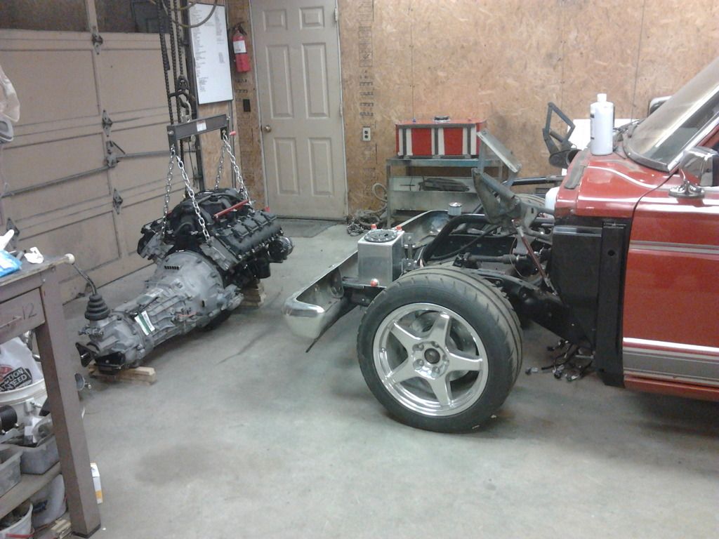

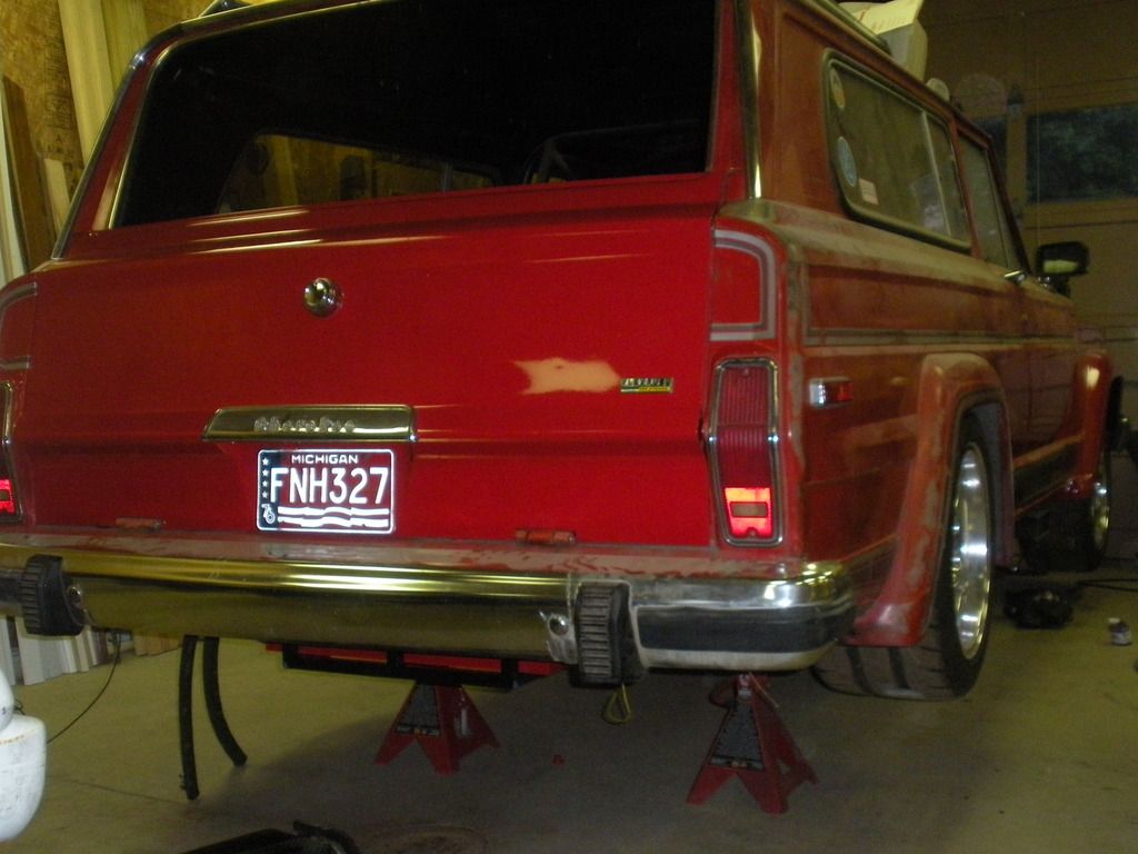

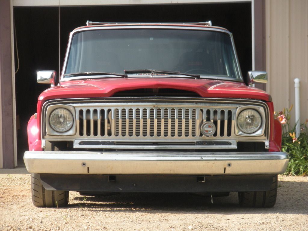

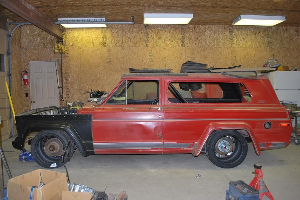

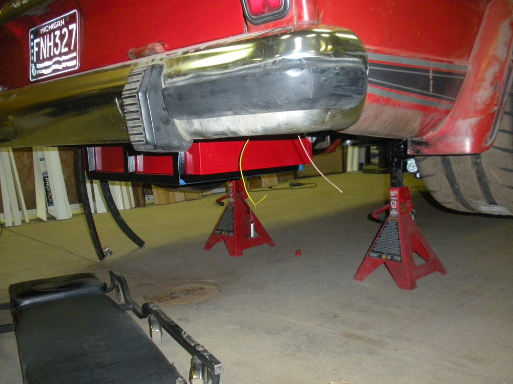

Yanked the front springs out so that I could measure for wheels/tires. These pictures show rough ride height but clearly the wrong tires. The fronts will stick out about as far as shown but the rears will come out another 2" or so. The rear wheels being sunk so far in makes it look like the rear isn't centered but it is. Going 275/40r17 front and 315/35r17 rear on 17x9.5 and 17x11 ZR1 replicas.

The tires showed up today. I ordered them yesterday at 5:00 pm and they were here today at 11:00 am. Wow. Still waiting on wheels and ordered adapters today.

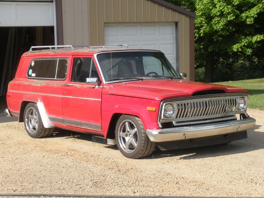

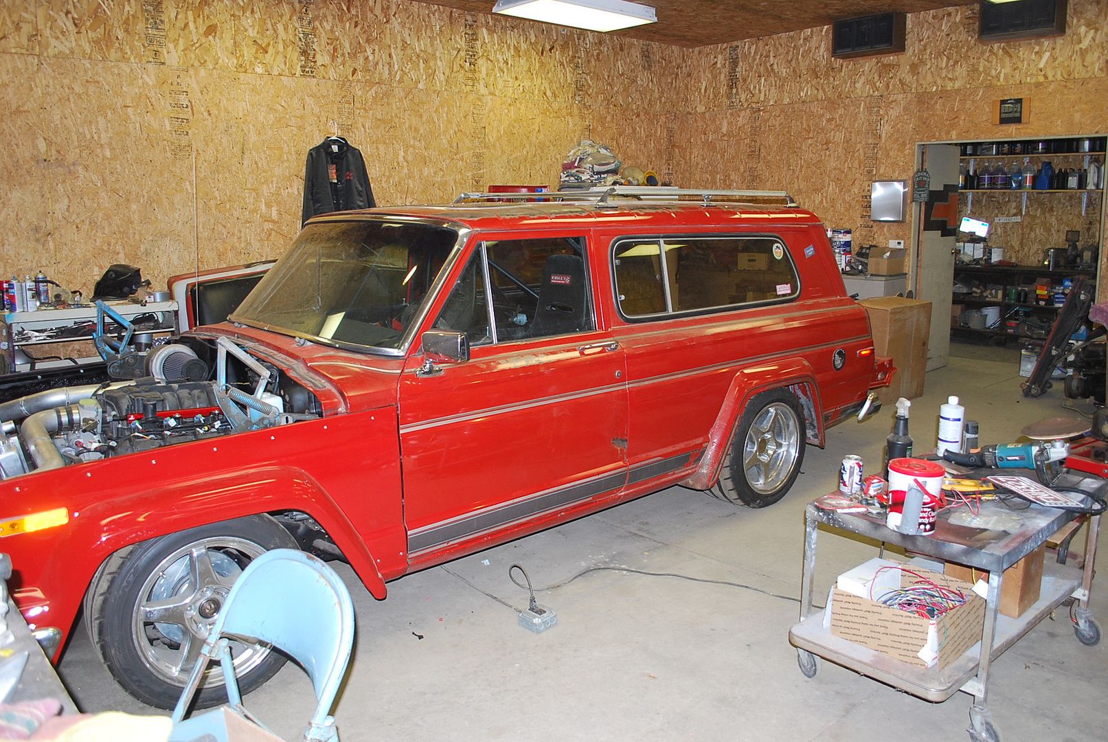

Just goofing around with the tires tonight.

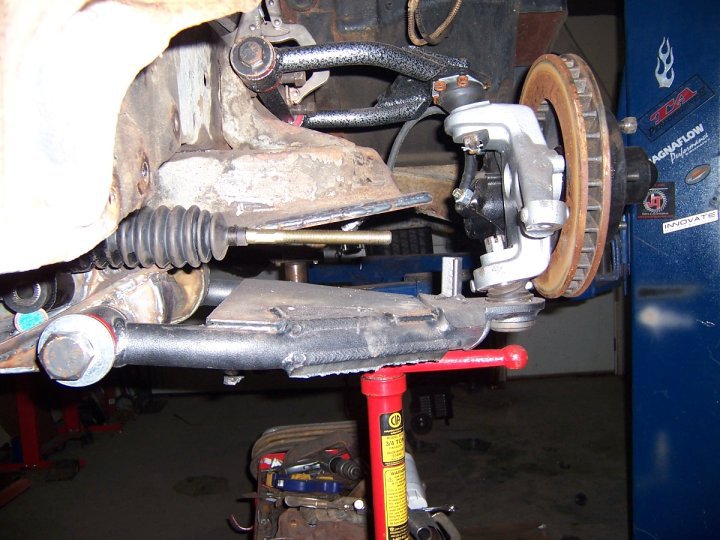

I have a front cross member that is cut to fit a mustang rack and tubular control arms for that frame if you want them? I have the rack, the modified 2" drop knuckles (disk brake) and all that.
It wasn't low enough for me, so I went with Porterbuilt.
Would certainly free up some weight on the front end and probably give you better steering. It's pretty much been sitting in my shed for 3 years.

I would be real interested in that front end. I'll shoot you a PM shortly.
