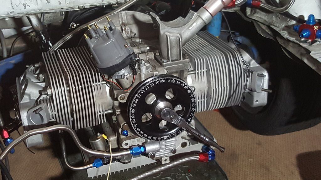

Oh lets say I've gone little stupid since the last post -- -- a complete tear down, inspection/R&R of the bearings, Corilla rods, J&E pistons, new gapless rings, heads completely redone (new porting, valves, springs, heat resistance coating on the inside, heat dispersement coating on the outside, blah blah blah), new 1.4 Pauter rockers, a couple of weeks in Italy for vacation and got all the parts and pieces back from the machine shops,,, and wah-la back together as a birthday present to me.... """Oh yes dear, it shouldn't cost more than a $100 to redo the engine,,,,, cough,,, cough ,,, choke, cough....."""
Ok --- I think I got the carb intake mocked up -- this engine is starting to have more colors than an Easter Egg -- --

I see you're using the Percy's Adjust-a-jet.
I hope you have better luck with it than I did. Have you tried one before?
I experienced major flooding with it.
  #24
Old 10-12-2016, 07:57 PM
Ghiaguy's Avatar
Ghiaguy Ghiaguy is offline
Join Date: Dec 2015
Posts: 50
Thanked 4 Times in 4 Posts
This is my second go with them -- the first time I really loved them
Percy's have really changed their product since the last set I bought in '09....
The kit comes with 2 little black seals/plugs that are not mentioned in the instructions.... They replace the original jets in the metering block, and if you didn't pick up on that, it would cause the problem you mentioned. And when I was assembling them, I felt that the adjust-a-jet block was REAL close to the Power Valve and might not be letting it seat (I'm thinking running a double gasket on the power valve might solve this if it becomes an issue).....
I'm kind of worried with this set as I'm running E85 and the Carb I'm using uses the dominator style plates ("regular" Holleys, the jets are flush in the metering block and the Dom's stick up about 1/8 of an inch)... And Percy doesn't make a Alcohol set for them... so these are setup for gas and I'll be twisting the screws out about 8 turns to start with (you can see how far out they are in the picture) and I think the max is 10 1/2 turns,,, so it will be close.
It was either this or stick a brand new set of metering blocks into a mill and shave off the jet bosses.... I wasn't too hot on that idea either...
But when/if they are working, they are great for making that quick "jet" change at the track...........
Good info!
Yeah, I tried them back in the late 90's and on the first test drive (without an air cleaner) the bottom of the hood got sprayed with fuel. LOL No plugs at all for the open holes where the jets used to go.
Thanks, and good luck, nice stuff there.

Engine is almost ready -- Just need to finish the MSD install -- I still hate crawling around the freaking cage to get to the back of the firewall LOL
I'm so over using steel braided line -- and E85 just eats them up -- I'm having to replace it almost every other year -- So now I'm using hard line when I have new installs or replacing old lines, I'm using either SS or Aluminum... AL is softer and easier to form and more forgiving than SS.....
