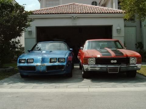

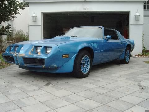

i havent posted about my car yet on here. all work has stoped since im going to college out of state but im 3months away from graduation!! and then its time to start putting it back together, the body needs quite a bit of attention but nothing i cant handle. here are a few pics of her...

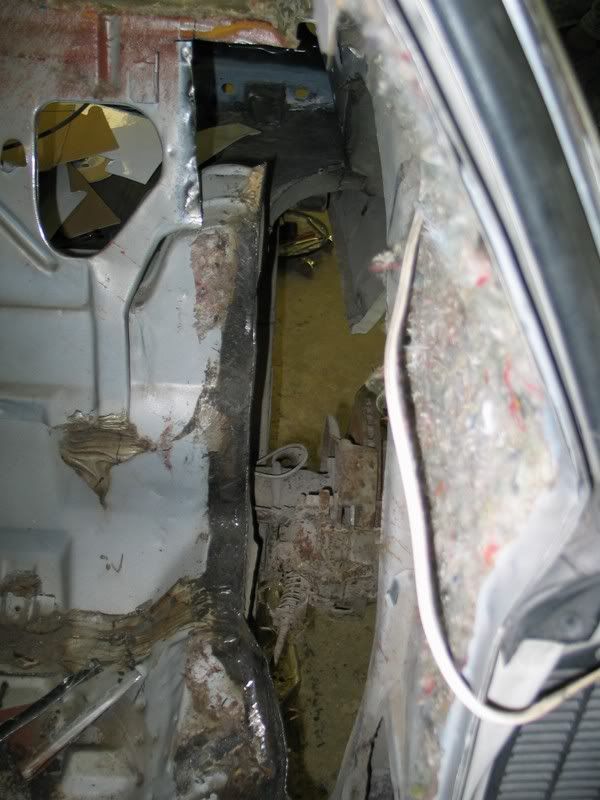

Here is another little update:
After getting the new rear frame rails build and the 4-link mocked up, it was time to tie the whole thing together.
Here is where we cut out the existing rails and part of the floor to make room for the new rear frame and the subframe connectors we fabricated.
As I mentioned, we built some subframe connectors:
But they did not work out, so it was a lot of wasted effort. I just am showing them here, since I may as well get something out of all that effort, right? Anyways, we ended up going with a plain piece of square tubing for the connecting section after these did not work out.

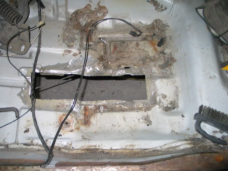

Ok, enough suspense, here are some more pics:
After cutting out the wheelwells for the Mini-tub, there wasnt much left to the back seat area, and it has a bunch of hole:
Since I am relocating the battery to the trunk and dont really want to run a battery box, and since we had gone so far anyways, I decided to replace the back panel with a piece of sheetmetal.
Also, the driveshaft loop from my new rear section was too high to fit in the factory tunnel. So I had to cut out the rear section of it as well.
Here is a shot of the the new rear floor pans and the new rear driveshaft tunnel area. Note you can also see the new frame rails running through the notch in the floor area:
