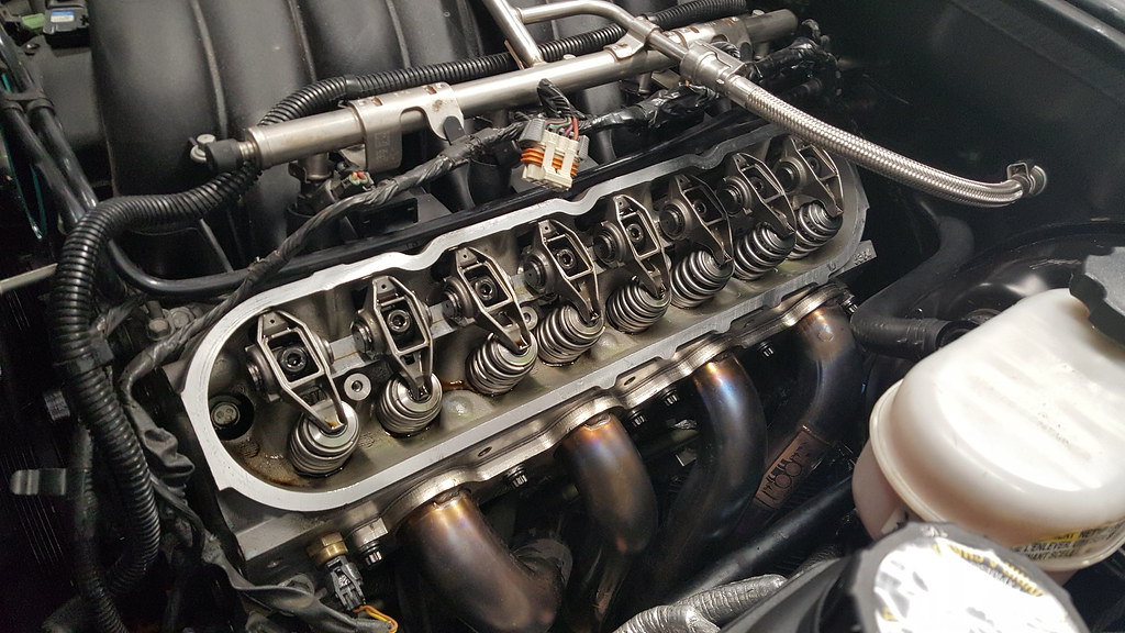

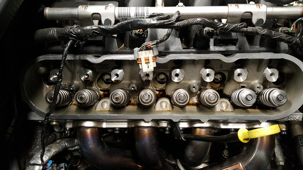

I finished up the the Valve spring upgrade on the Passenger side tonight - went well until the Valve Spring tool bolt started to strip out.
I don't know if I was tightening it too hard or what - but I was just using hand tools and the nut locked up on the threads and called them.
I ended up using a bunch of washers to cover up the stripped part - and I finished the side. I contacted the seller and he is sending me another bolt/nut.
I will start on the driver side when I get the replacement parts - now for a pic:

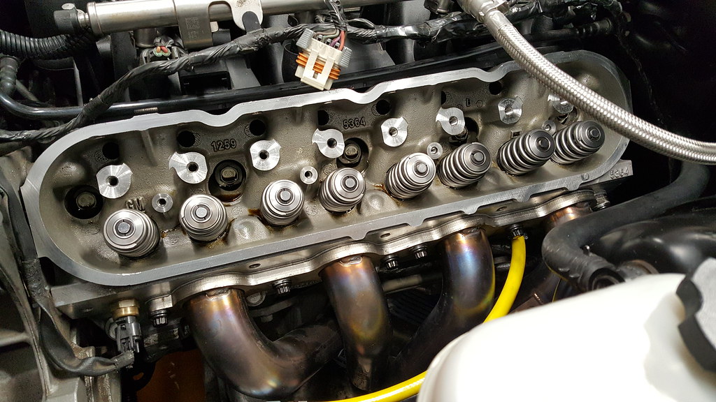

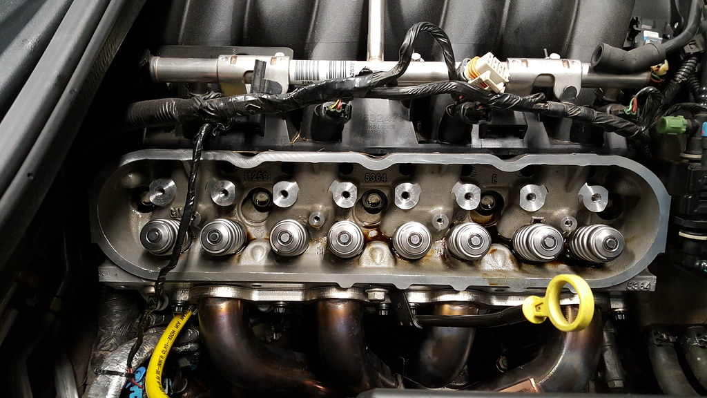

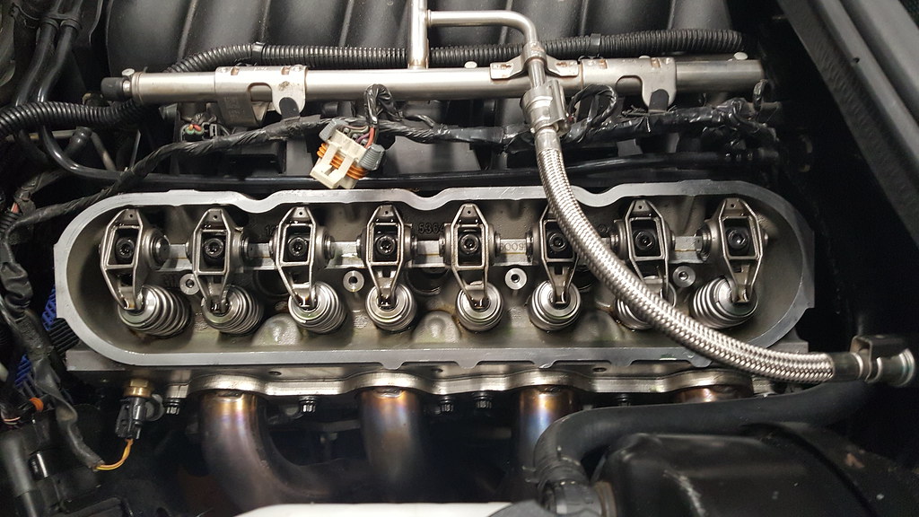

I finally completed a project!
I ran into missing parts, stripped bolt, bad manufacturing all on this Valve spring project.
I had 4 different orders/warranty items from Comp Cams - I ordered everything on Monday/Tuesday - and I got everything in 2 days.

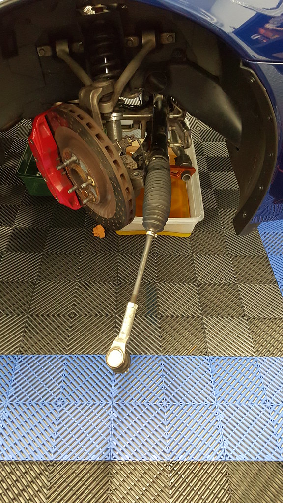

I finished up the valve springs on the drivers side - and I drained the radiator and pulled the water pump. The steering rack is halfway out. Once I get the PS pump and bracket off the front of the engine - I'll be able to finish pulling the rack. Then I can replace the front seals, pin the crank, and install my ARP crank pulley bolt. Hopefully I'll get some of that done this weekend.

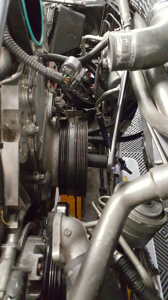

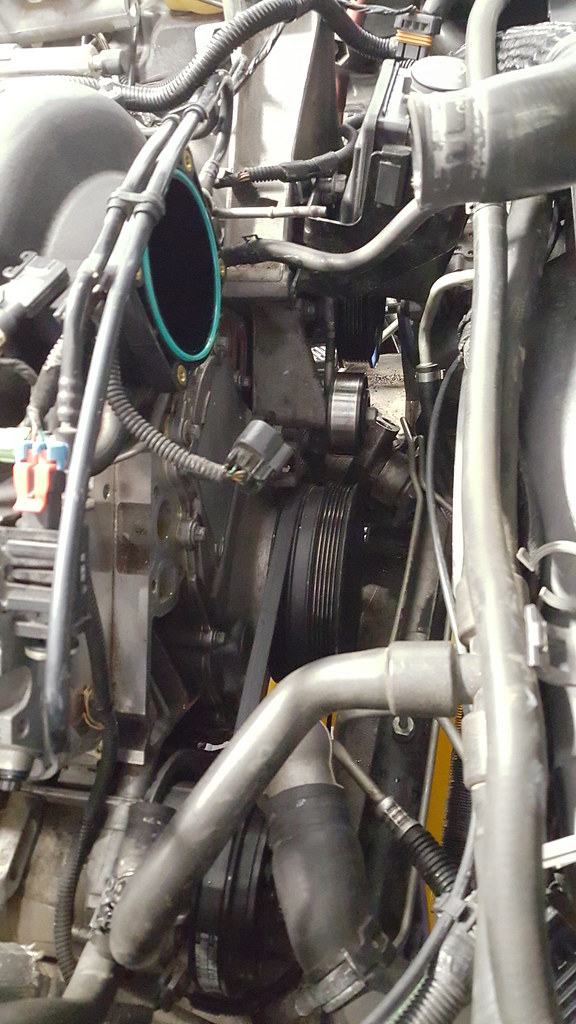

Quick update - I got the power steering pump, and the alternator bracket off of the car - this gave me the room to swing the steering rack out of the way.
Now I can get the crank pulley off - and finally replace that leaking front timing cover gasket. I will also spin the motor over to tighten the rocker arms and pushrods down.

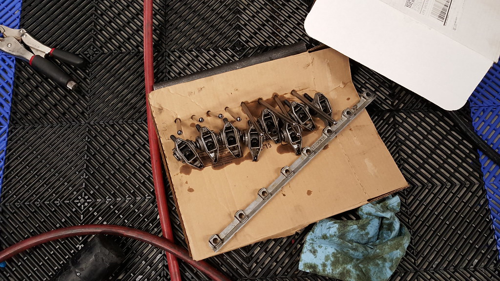

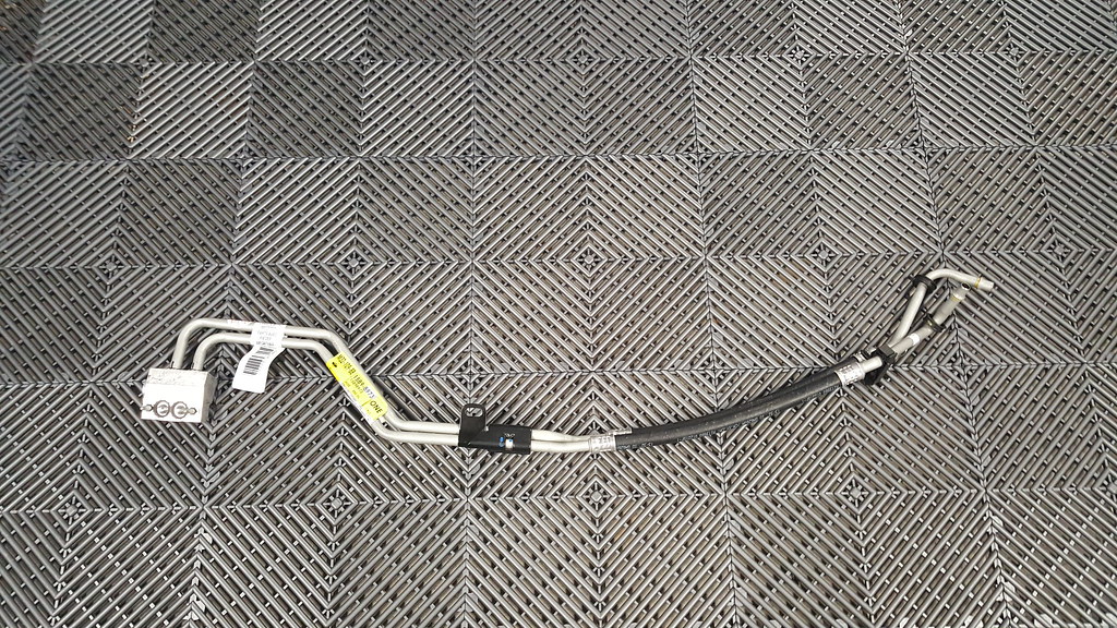

I got the valve train put back together. The pushrods put back in, the rocker arms torqued down. I also got the crank pulley bolt out, and my oil cooler lines finally arrived.
Next will be the crank pulley removal, gaskets replacement, pin the crank and then install the new oil cooler lines.

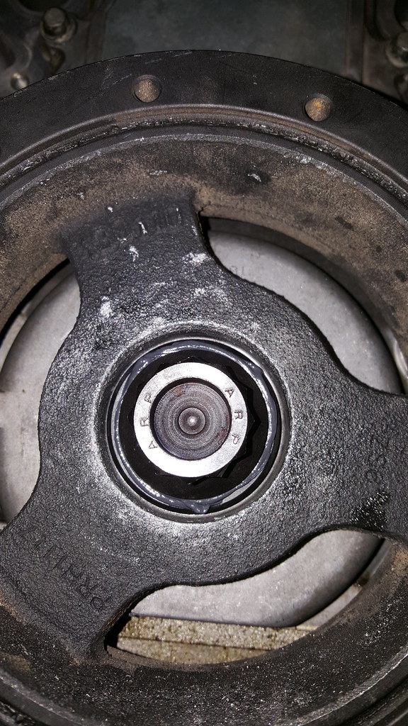

Yesterday I got the crank pulley off, pulled the front timing cover.
I then put new seals and gaskets on the timing cover and put it back together.

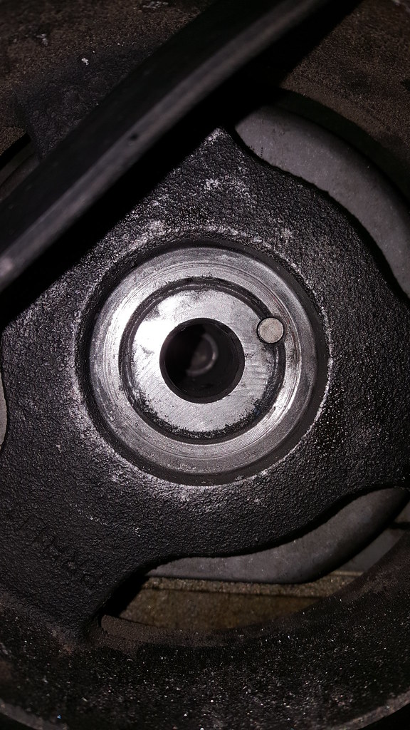

Tonight I torqued the crank pulley bolt - then removed it.
I used the Edelbrock pinning kit to drill into the crank, and then bore out the hole with the reaming tool.
I cleaned up the holes - and inserted the pin.
I then used my ARP crank bolt - lubed it up - and torqued it down.
I am finally done with this round of mods - time to start putting everything back together.
