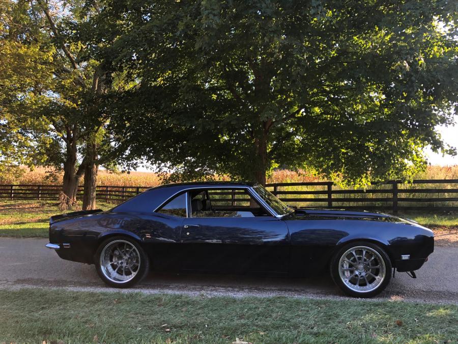

Had a great time at Holley LS Fest last weekend. I didn't realize there were limited spots for the autocross so I missed out on that, however, it was still a blast with perfect weather and great scenery. Couldn't help but snap a few shots...
