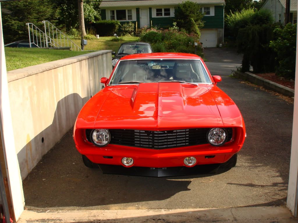

Made a bit of progress sorting this car out. Had to re-shim the hydraulic throw out bearing since it was barely disengaging and grabing right off the floor. Had to pull the trans to do it, no fun there. So while the exhaust was out, I got rid of the big rubber bands that magnaflow delivers to hang the mufflers. Replaced them with some nice stainlessworks hangers and those blue isolator thingy's. Amazing how much more secure the system is now. The clutch grabs closer to the middle of the pedal travel too, feels much nicer. Also installed a front spoiler, finishes off the nose. Heres a few car porn pics.
Rich

Old 08-05-2011, 04:32 PM
War's Avatar
War War is offline
Join Date: Oct 2008
Location: Oakdale,CA
Posts: 383
Wow! Nice job Rich. How do you like the Magnaflows?
