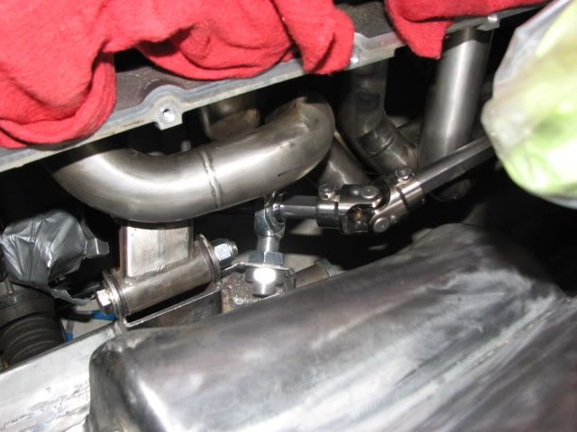

Steering column mock up... of course I had to take my $65 billet mount and cut it to fit the dash opening....its always fun to cut up brand new stuff
Vintage Air bulkhead mounted in the fenderwell so I can hide everything

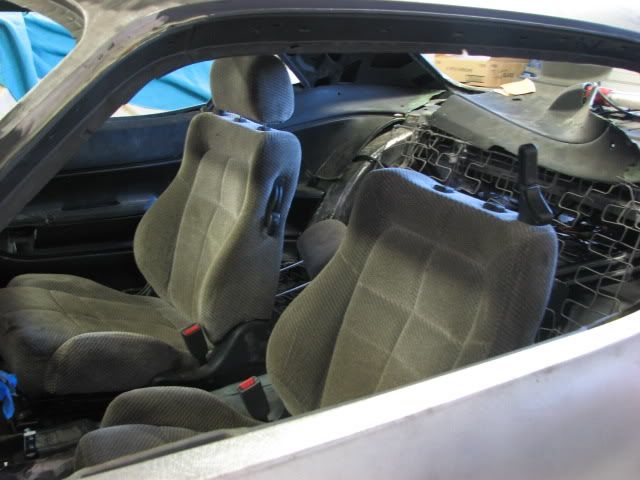

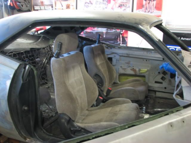

Once again, Tim has been doing spectacular work. I couldnt be happier. Both TJ and Tim have been great to work with on every level. After the quarter panel issue came to light, my enthusiasum for the car took a huge downturn and my concern with my budget became a big issue. At that point I was pretty freaked out that my dream and my budget were both going in the toilet. Needlsess to say, I wasnt exactly the easiest customer to deal with..... Despite being a PITA and getting anal about my $$, they were complete professionals and we worked things out. These guys have helped me out immensly and I will be eternally greatful. They are not only great craftsman, but great people.
I want to whole heartedly thank both Tim and TJ...... they have seen my dream car circle the drain and my emtions go up and down about this car. As a smaller shop, they dont have the luxury of dontaing much of their time to help guys like me. They cant just throw a couple of employees at a "feel sorry for you case" like me, and still be making $$ and paying bills with other projects at the same time. When they donate their time, they arent making any $$ for the shop at all. Despite that, they are doing the new quarter panel install for free, in order to help me keep my project going in the direction I dreamed of. I cant express my gratitude enough....... Thank you
I also want to thank Mike at Musclerodz again...once again he stepped up and helped out with getting me a new quarter panel. Thank you...
So....on with the update...
The innder fenders are all done and turned out awesome......
Ron Davis radiator all mounted up...Tim re-did the front rad support and moved the mounts outward so I could get a bigger radiator in there
