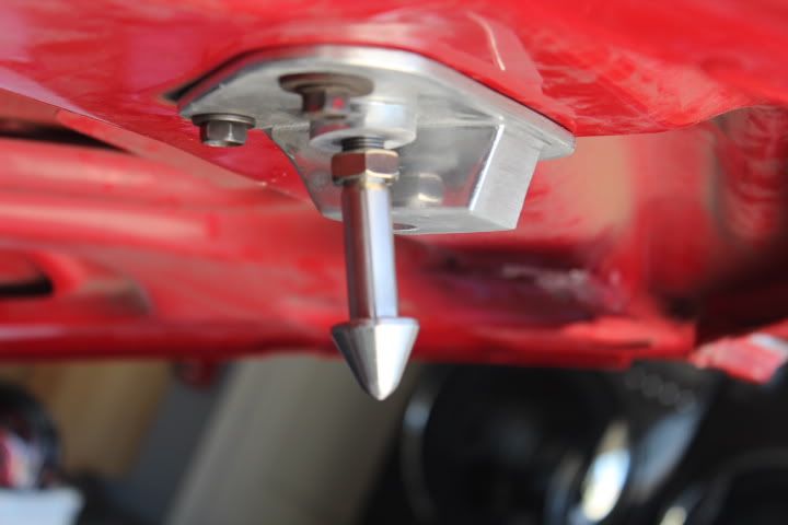

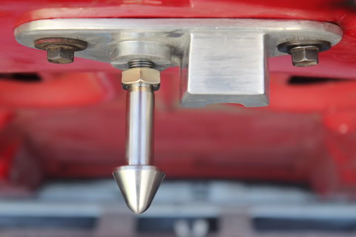

heres the last pics on the closeout. other than some smoothing and paint, its done. i got the hook done, and although it sits higher than i want it works really well. i had to balance being able to get my hand in to unlatch it with trying to make it as short as possible. luckly i have huge hands..... i was able to unlatch the pin and put ~100lbs of pull on the hood and it didnt budge. forces at speed are insane, but i think it will be sufficent. you can also see how i shaved down the part that holds the hook. i took 3/4" off and it works really well.
next up is finishing the front bumper. still need to get it cut to the correct angle for the grille. i'll finish it off with some 1/4" round bar on the lip to make it nice and smooth. i also need to get the inserts mounted. after the bumper i will start working on the front inner fenders.
