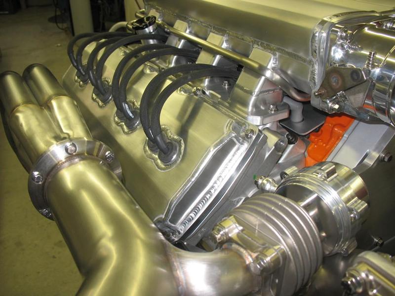

Tim does have a set of fabricated covers.

he made fabbed ones first, then he macined a set.
I did the CAD work. Someone else machined them.

That's what I'm talking about! I love those covers. I would like to see some of these available to the Hemi guys. I'm not all about the billet (not sure why, just not feeling them), but these are awesome!!! I wonder if Tim would be willing to build any more???

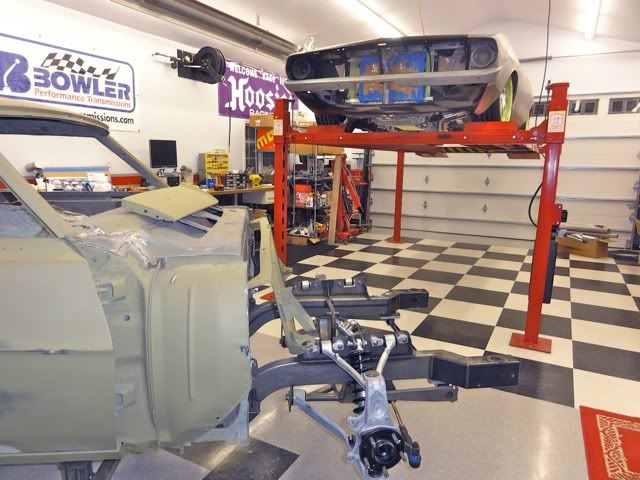

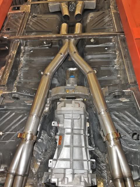

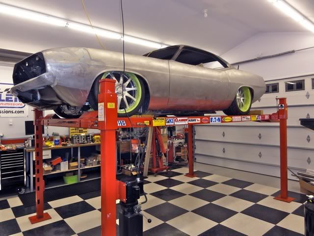

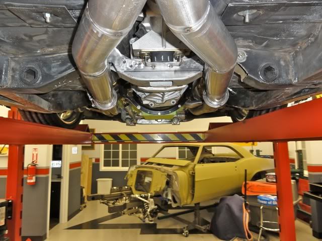

Well.....finally some updates.... alot has happende over the last 8 months....just havent got around to posting anything....then I got side tracked getting the Camaro back on the road and havent messed with the Cuda in almost 4 months.
So...... took the car over to Rob's house to fab up the exhaust. Since he has a lift in his shop we figured it would be way easier than working up on jackstands...and it was. Even up on a lift, it was a PITA. Big thanks to Rob for taking time away from his family and his own project, to help me out
The exhaust turned out pretty damn good for some first time exhaust builders. I bought quite a few bends from Columbia River, and I decided on the Spintech Sportsman 3000F mufflers.....hope they arent too loud The pipes are a tad off center in the tunnel but its pretty damn close.
