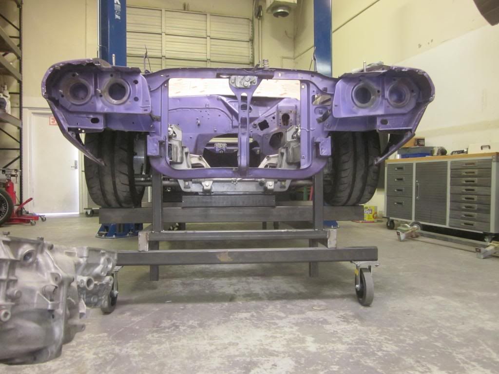

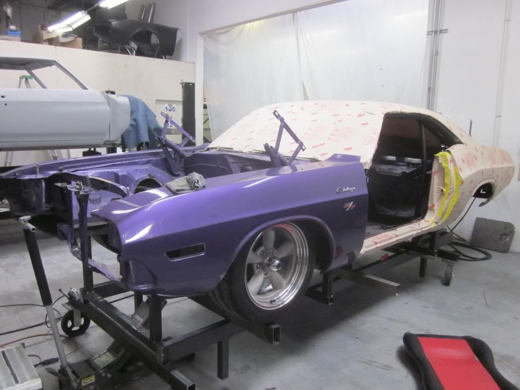

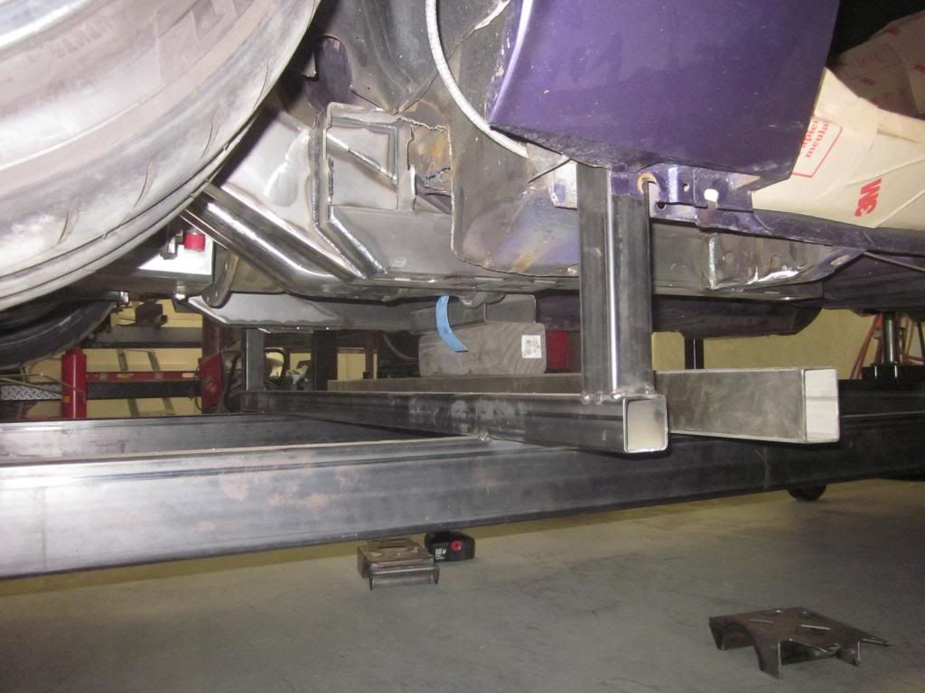

We just started this project Monday.. The car has been lingering here @ the shop for a few months putting a plan together for it.. Last Saturday I drove it 2 the SoCal Challenge & now is in pcs ready for upgrades…

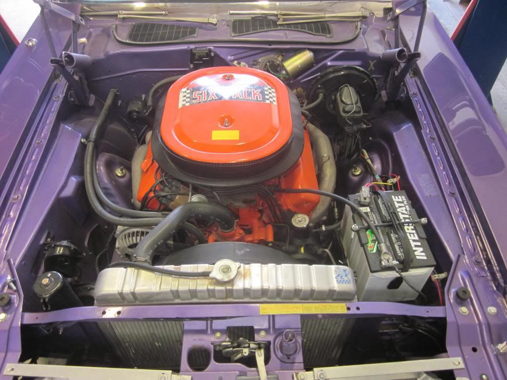

Car was an original 440 6 Pack, 4 speed, Dana 60 Car…
Carter Hickman has a concept for us…

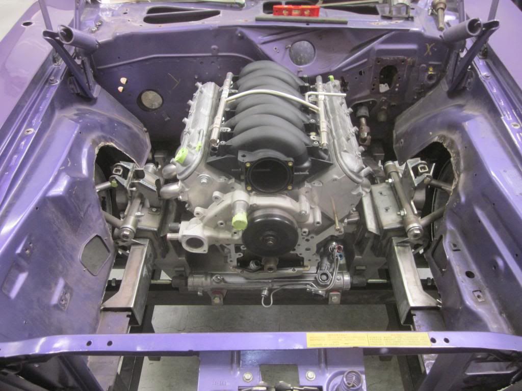

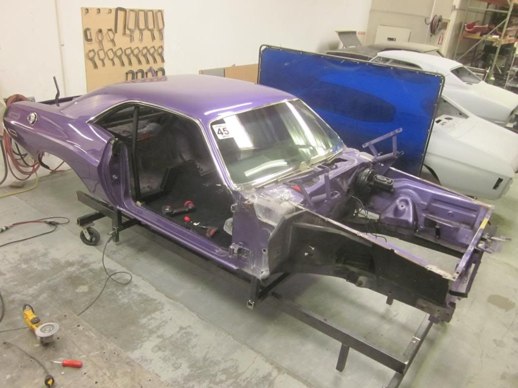

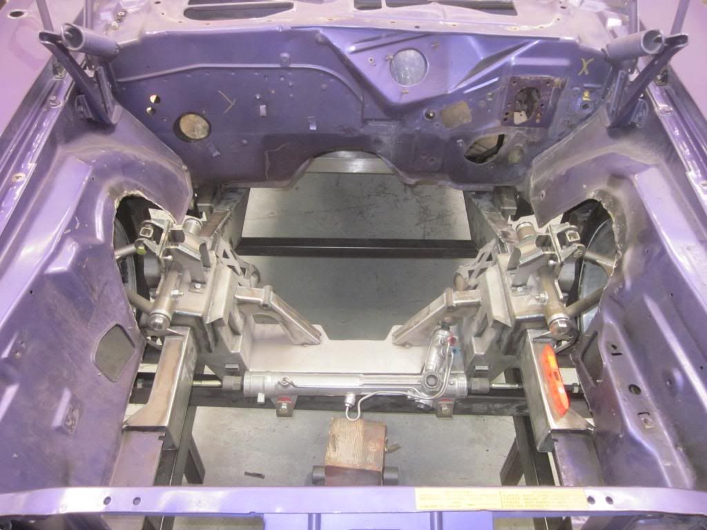

The first step was putting it on a jig & cutting out the existing frame rails… We measured the JCG 67-69 Camaro Sub-Frame with ride height & it was a close enough match… The grafting of the sub-frame is going pretty smooth..

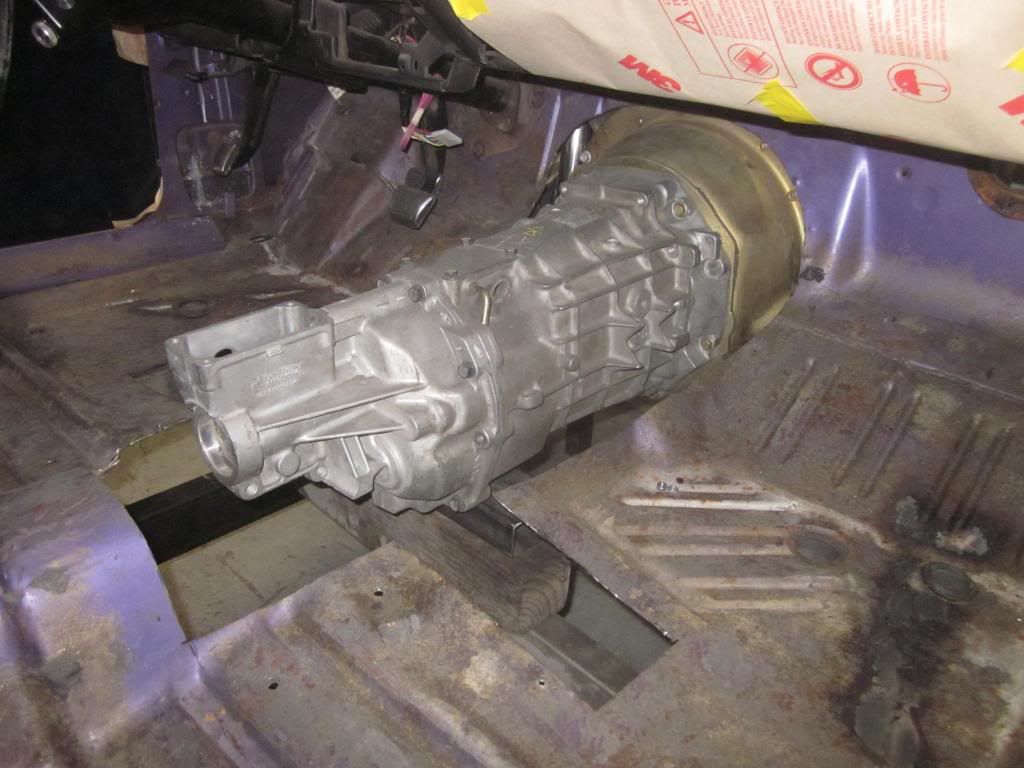

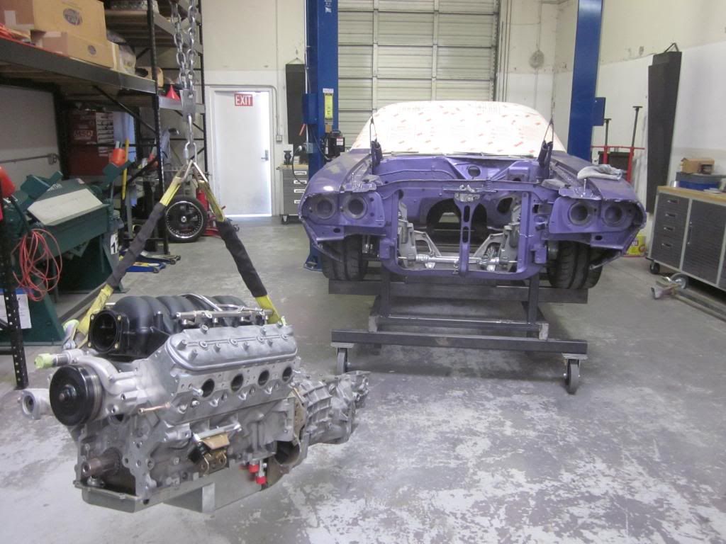

Engine choice! LS Mast Motorsports 416 with RPM Road Race transmission.. C&R 9” Ford third member… I know a lot of guys are not gonna like what we are doing their.. But you can't beat the HP & packaging from a LS engine.. It is gonna be pretty damm cool showing up to LS Fest in this car…

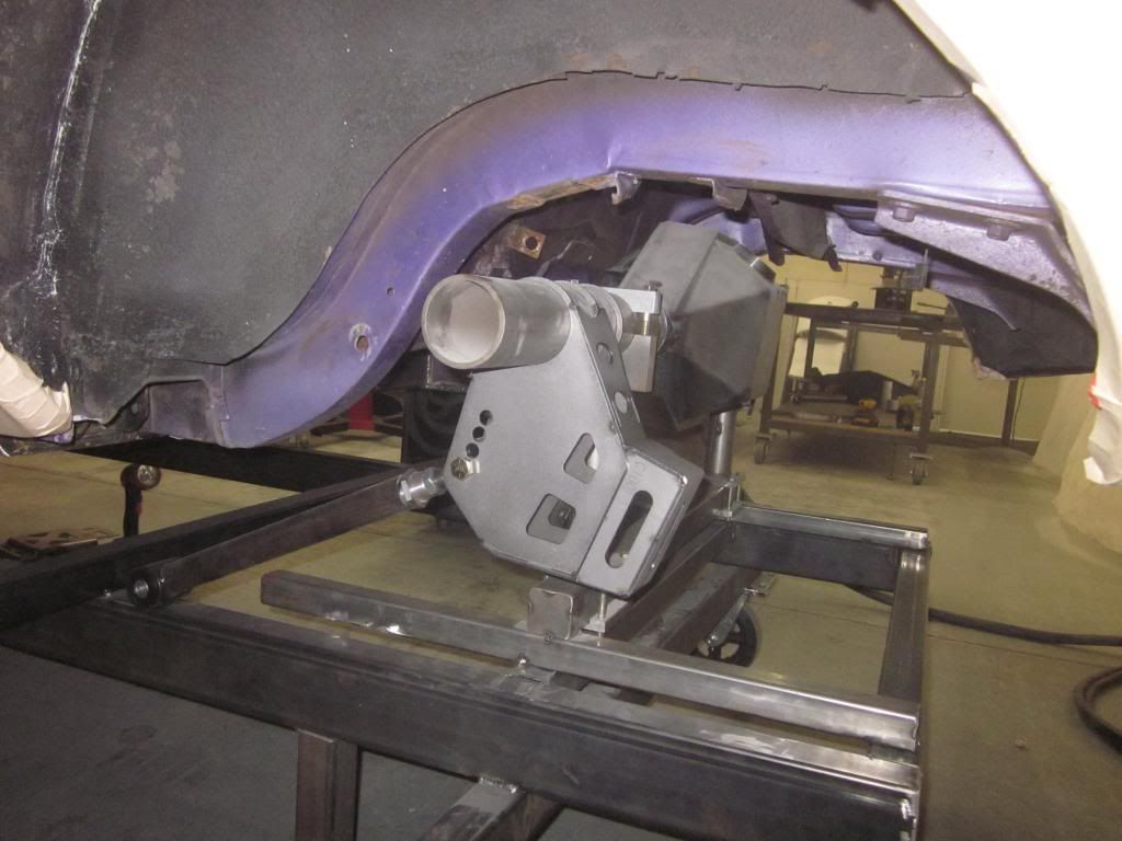

Using a GMR 9” Ford Housing with JCG 3 Link rear suspension.. Tomorrow we design the shock mounts with top link mounting point…
More Progress Pics Next Friday!
Cris Gonzalez

I love the rendering! Can't wait to hear all the Mopar guys whine about the hot little Mast motor you have in this machine. What oil pan are you running on this motor, it looks like a sheetmetal pan?

Josh- We are on a fast pace to get this car on the road.. I have a completion date in my head that I would like for this car to be completed.. The car will be a down & dirty re-do.. Nothing fancy.. just upgrades to do some testing of JCG components..
Oil pan is ATS pan that we used for mock up..
I knew the drivetrain choice for this car was not going to be popular.. but I had a pile of parts sitting in corner of the shop that I pulled out of 2007 Mustang that needed a new home.. Primary goal for this car is to test & race the crap out of it.. & have some fun..
If time permits & can find somebody to let me borrow a late model Hemi Engine.. I will fit it between the frame rails to see how it fits..

For the last two months this car has been put thru the test.. Attending as many open track events that I can plus doing some Auto-X events.. Car now has about 2500 miles on it with half of those being very hard track miles.. Car is working great... Making adjustments & changes as I learn what the car likes.. Gear changes, tires, brake ducting, completed the interior, & the list goes on..
Next phase for the car is to pull motor & make some changes.. Ditching the manual brakes.. going with Master cylinder & booster from a 2008 Z06 Corvette.. Get the car ready for USCA event in Fontana & then headed to the Mid-West for some events out there..
