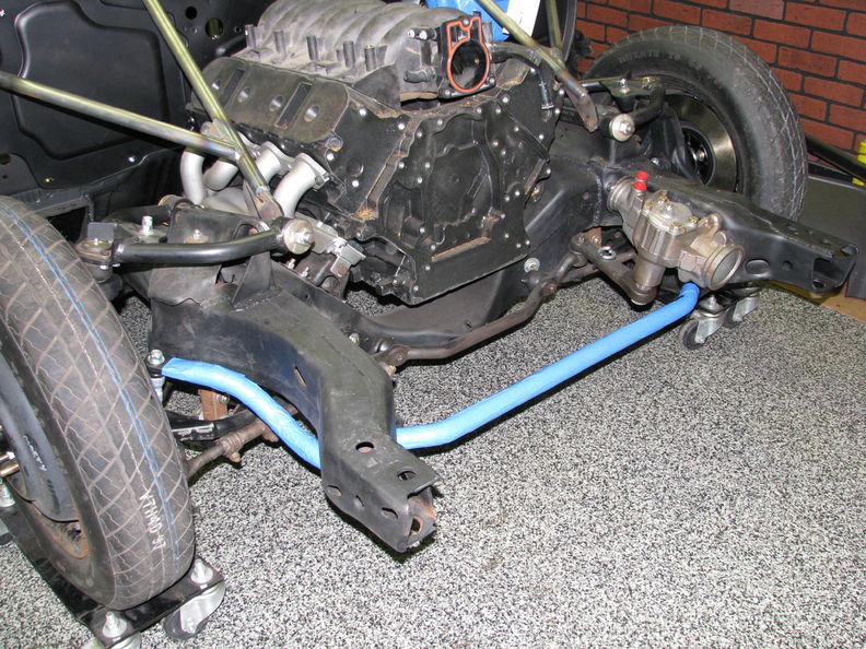

2nd Chance Camaro - Ride Tech Muscle Bar
2012 07-04 Update - Ride Tech Muscle Bar
www.2ndchancecamaro.com

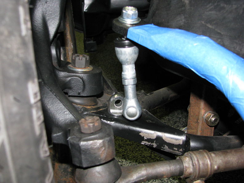

Afternoon All,
People tend to think that they can handle a complete subframe swap. Then in the middle of the project they realize they have
either run out of money, time or skill to finish the project. As said in previous post the build of this car needs to be simple and
something that anyone can do. That is why Ride Tech is my first choice and always will be. Their product is proven and if you
can do simple remove and replace you are going to be unbelievable happy with all of the products offered by them.
Time to install the Ride Tech Muscle bar.
30 minutes later the bar is installed.
If your goal is to build you car in your garage or your driveway and not make it yard art then step up to Ride-Tech !!!!

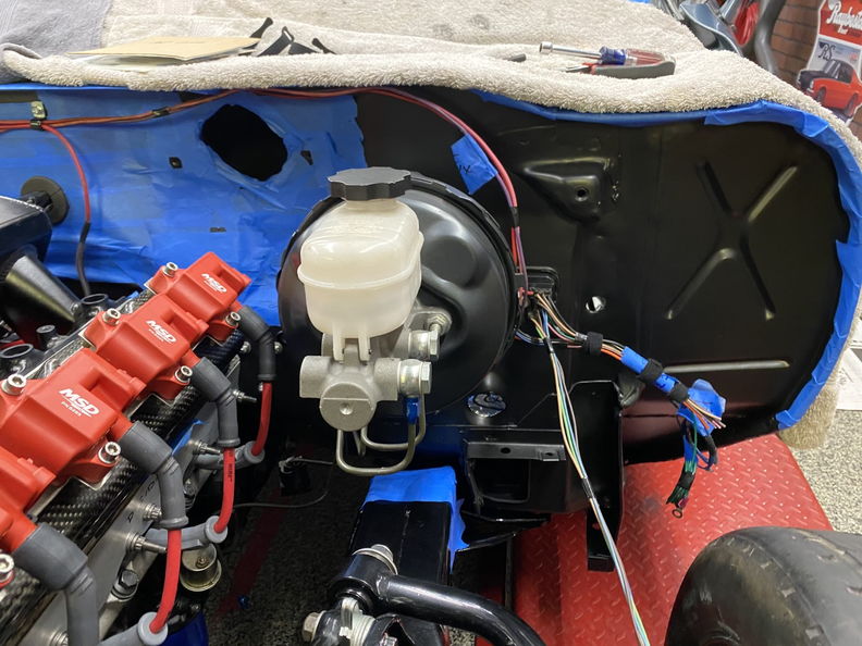

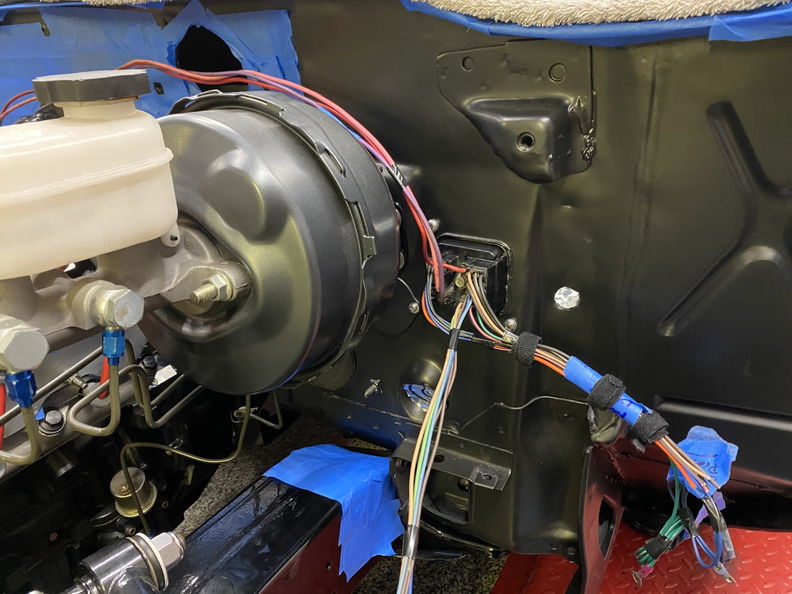

Good Evening All,
It's very important to mock everything up before paint and final assembly. The perfect example is what happened when I installed
the Brake Booster. The angle is off even though this is the correct DSE part number for a 70 Camaro.
You can see that the hood won't close with the supplied bracket. So back on the phone with DSE to talk with Tech Support,
send some pictures and wait for a response & solution.
A few weeks later DSE has a solution and it's simple bracket swap. I like simple, especially when your trying to build a bolt-on
Camaro.
The new bracket part # 050302 if you need one.
Problem Solved - Thank you DSE
