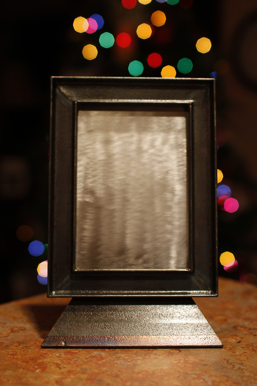

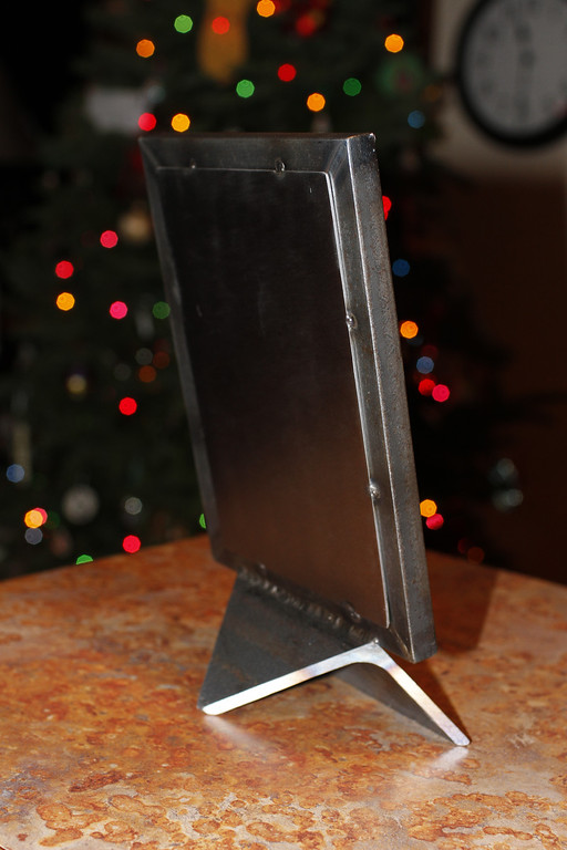

Another design completed........
That's very nice Sieg. You need to open up a side business selling rustic picture frames. Don't worry we'll pull you back before you turn in to that old guy with the white beard who wears a leather weldors apron 24/7 making wind chimes and lawn art in his drive way.

Sieg - What are you cutting your miters on now? They look to be pretty crisp...
My new cold cut saw is the shizzle on angles - easy to set up and cuts like butter - but you don't need one of those for this kind of work - you NEED that FEMI! HAHAHAHAHAAHAHAH
I'm using a Jet 68" horizontal dry cut. It's decent but slower to set up for miters and much slower cutting than I witnessed at SEMA. Accuracy on the vertical cuts could be better. I hand fit the miters using an 8" disc sanders.
Thanks, don't think I'll sport the blacksmith look....gunsmith has potential!
Before you know it the Chinese will be knocking him off and sending containers of 'em to WalMart!!
EEEEEEEEEEEEHHHHHHHHHAAAAAAAAA
Thanks to Chinese quality, the door is left ajar for this micro niche. Besides these are heavy enough to sink their container ships.

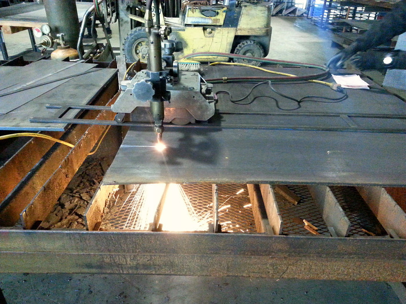

Went shopping today at one of my favorite stores.........
My new welding tabletop being cut.

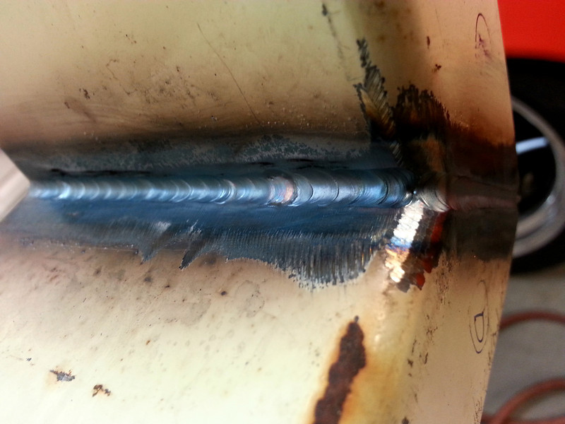

Semi-success with the TIG on 11 ga. 2x4 salvage material. Used 1/16" tungsten and filler, 17 cfh w/ gas lens, 110 amps
full pedal @ startup, then 85-90% estimated speed 12-15" minute.

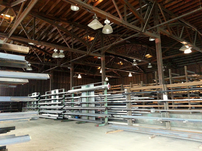

See those lights in the metal supply store? I'm removing all of those from my new shop and they're running all new banks of "high bay fluorescents"... 2.5 times the light and 1/4 the wattage.
Your welds look good buddy!
I love the smell of metal!

What! No high bay LEDs? Even less power and 50000 hour life!
J/K. I'm an electrical project manager and we install LEDs more and more for production facilities.
