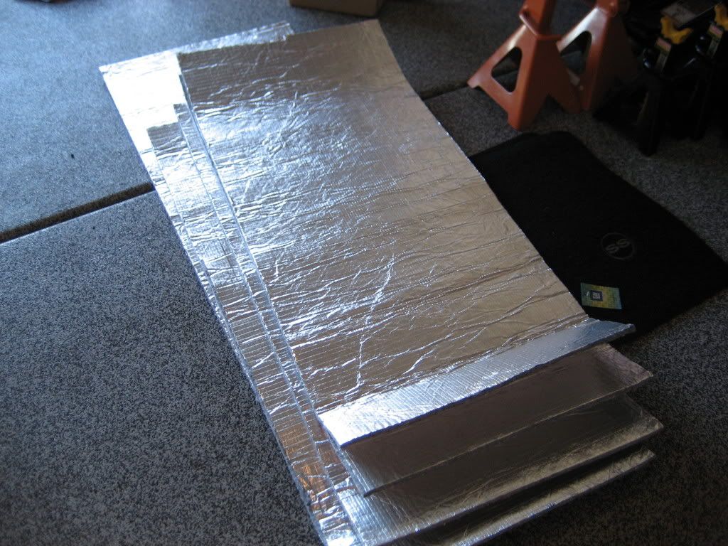

Well 600hp and 2 1/8 primaries makes some serious heat. The floors are coated inside and out, and I also have second skin dynapro or whatever they call it. The floor was still getting hot especially in the foot boards and tunnel. I decided to add a second layer of insulation. It's 3/8 inch thick with jute and foil on both sides. The whole floor and tunnel is done. I built up the rear floor pans to be even as they would be from the factory. Since I have the DSE connectors it puts a nice hump in the floor pan for the carpet. I then taped it all with aluminized heat tape.
I am also going to leave the jute on the carpet. Should be nice and cozy now. I already cut the carpet to short. I have a new set here.

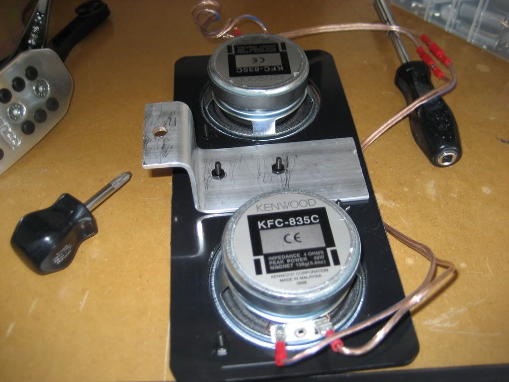

I am also running the factory setup in the dash, except for I opted for the kenwood upgrade. The bracket that came with it was so flimsy I decided to make my own.

Default The foil stuff lets plenty of heat through until
you put the juke and carpet over it...and then it will be nice and cool. I drove mine like that for a while and was dissapointed with how much heat came through.
