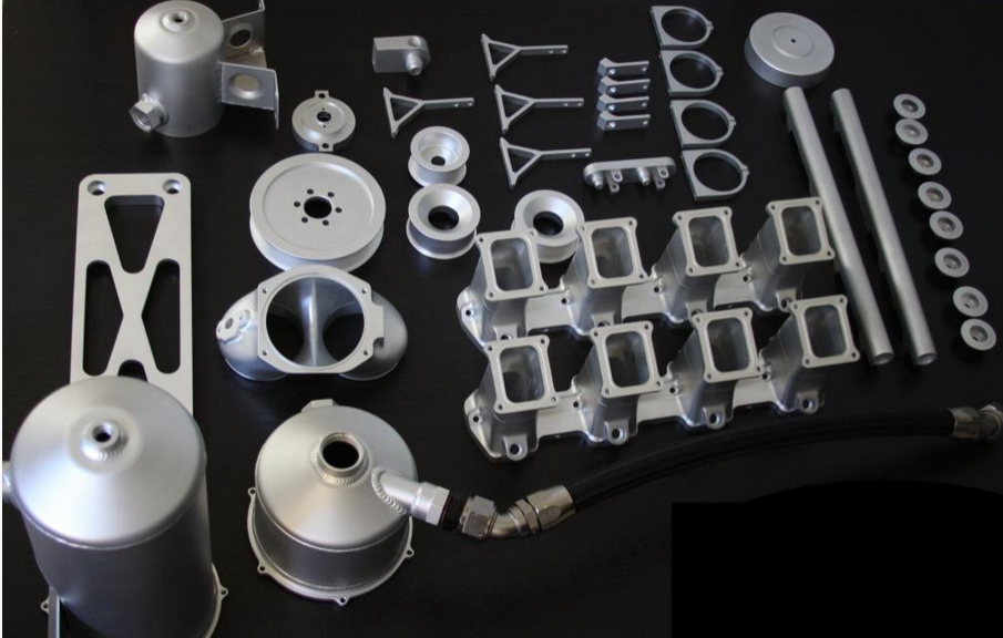

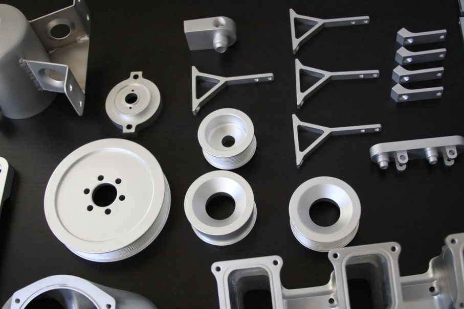

Every component in the engine bay was vapor blasted. This machine is about $30,000 but leave a finish that very fine.

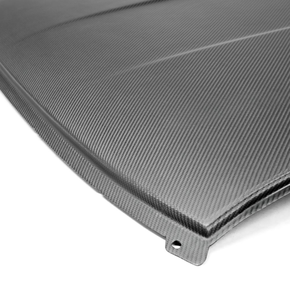

Most all the CF parts are in.
Doors will drop about 90 lbs.
We had these parts made for G5.R in dry carbon. Roof, hood and trunk will drop approx 40 plus lbs.
Since it wont have any headliner, you will see the weave when sitting in the car. Kinda cool.

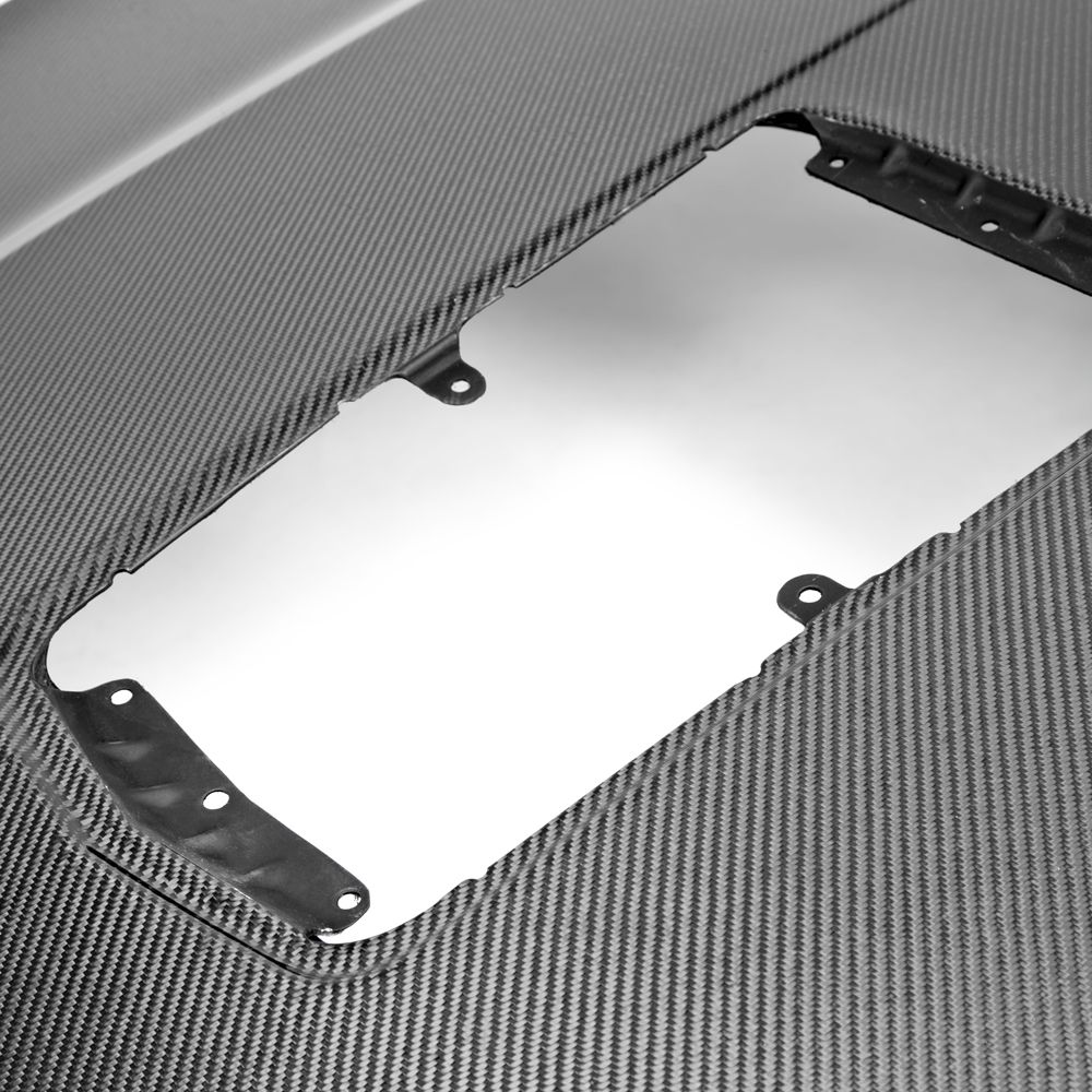

Dry carbon hood

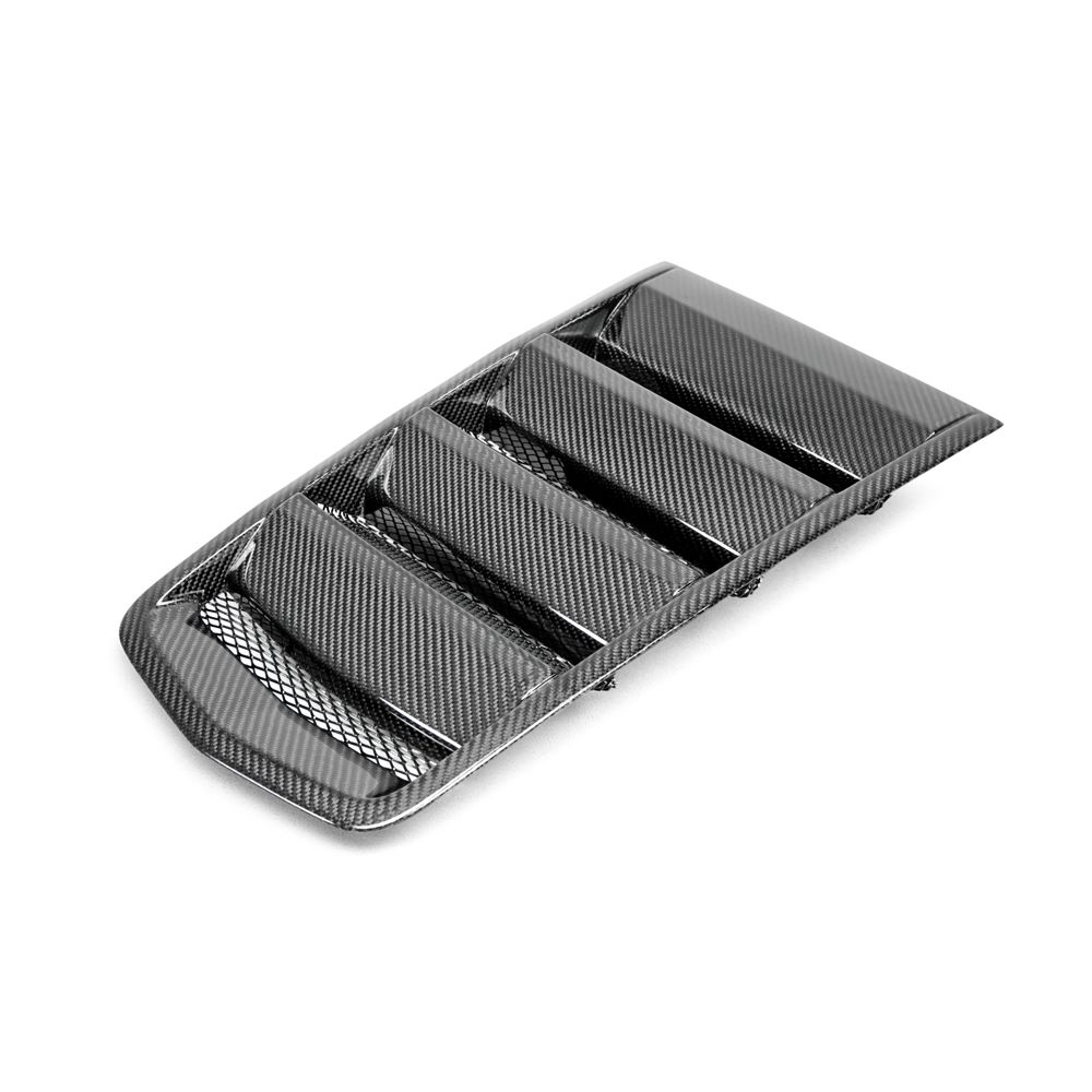

Hood vent
