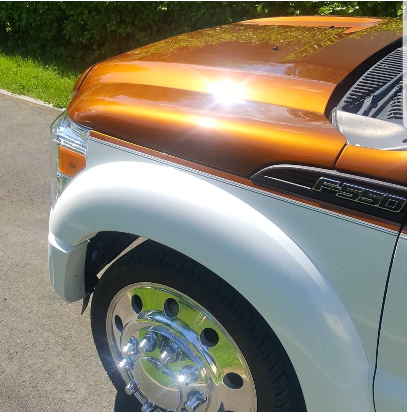

I'm definitely leaning towards the lighter to medium browns.
Check Audi special option color: Ipanema brown.
I painted my dually with that.
, Juhani
Pretty color for sure, but too bright for this old guy lol.

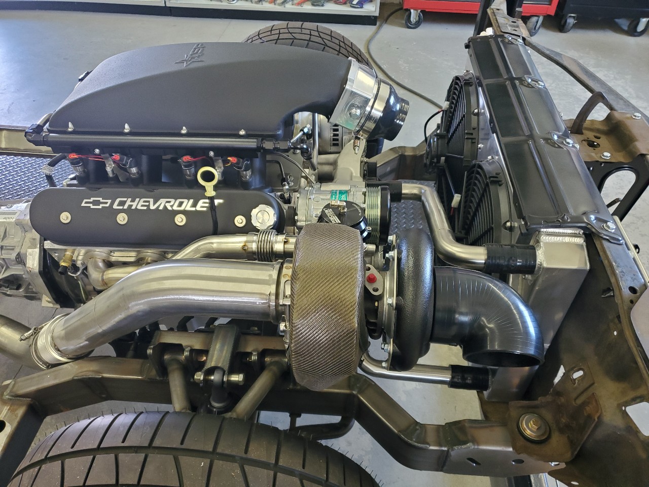

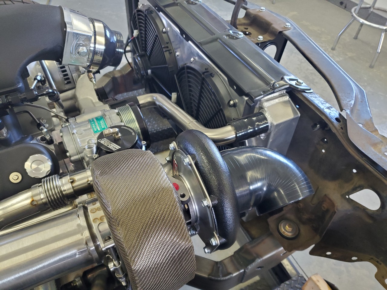

After seeing the black powdercoated Prochargers I decided to try it on the turbo. So far I like it. Might look for a little flatter black for a better match to the intake and valve covers, but it's close.

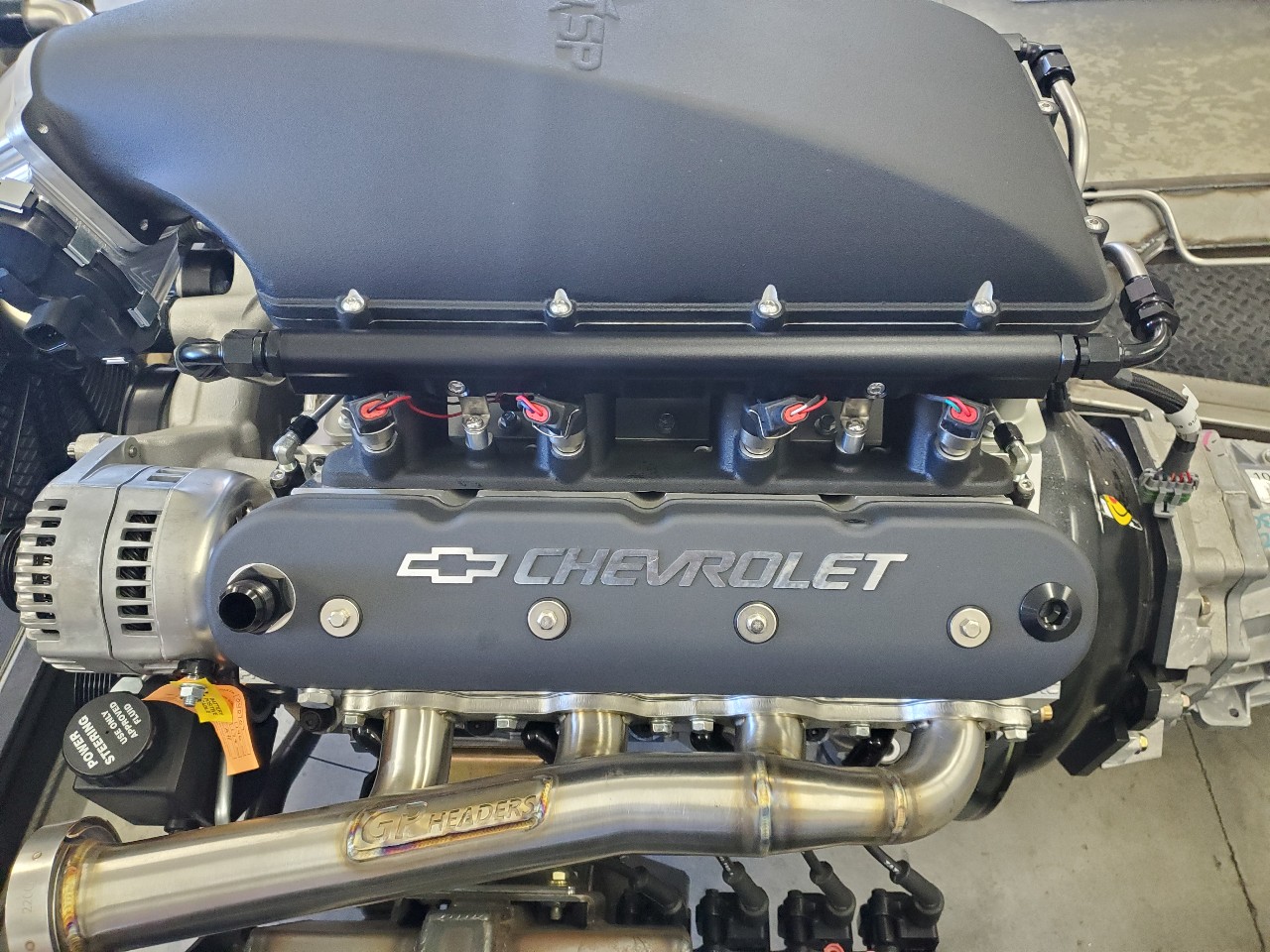

I changed my mind on the Mightmouse catch can routing, so now the fitting was on the wrong end of the valve covers. Since I needed the passenger side cover to stay on that side for easy access to the oil fill I was contemplating buying new valve covers. Fortunately I came up with an option I could live with, swapping a #12 ORB plug where the fitting used to be, and drilling the hole up front where it belongs.
