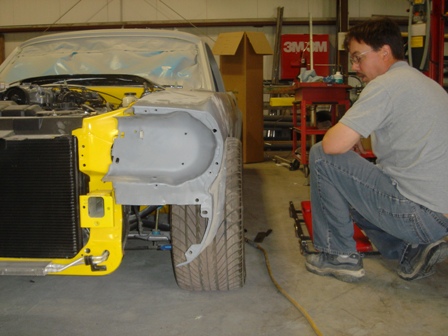

Wayne has been busy solving body fitment issues. Here are a couple of shots. The first is of Wayne hard at work. He is contemplating the gaps. If you listen closely you can hear the buzz as he thinks about the best way to even out all these inconsistent gaps. He has had to weld extensions on to some panels while trimming back others.
Shush. Be very quiet. We better move on before we disturb him. :-)

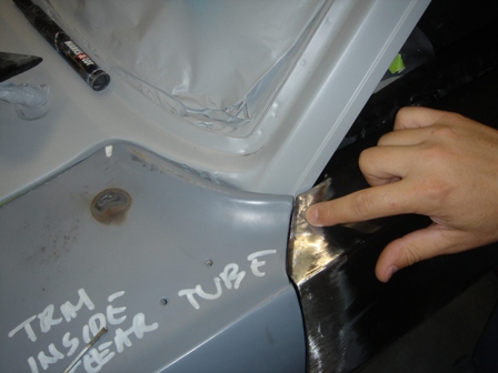

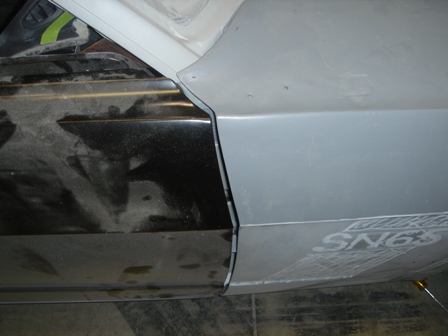

Next is a photo of what the gaps look like before Wayne works his magic. Compare that to the 4th shot showing the repaired gaps on the opposite side of the car.

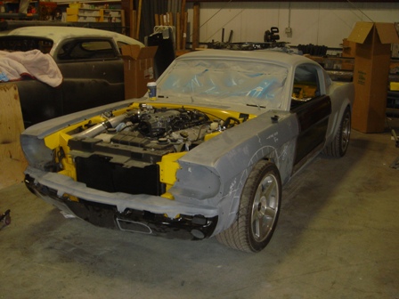

Last we have a shot of the car starting to go together for final bodywork. We are currently fitting / clearancing the hood (stock 65 with a bulge for the massive blown 4.6)
