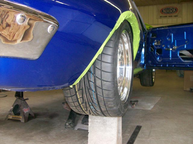

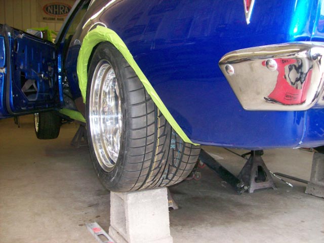

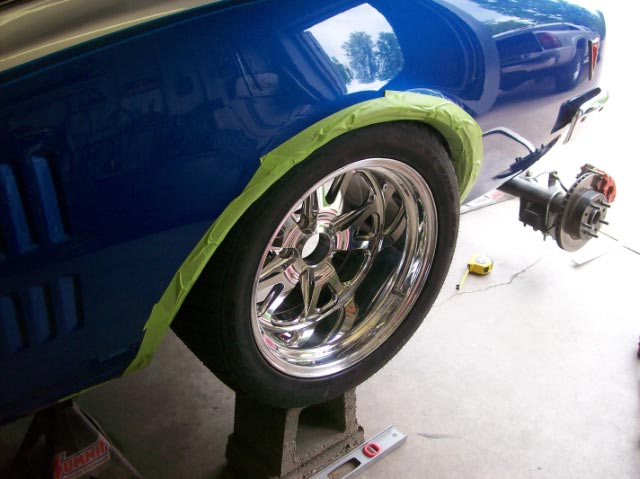

A few shots of the tire/wheel mock up. I had to order a new set of axles because the old ones would not really work out plus the new ones are stronger. I plan to have a set of wheel/tires set up for drag racing for summer of 09 so better to have the stronger axles.

do you have a pic of the rear wheel straight on?.. Heres why. My g bar lower control arms seem to be a 1 inch to short. I can not get the rear wheels centered in the opening. Tryed everything.

the g bar never allows the tire to be centered it is always forward in the rear wheel well.
should have made the link adjustable

If you don't mind me asking. How hard is it to modify the link to make it center the rear end in the wheel well? I might have to call Kurt tomorrow.

Thats just a picture of the wheels in the wells the rear end is sitting on the floor behind the car. I guess I will have to do some checking into that.
