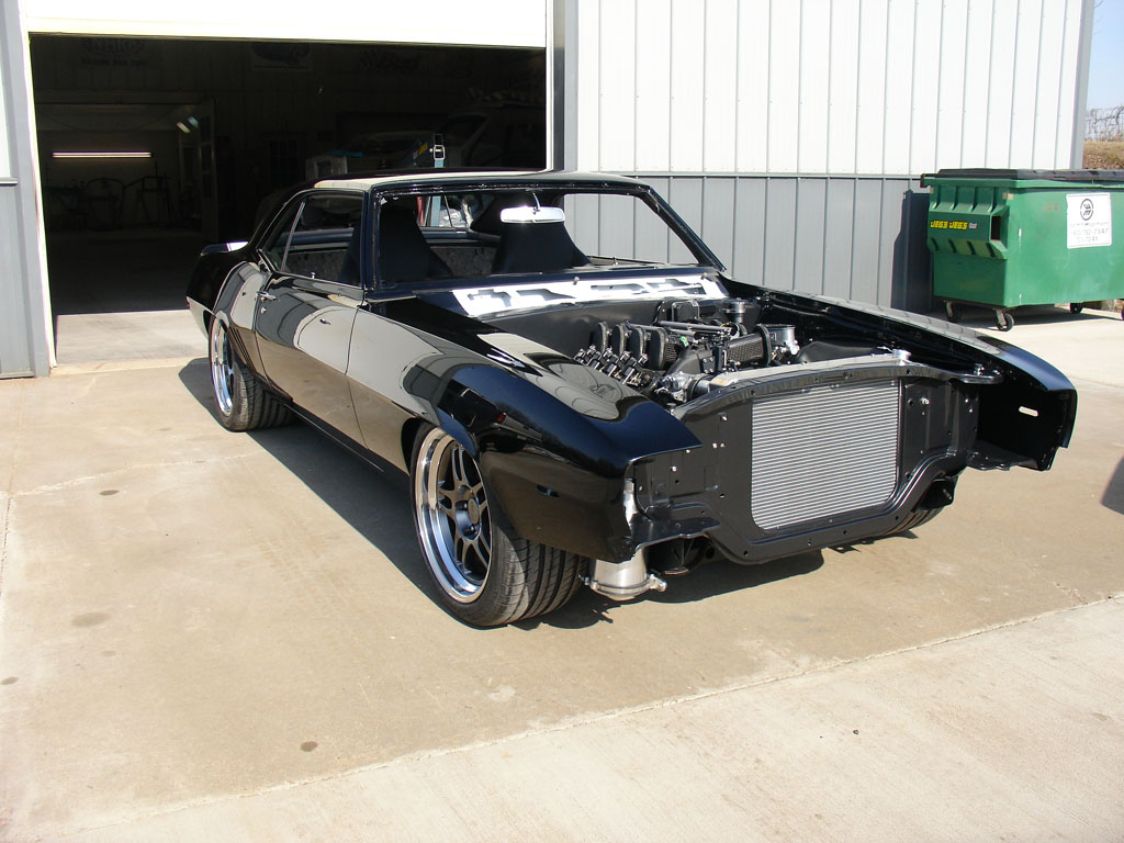

Yep, the car was bought from a member of the site.
Kurt is building it for a customer that doesn't get on here much at all.

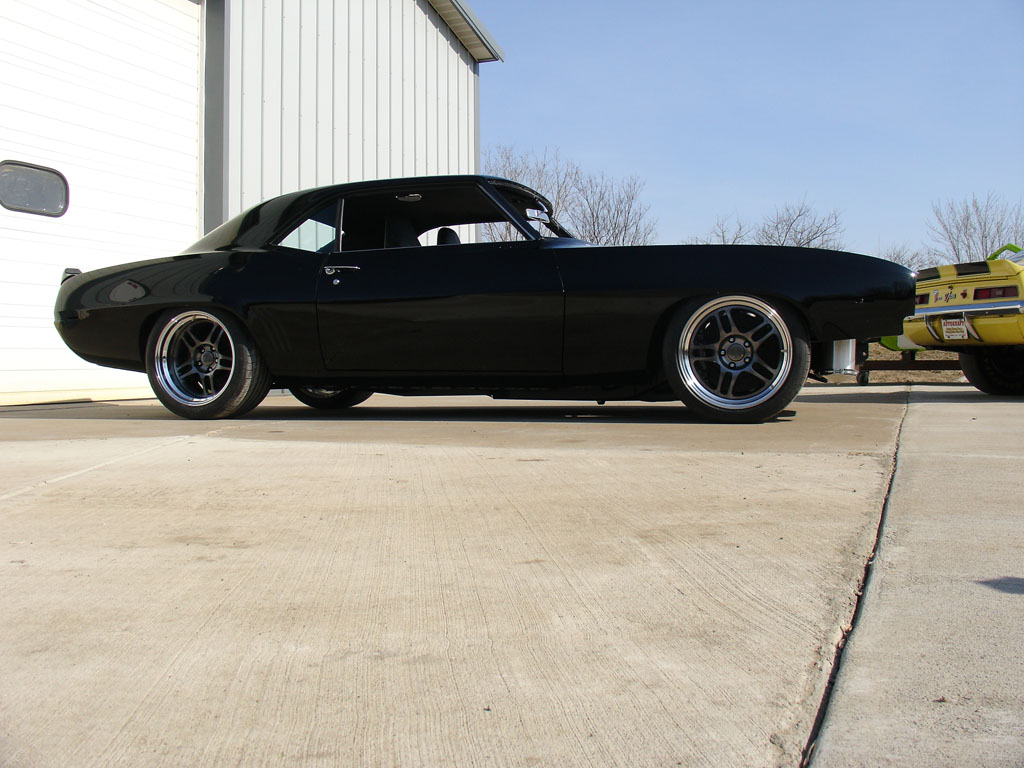

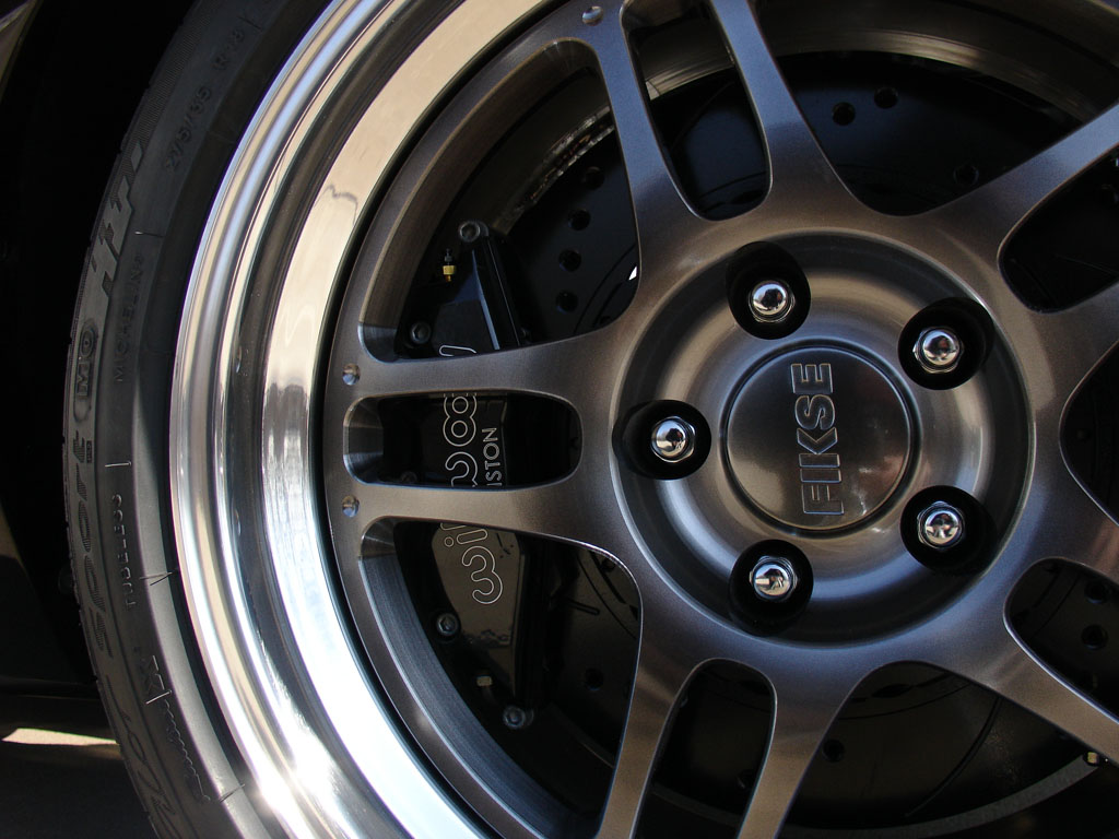

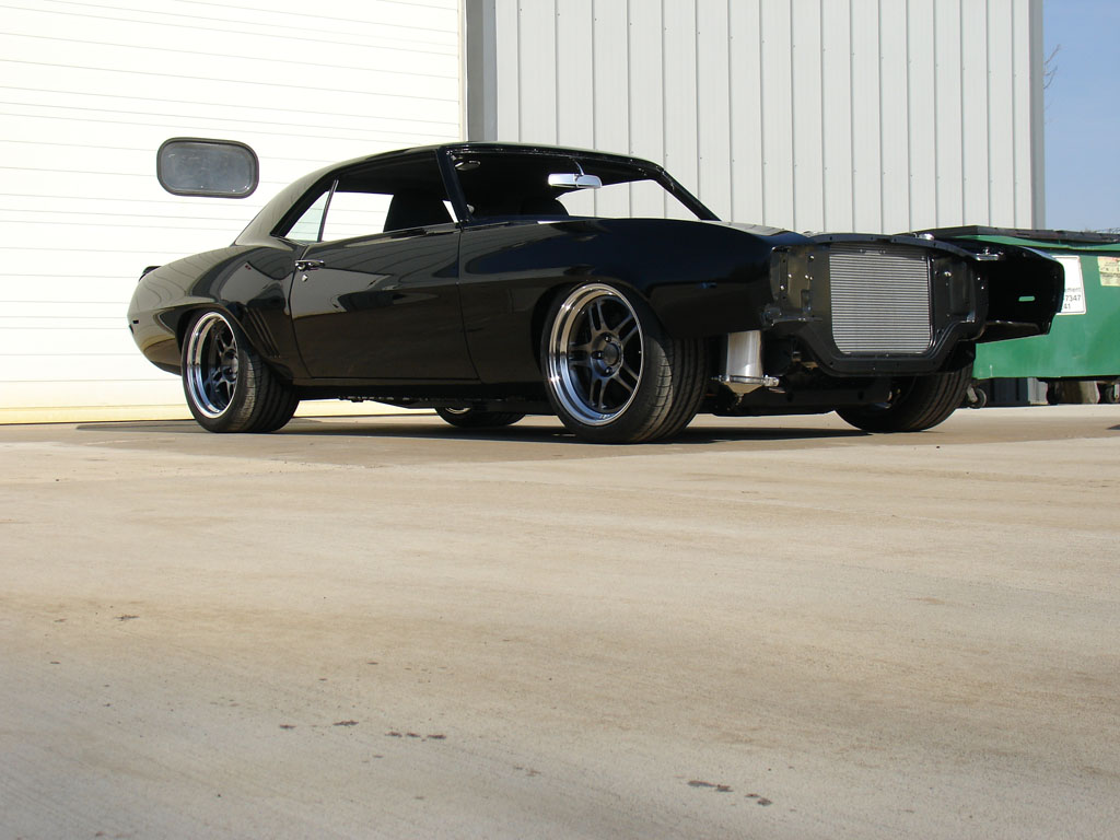

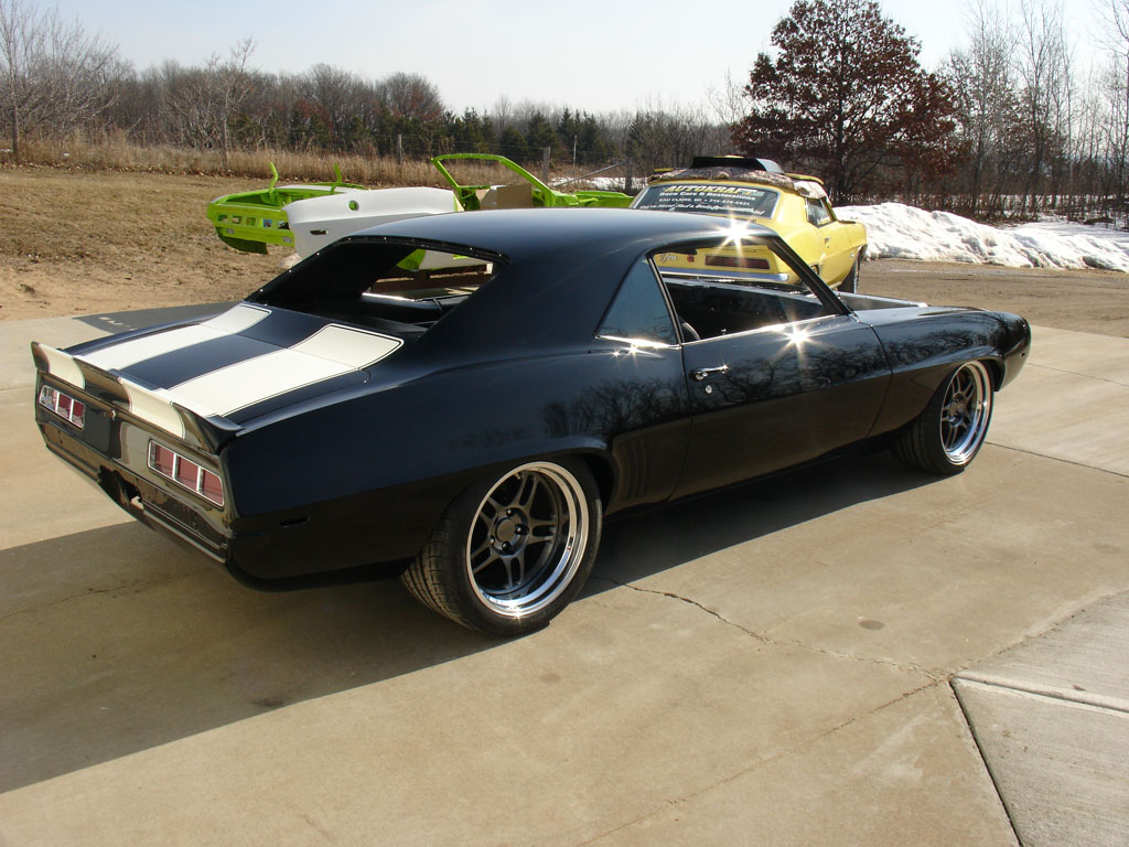

Hey Scott, what is the sizes and b.s. on those wheels? O and what other color options are you looking at? Looks GREAT! Those rear tires are HUGE! Look great on the car.

Tony, wheels sizes are rear 18x12 5.625bs and the fronts are 18x10 with a 6.125bs tires are 335/30/18 rear and 275/35/18 front

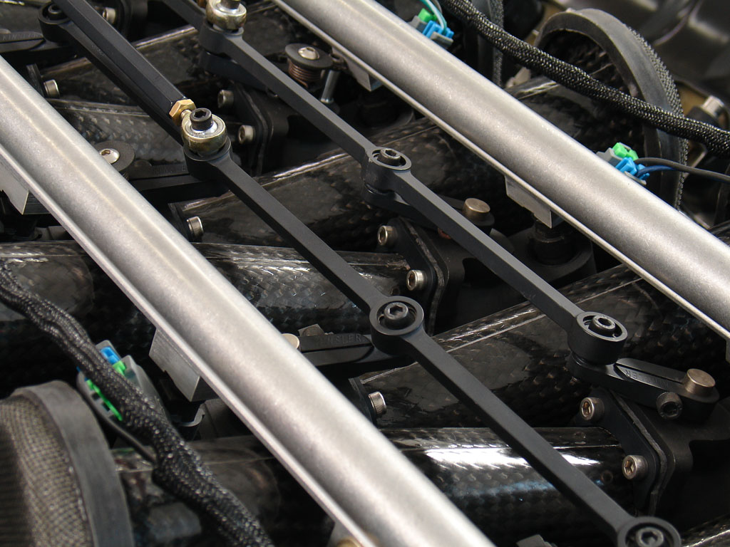

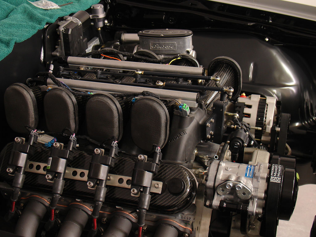

Wow I just got intake envy Thanks for posting Scott.
Very nice work Kurt very cool

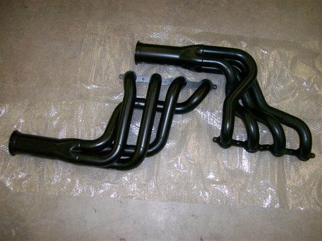

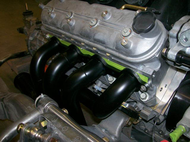

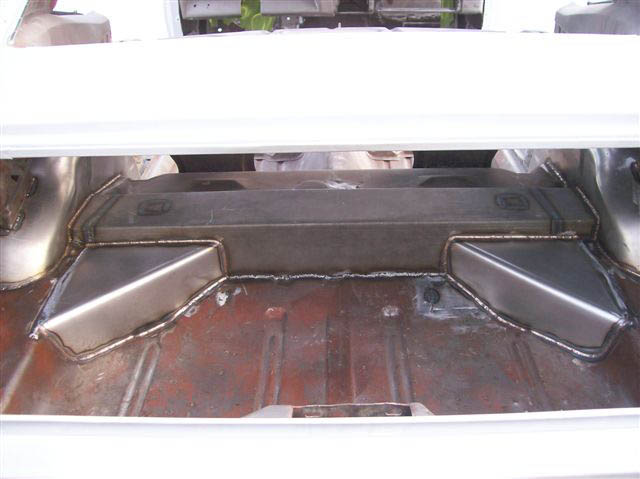

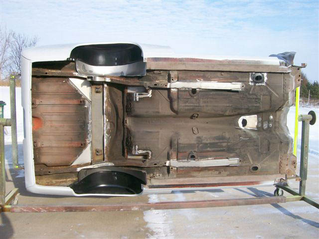

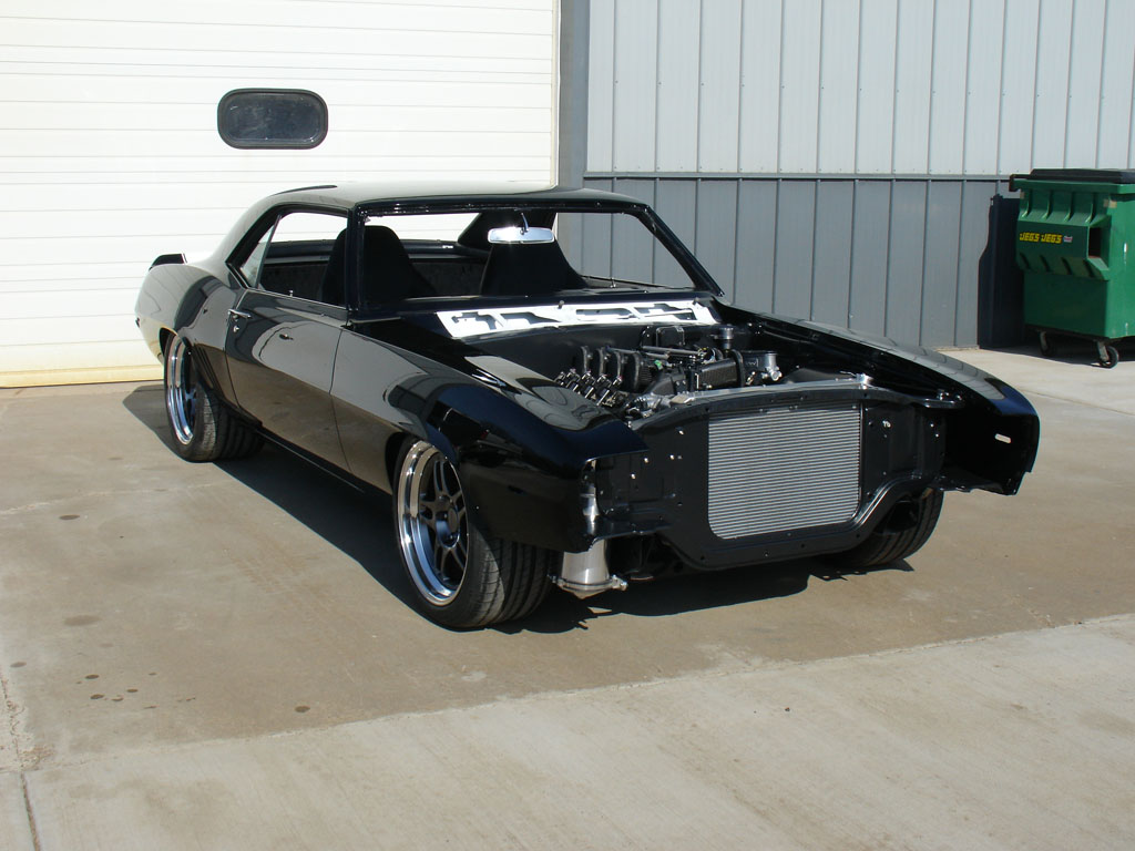

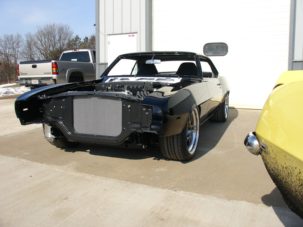

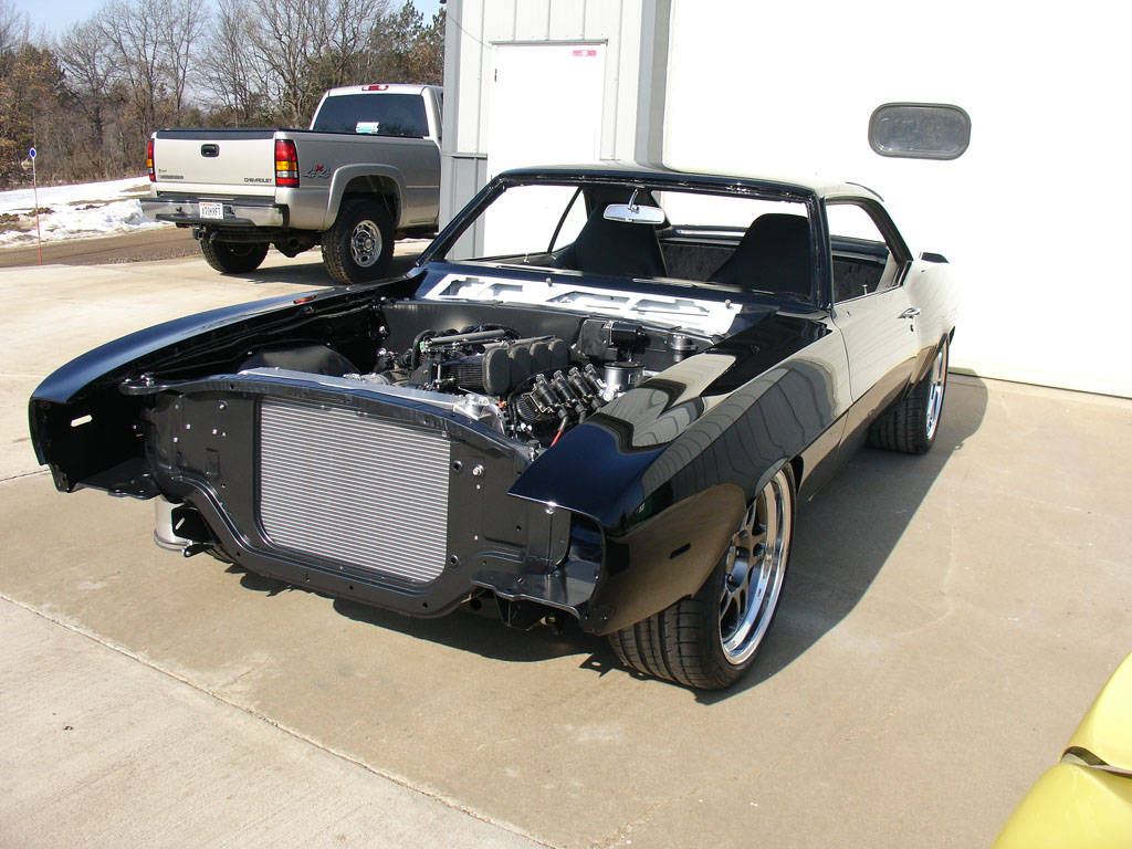

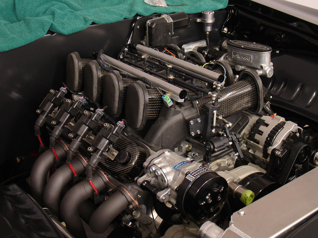

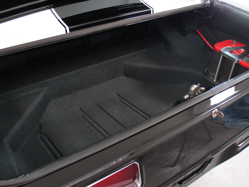

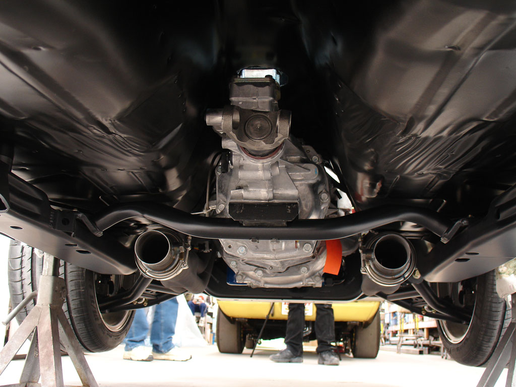

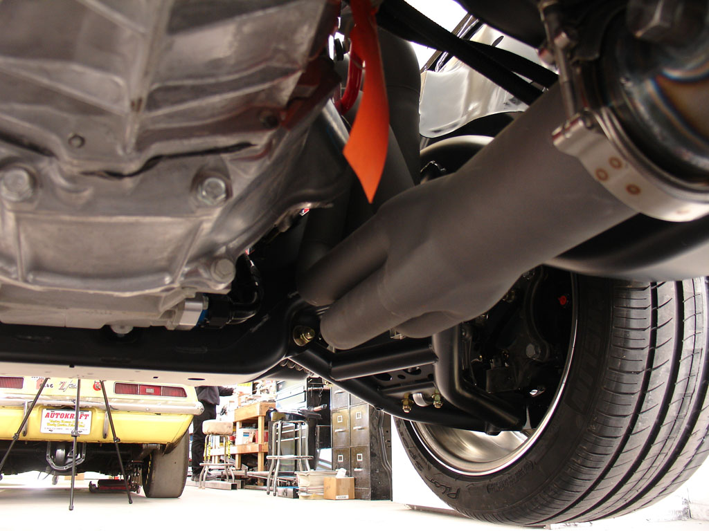

Kurt cut in the Stielow inspired trunk floor recesses and the bottom of the car gets media blasted on Monday, then it's full speed ahead with paint!
The Lemons headers fit great - even with the 2" primaries.
My LS7 69 Camaro

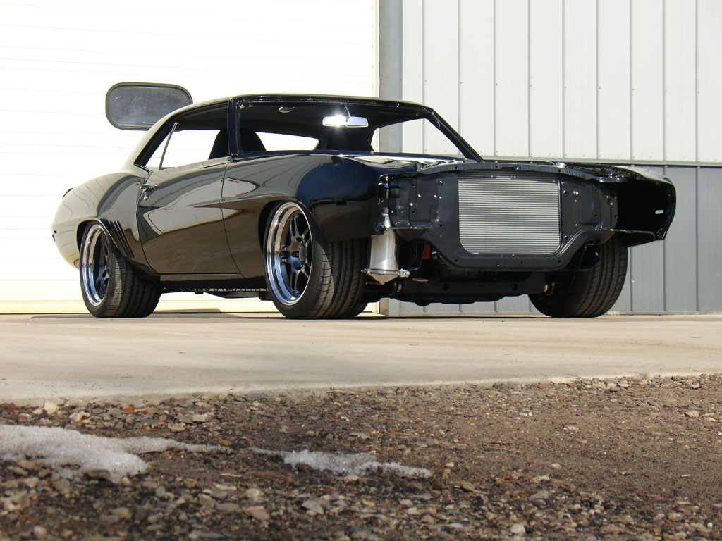

How low do the headers hang below the frame rail?
Tony
'68 Camaro
  #39
Old 12-20-2008, 02:01 PM
XcYZ's Avatar
XcYZ XcYZ is offline
Join Date: Jun 2004
Posts: 8,998
According to Kurt, they don't hang down at all.

Well you can't beat that! That's a great option for the LS guys....and gals!
