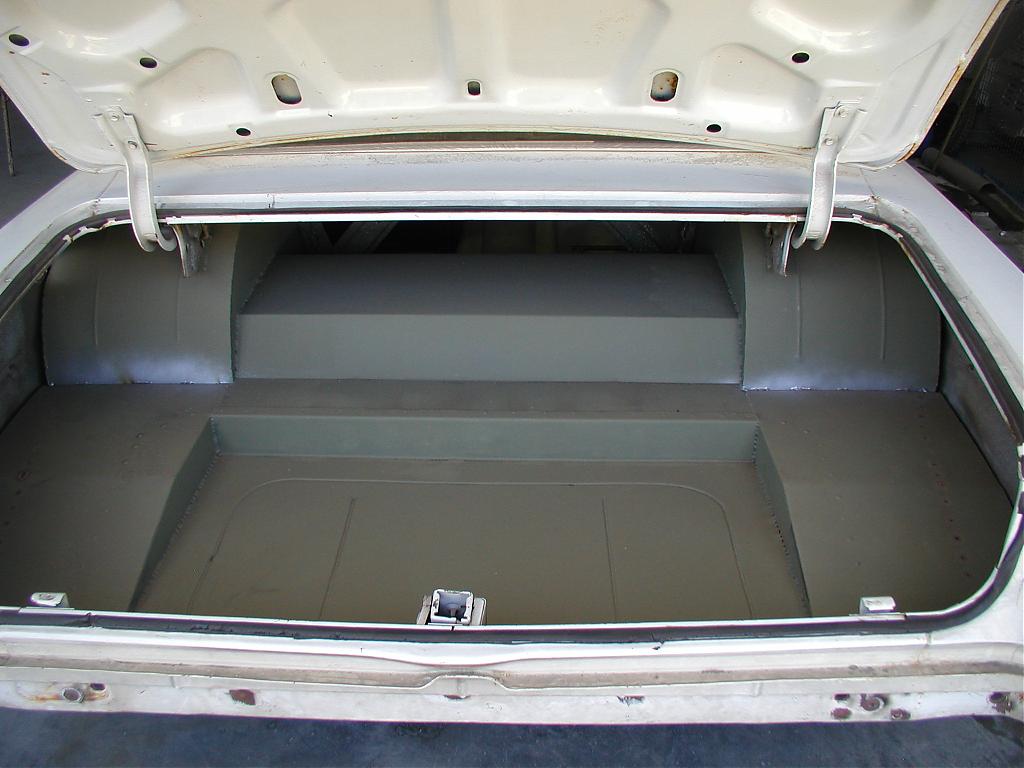

Good to see that you finally got someone to start on the floor panels and trunk. Any idea when I will be able to go by and see your car? Call me.

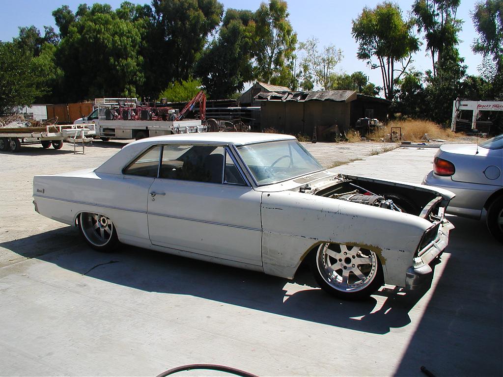

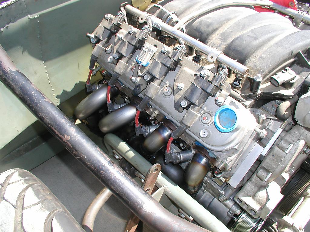

Old 08-06-2008, 08:36 AM
Sinco Sinco is offline
Location: La Habra Hts. CA
Posts: 122

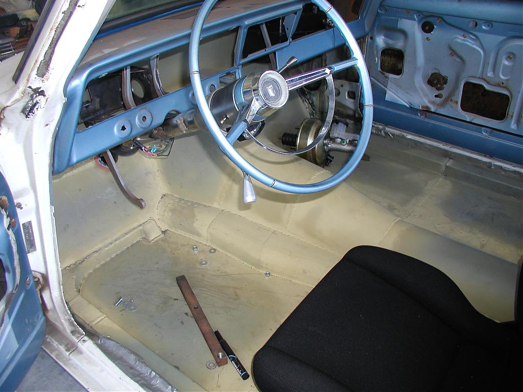

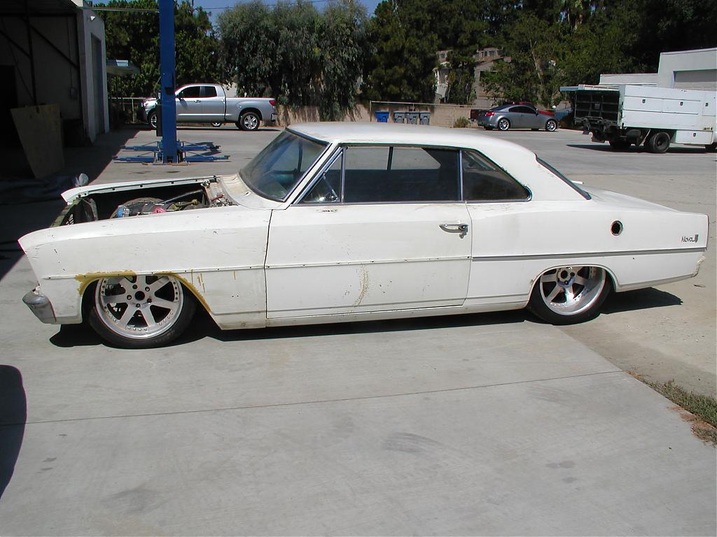

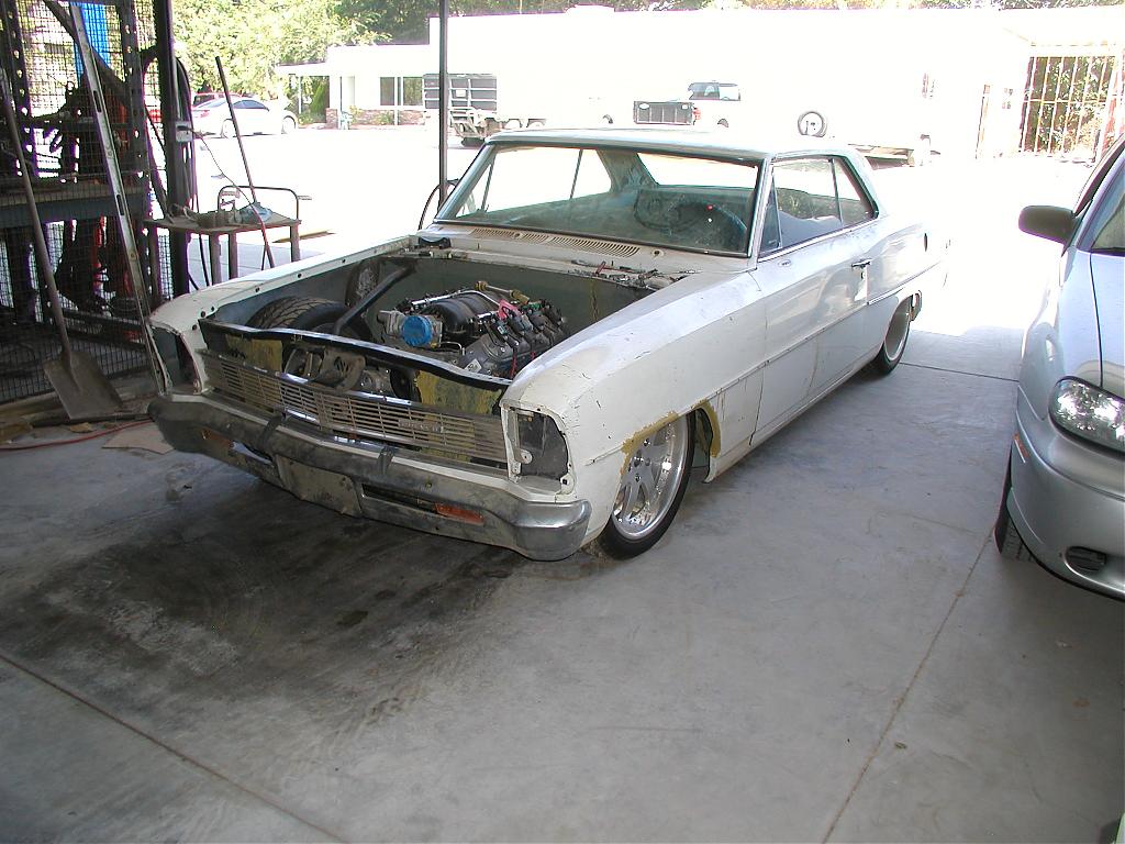

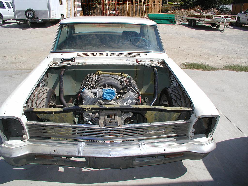

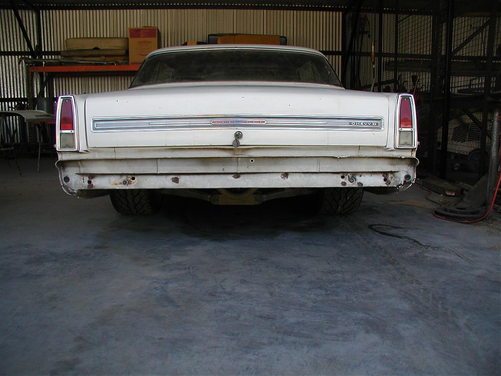

Well it's been a while but we have made some progress. Just to get up to speed I had Wayne Due build me a frame for the car. As it turned out it had many problems. We had to redo fabrication on the rear end just to get the third member out of the car. I don't know what Wayne was thinking?? Also the expensive shocks he out in won't work unless I want the car to look like a stink bug. Wayne suggested a cobra r rear end which worked but my fabricator had to search high and low to get axles made.
As far as the front end all that was wrong too. Caster and camber was all wrong so we had to fabricate new upper control arms and lay back the mounts. With that all fixed you can see the progress in the pictures. We are ordering a radiator and need to decide on which fuel injection to go with.
Doug
