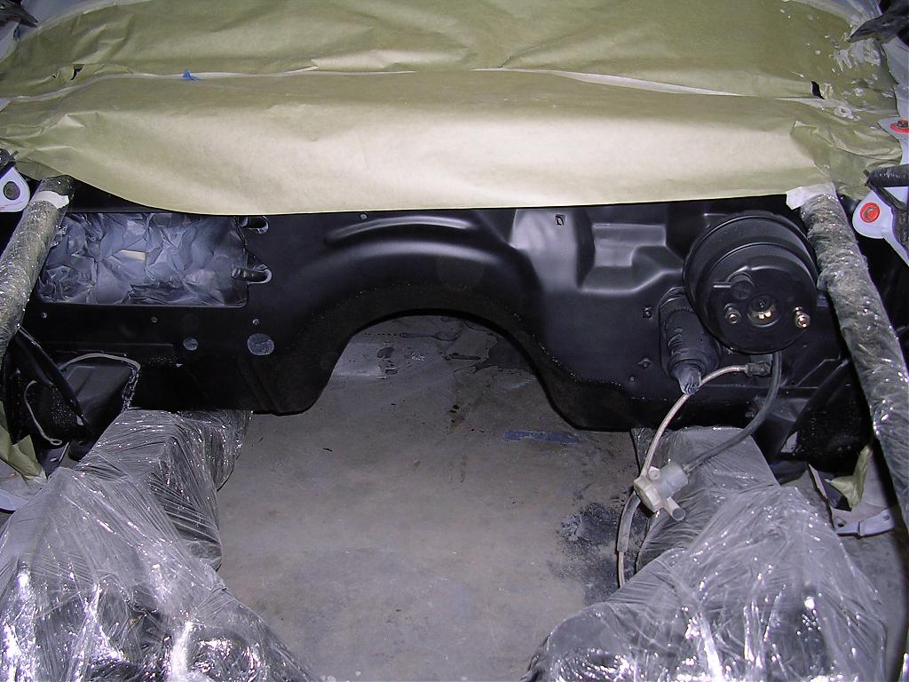

What color black is that under the hood?
  #34
Old 09-24-2008, 10:00 PM
BRETT ANDERSON BRETT ANDERSON is offline
Join Date: Mar 2008
Posts: 58
Default Cread01 underhood paint
I used SEM spray on bedliner. I smoothed the underside to paint, then changed my mind. I want the car to be low maintenance so I sprayed it with bedliner. Very easy to keep clean!
  #35
Old 09-25-2008, 12:03 AM
Cread01 Cread01 is offline
Join Date: Aug 2006
Posts: 197
i'm sorry I didn't say that very well. I meant what color black on the inner fennders and radiator support.

Default Inner fenders and radiator support

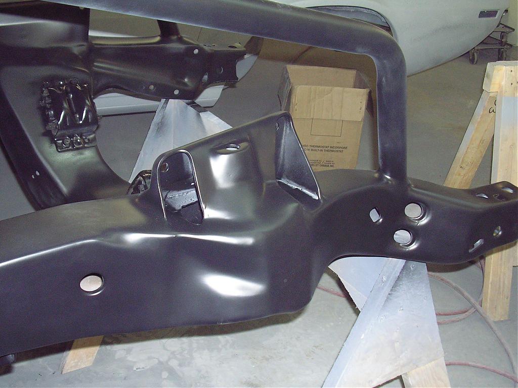

The inner fenders are semi flat black. Very easy to touch up and pretty durable too. The radiator support I made is just PPG black base coat/ clear coat. I tried to make it look like a factory install. So most people don't realize that the firewall has been smoothed and I plug welded and smoothed all the holes in the inner fender wells. The best part is that most people don't see that I welded and smoothed the subframe and moved the front shock mounts up 1 3/4" so the car could sit lower and still have a full length shock under it. That took forever.
  #40
Old 09-25-2008, 09:44 PM
Nice job on the sub frame and fire wall.
