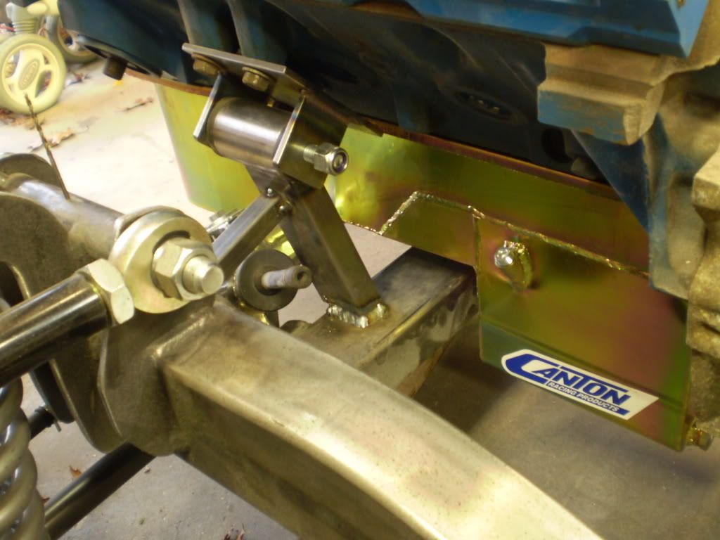

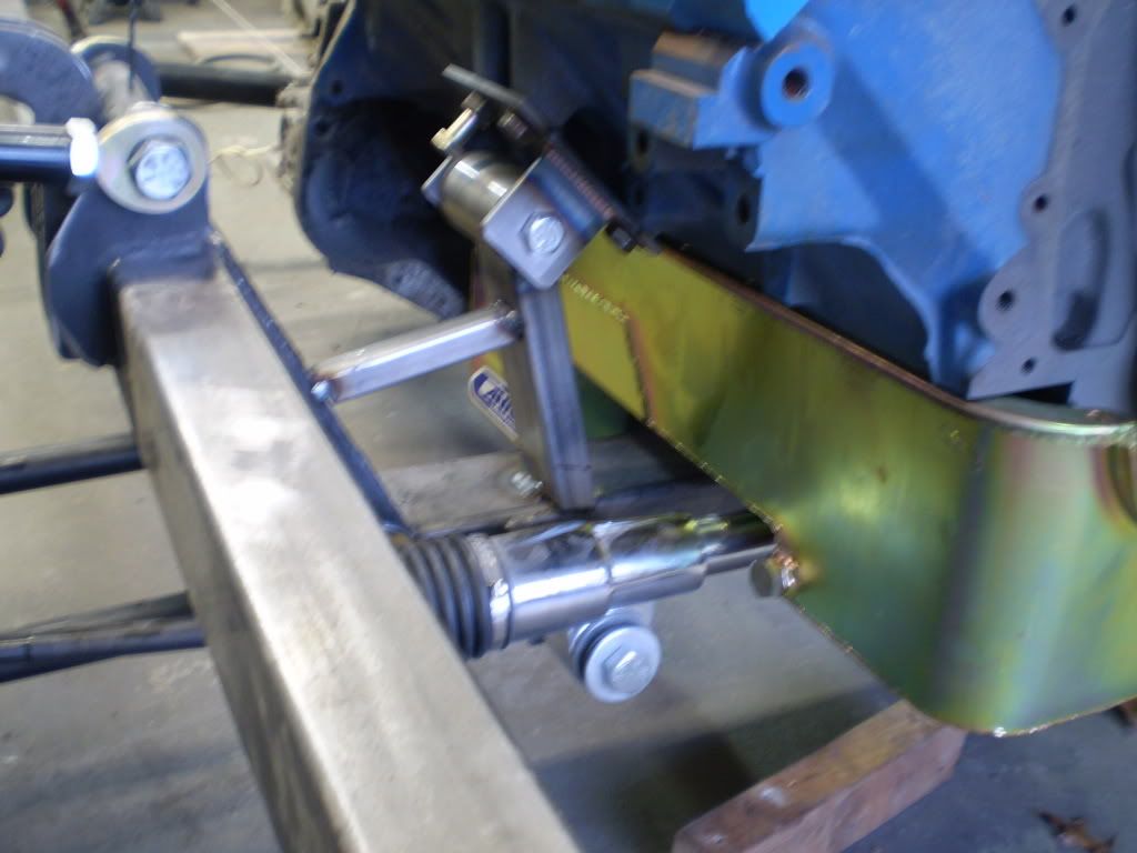

progress report for the week 11/16/08 after being away for a week i was glad to get back to work on the car for me its therapeutic so this weekend i worked on motor mounts and a tranny mount..the motor is where it will stay and so is the tranny ,here are some pics
R/H mount
L/H mount
Plenty of room for the steering

Is that the final design on the mount? Any shots of the trans mount?
