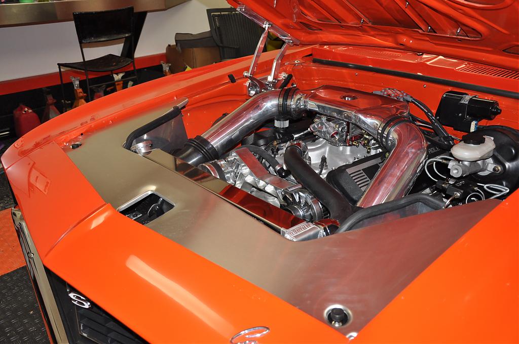

Thanks for your input and pointing that out. I will have to look at some pictures of grills and check them out with paint. I may end up painting it. The old grill was black so i did this one the same. I put my Spector air intake on with a DSE close out panel today.

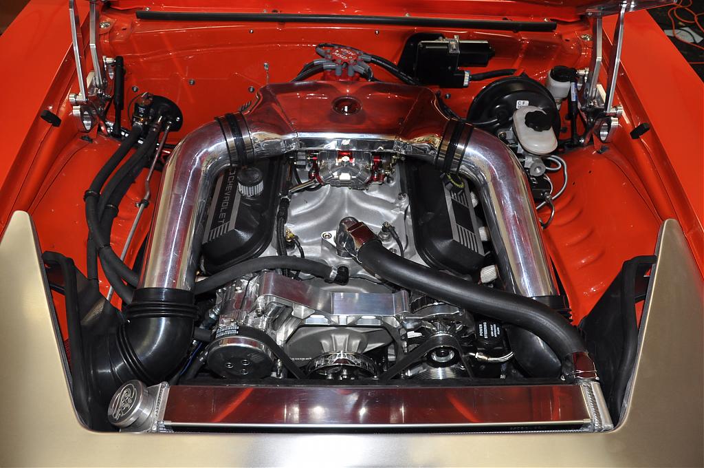

Couple of questions - what upper radiator hose coupler are you using? I also have the Be Cool rad and am looking for something clean that works with the squished restricted outlet.
Also, what master cylinder is that?

The upper rad hose ends are Speed by Spector with a regular rubber hose. The master cylinder is out of a 1998 Firebird. I had to make minor modifications to the firewall bracket and the brake pedal rod to make it work. It was not hard to do at all. The feel of the pedal is awesome.

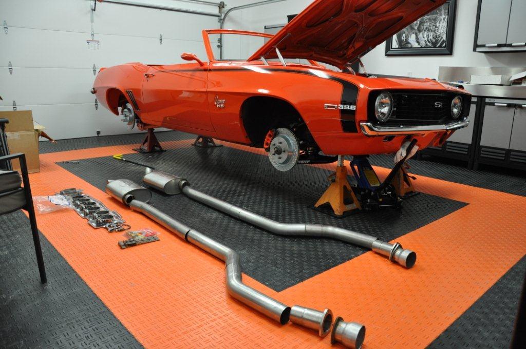

The exhaust is by Stainless Works from the headers on back. 3 inch tube. Sounds very nice in my opinion. Not too loud.
