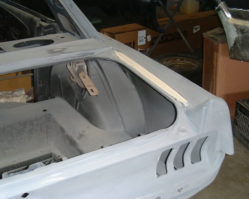

I finished block sanding the deck lid trying to get it to match the quarters than epoxy primed
Sprayed SPI Turbo primer

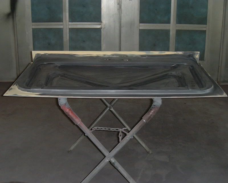

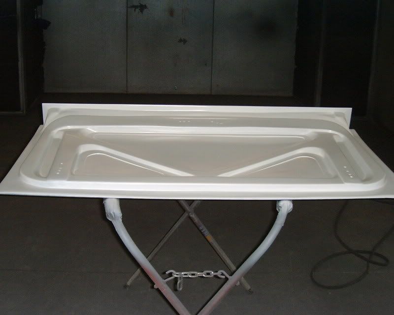

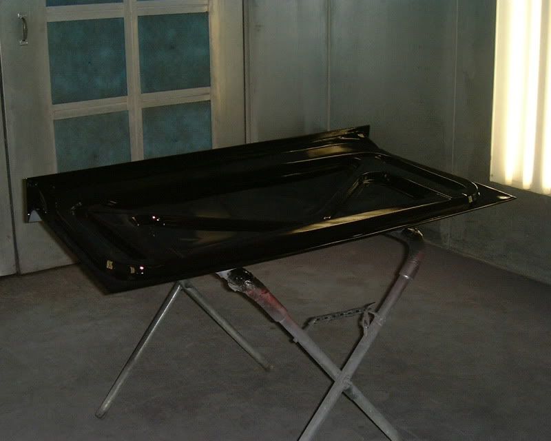

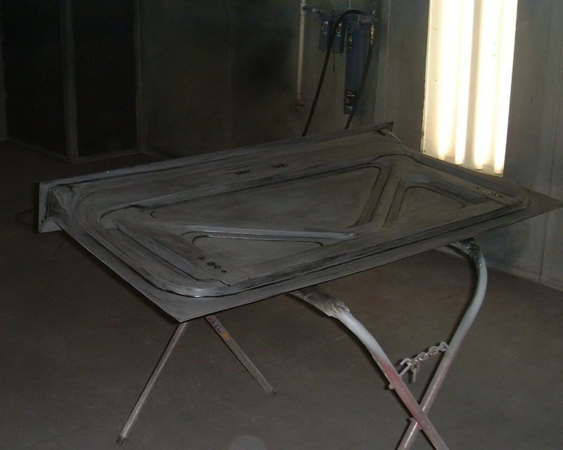

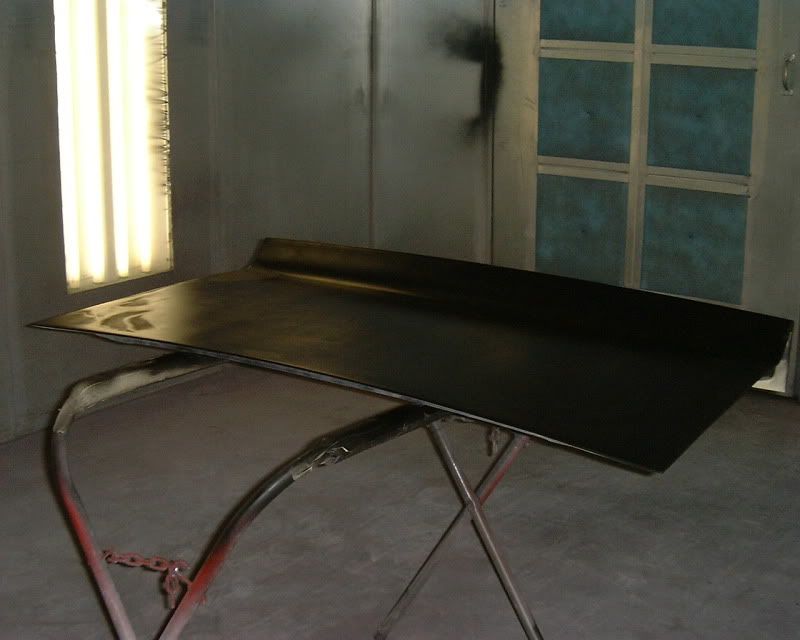

I spend most of the day working on something that you don't see 95% of the time the back of the deck lid.
I finished sanding and than epoxy primed

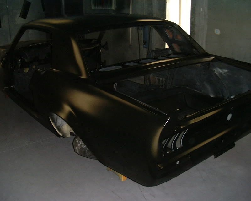

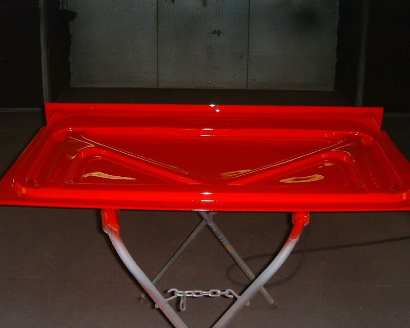

Today I sanded the deck lid than sprayed a coat of SPI white epoxy
I waited a couple of hours than sprayed 3 coats of SPI single stage red.

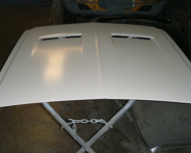

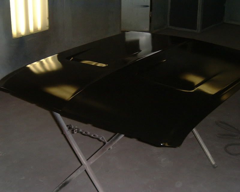

I was not happy with the hood after block sanding. I added a little filler than epoxy primed again.

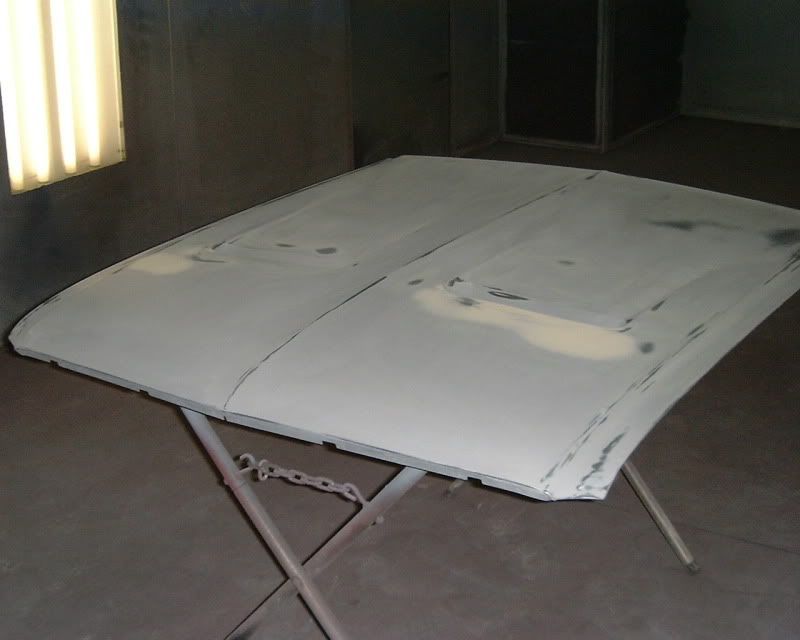

I block sanded the hood again and epoxy primed white next I need to sand and paint the back side of the hood.

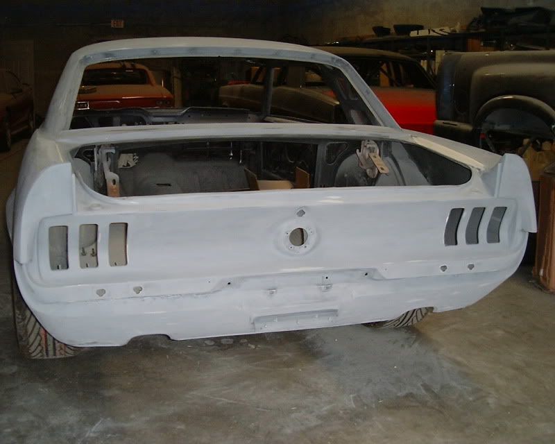

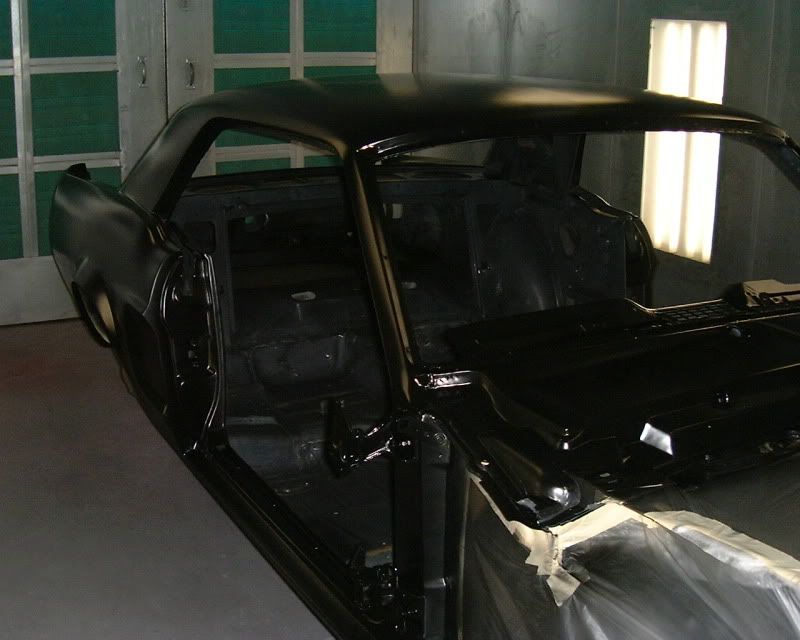

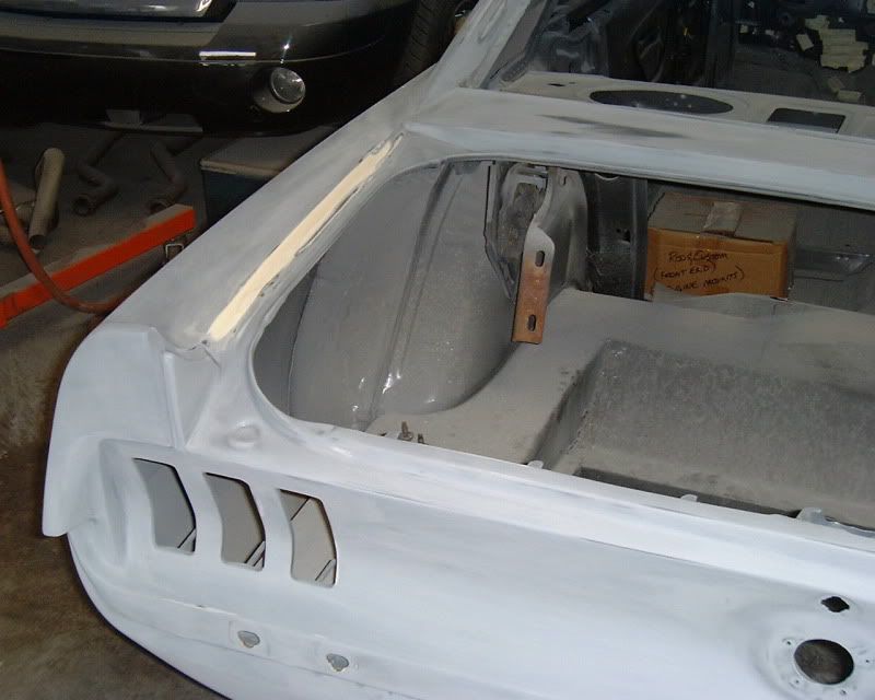

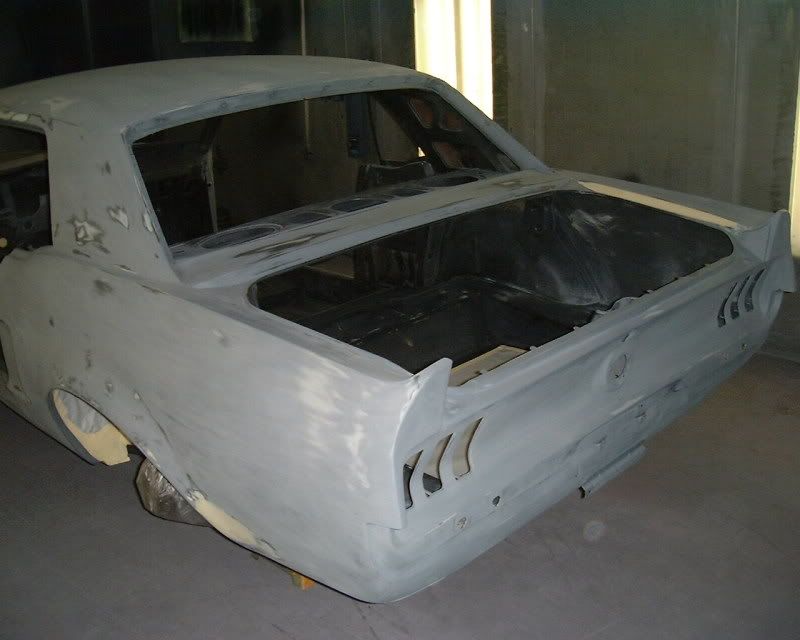

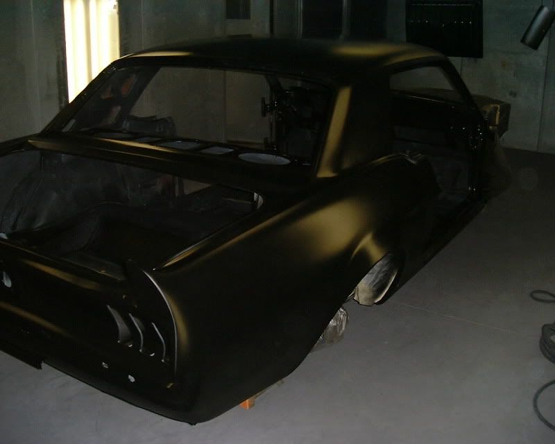

It has been awhile since I got to work on the 68 so today I decided to add a little filler to each quarter to tighten the gap on the fiberglass deck lid and I block sanded the roof and taillight panel.

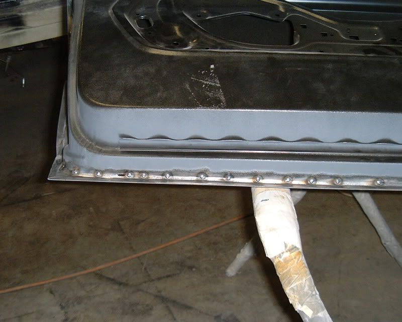

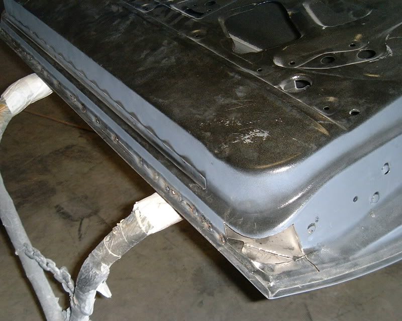

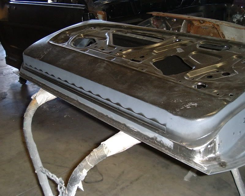

We had a problem with the drivers door sticking out 1/4" at the bottom even after elongating the holes in the hinge. We cut 1/4" out of the bottom of the door.
Brian had to cut out a section to get at the inner brace to cut it. After the brace was welded he brushed some epoxy primer than welded back in the piece he cut out.

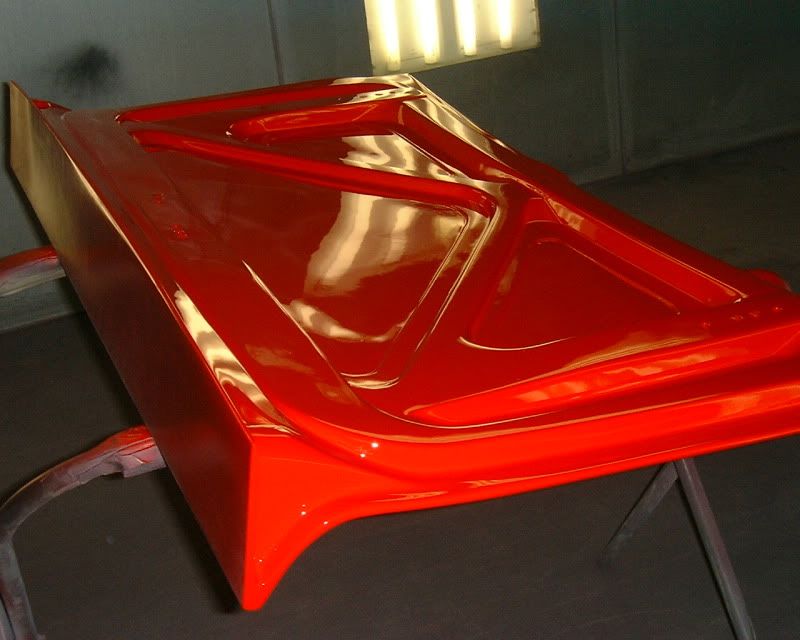

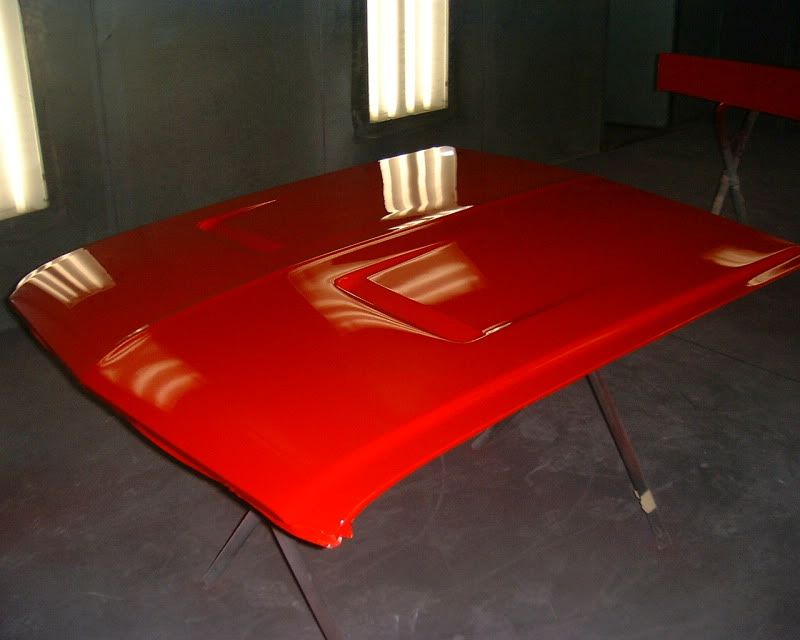

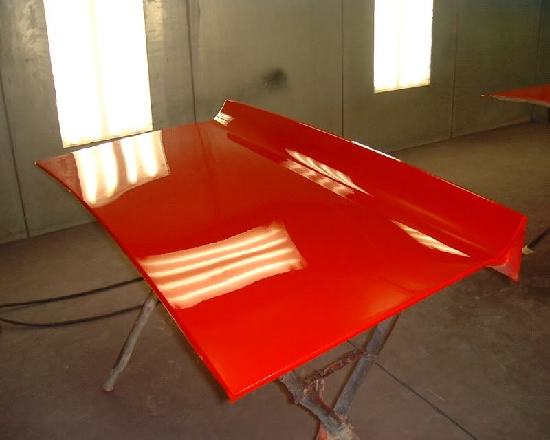

I sprayed SPI Red yesterday on the hood and deck lid and the clear today. I will wet sand and than spray 3 more coats of SPI Universal clear.

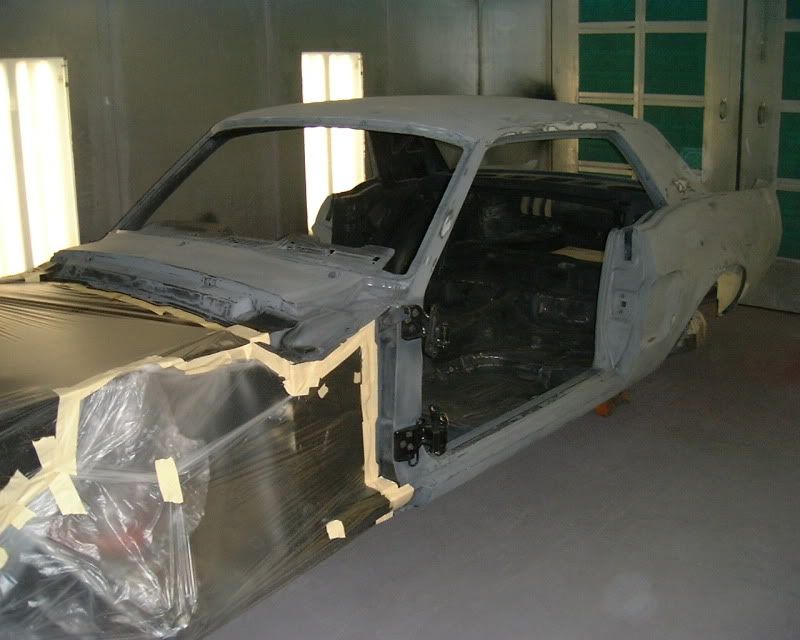

Ready for 2 coats of epoxy primer
