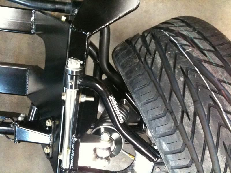

finished the suspension last night and wanted to show the clearance of the Speedtech frame with a 18x9 on a 275
you can see that the arms and sway bar are designed for clearance

Did you test fit these wheels/tires with the front sheet metal installed? I have 3/8" less bs than you. Obviously frame clearance won't be an issue...but the fender might be a problem. Just wondering what the clearance was like on yours.
wheels just showed up...but Roger said it should be more than enough
