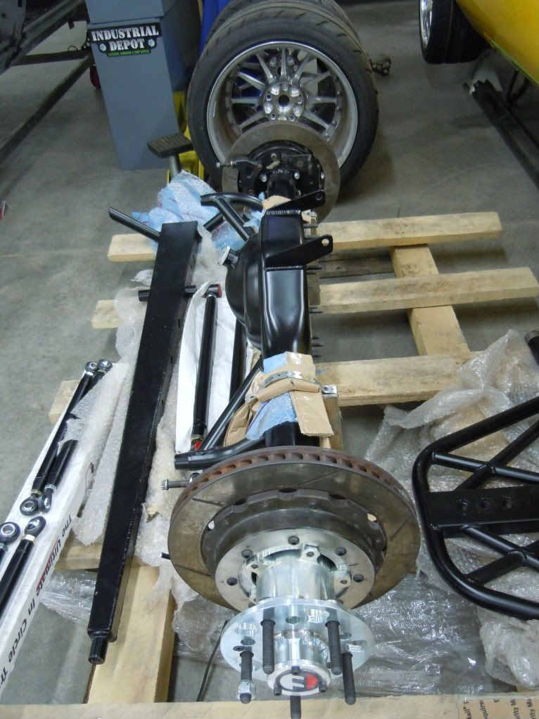

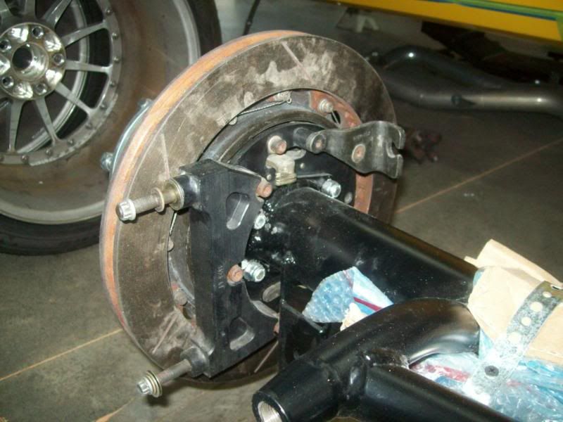

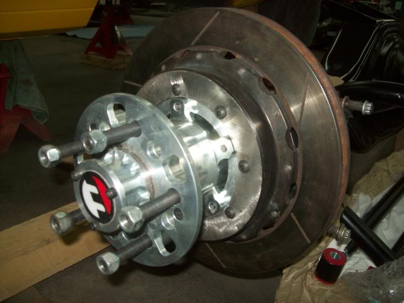

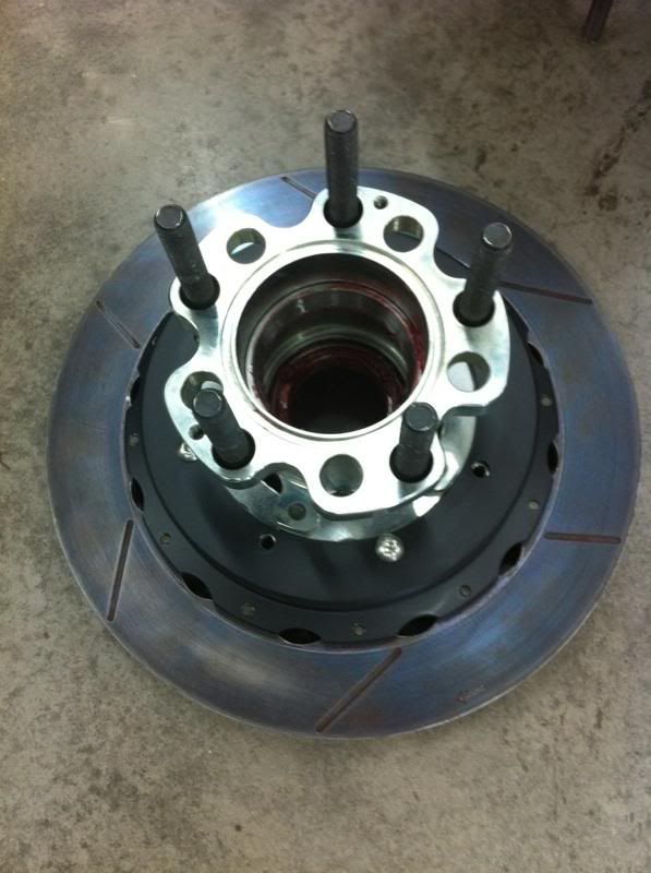

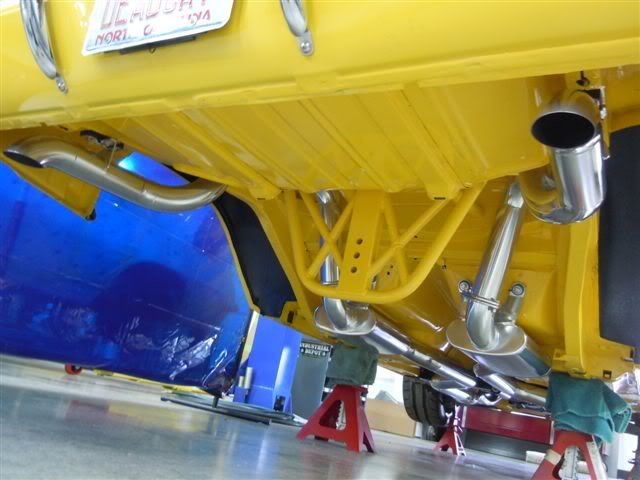

Everybody knows about the pad knockback problems when you really start leaning on a 9 inch with fixed calipers and sealed bearings. Since I was upgrading the rear suspension and was going to need to shorten my present 9 inch, I opted to kill 2 birds with one stone and sprang for a full floater from Moser. I got the DB floater (dual bolt pattern 5x4.75 and 4.5) The center register on that rear is the standard Ford 3.06. I had Moser turn it down to 2.78 (standard Chey) so my wheels would fit.
My next challenge was that I wanted to keep an emergency brake. Jake and I discussed it and came up with the idea to use my existing intergrated emergency brake used with my Wilwoods and make a mount to bolt the assembly on the housing. Jake then machined my existing hats to mount to the floater hub. Very easy retro-fit, but it will not work with a high negative offset wheel. It worked on mine because my rim has around 8 inches of backspacing. Plenty of room for the brakes and not get into trailing arm brackets or shocks.
Another way to solve the e-brake issue is to have a custom rotor adaptor made if you are running a 13 inch or larger rotor, and use a seperate caliper.

Default Pics

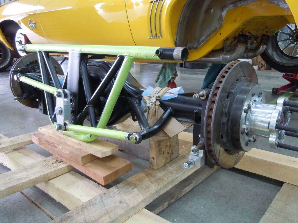

Default Time to unpack Jake's Torque Arm and do a quick
pre-assembly.
