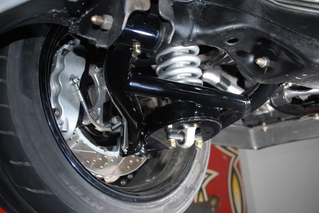

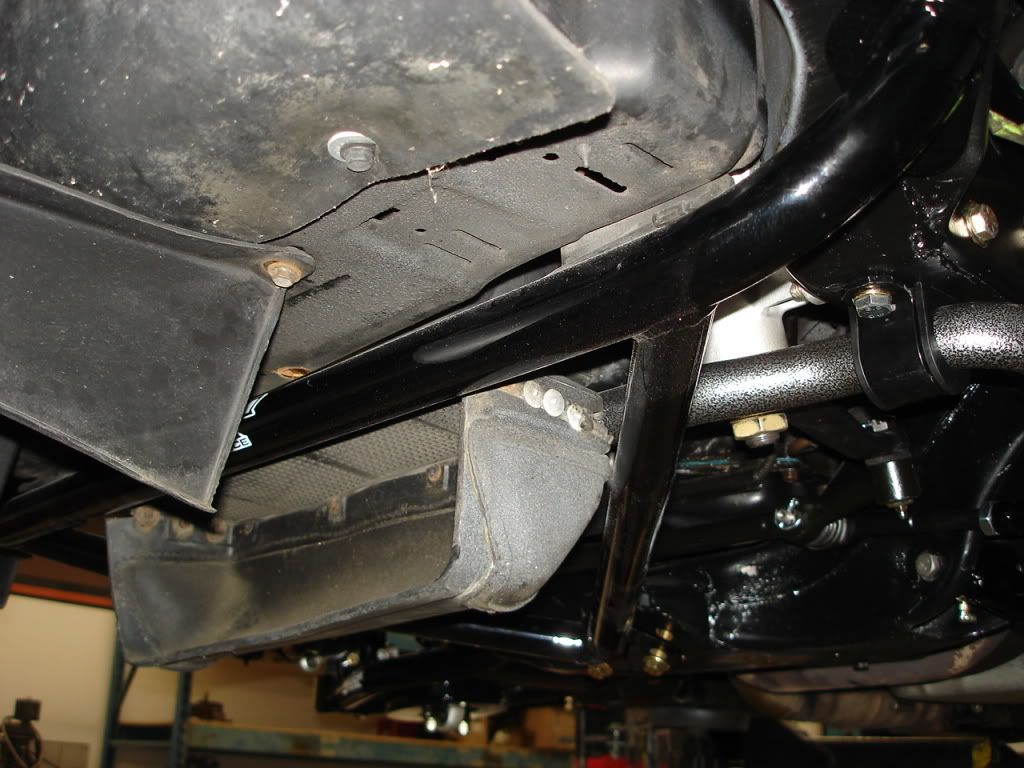

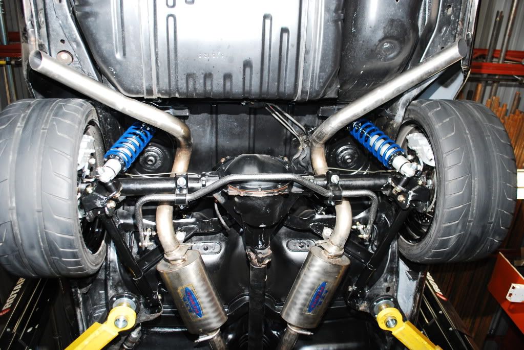

Sorry the pics are not Catalog quality.
here are a couple of the rear. the package includes the Trailing arms with Articulink joints, delrin busoings adjustable uppers and lowers with adjustment for antisquat and instant center. the coilovers are Ridetechs this set are the non adjustable ones that we are testing out. Protouring adjustable sway bar as well.
And some of the front. this package uses the Speedtech new Tubular arms AFX Spindles, and ridetech coilovers, as well we have done a front chassis/steering box brace. The new Protouring hiclearance sway bar.
Any Questions let me know

Blake how would that triangle brace fit with a stretch intercooler? i have the DSE one and they interfere with the ic.

i will guess that it will also not fit, there are so many different combos you can really only make them for the original set up, A buddy of mine also has a GN with an aftermarket intercooler and our chassis brace won't fit his,
you would probably have to have one cusom made.
