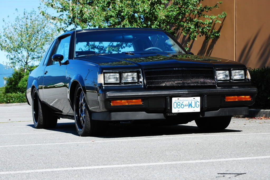

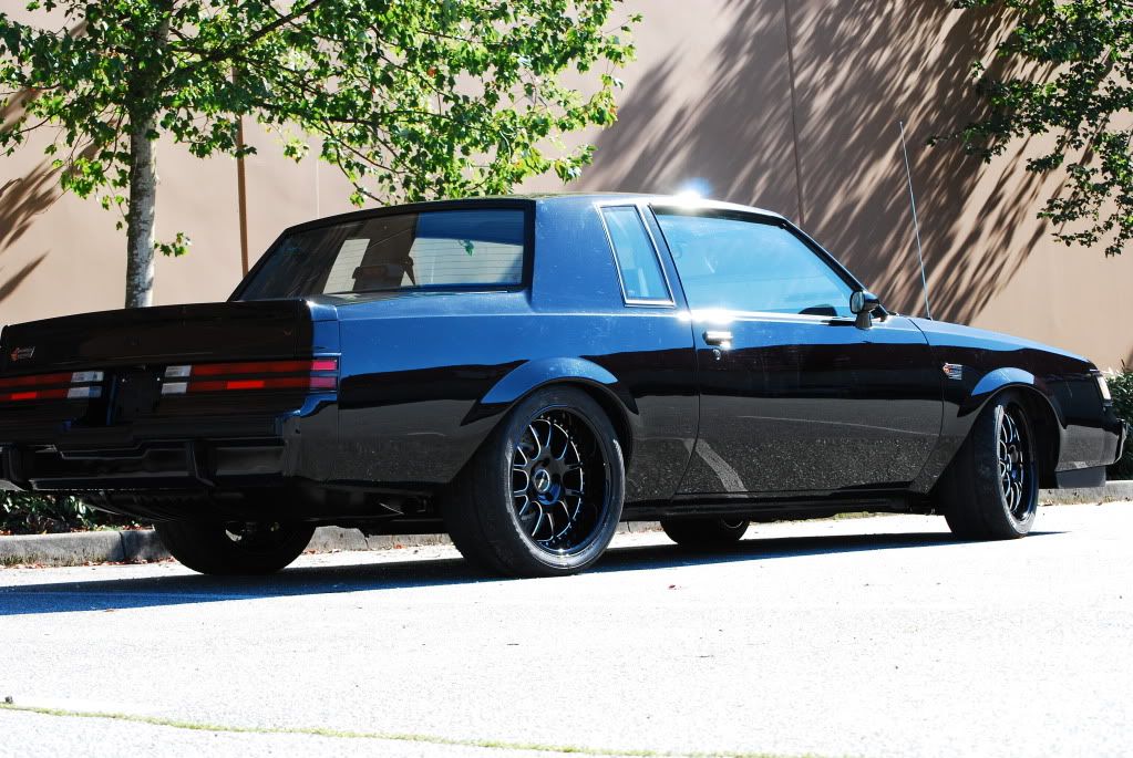

Well here it is.
Front includes
AFX spindles, upper and lower tubular arms, Ridetech coil overs 1.25" sway bar and front chassis brace lee steering box. wheels are 18 x 9 up with 275 35's
Rear includes
Articulink Trailing arms Ridetech coil overs 3/4 adjustable sway bar
rears are 18 x 9.5 with 295's
still room to lower another 1/2 to 3/4 if wanted.

yea I agree I have Always wanted one, this one was a total stocker other than a downpipe, exhaust and a chip when i got it, not planning on doing anthing to the motor except to make it run well, i added a boost controler 43 lb injectors and a turbo tweek chip, THAT's ALL I'M DOING
but the suspension is now done and we can put all the parts into production. some already are but not all of them.
