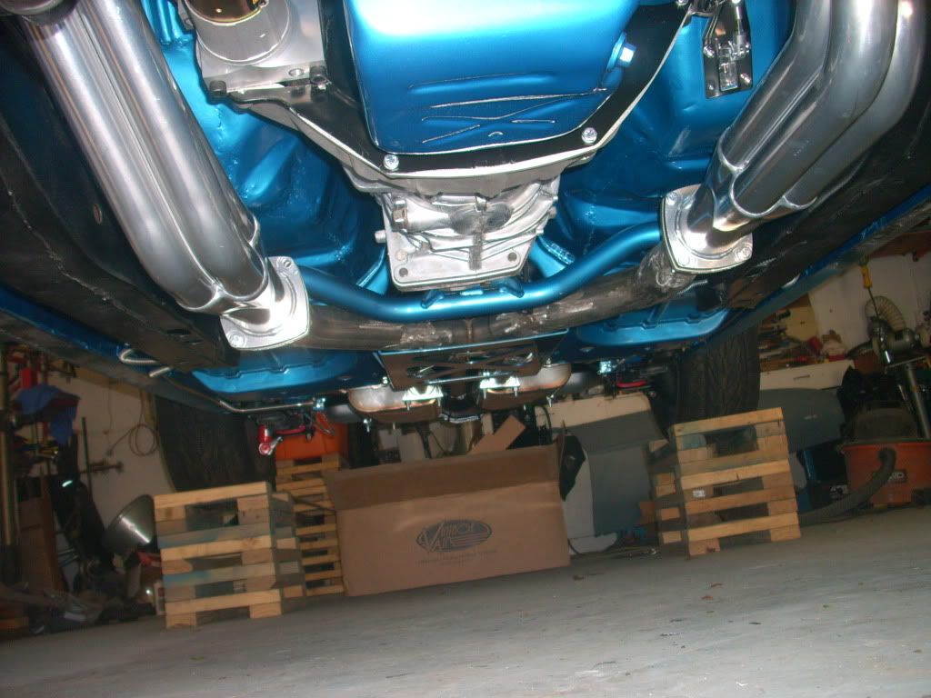

Originally Posted by OOCustoms View Post
Awesome to see that your sticking with the side pipes. Years ago when I started building my 74 nova and I bought a set of full header side pipes like the ones your converting to. Although that project never went much farther and life got in the way, I cant wait to finish it one day and still incorporate the side pipes I have for it. Its the only 70-80s muscle car style I still love. I do want to possibly recess them into the rockers and raise them to adapt to the pro touring style. I cant wait to see yours complete with those pipes. Its gonna sound wicked! are you gonna run slip in mufflers? how bout some spark plugs in the tips to shoot flames???? LOL
The slip in mufflers that came with the old Hooker sidepipes are really restrictive. I'm thinking of trying the spiral inserts. http://www.spiralturbobaffles.com/

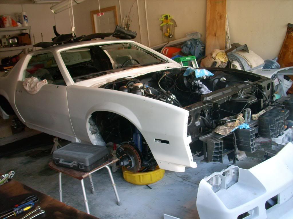

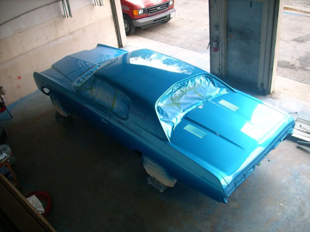

I've been working on it but customers cars come first (travelling car builder) and then when I get home it's tough to get motivated to work on my own car ahahaha. I'll post some more updates of things and bring the thread up to where I am now. A few of others projects I've been building came to a point where my services aren't needed much and I've got a little free time so I'm working on my own car more this week.
Here's a few of the current builds I've got to a point where I get a break while the cars go to paint or interior shops etc. I work on a lot of donk/box/bubble big wheel cars but here's a few pics of builds I like more.
69 Camaro full resto-stripped to unibody PT car ZZ383 , Tremec 5 speed, 12 bolt, DSE stage 3, Vintage air, AAW, Wilwood, etc. Owner did the bodywork and some other things while I did mechanical/electrical/plumbing etc. It's been a little over a year since we started. Time for paint!
89 IROC clone. Just finished up driveline install and it's off to paint.
71 Impala cruiser. Just finished installing all the replated exterior chrome and it's headed for interior.
