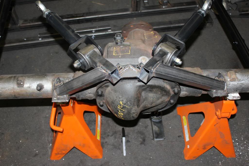

Our first prototype 8.8 Ford rear for the A-body. We'll cap off the upper control arm mounts before paint. We are going to use round tube on the production units, and we'll have a long list of options. Sabre's will be getting a cast aluminum girdle-type cover.

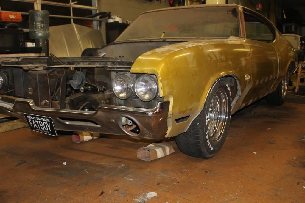

Before the body was stripped, and a mock up with the old wheels and tires to check the stance
Originally Posted by BulldawgMusclecars View Post
I love that its tucking the front tire, and the engine and trans aren't in the car yet!
Crossmember is a little low, but we aren't going to be jumping speedbumps in this car anyway.
Plenty of room for a nice meaty wheel and tire combo...I can get my fist in there with the 15x8 Cragars reinstalled.
I can still get two fingers in at the front
The 8.8 installed for the first time...fits like a glove!
